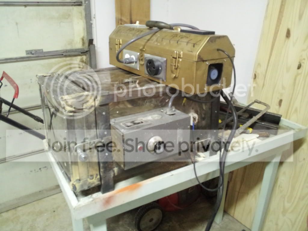

I built my oven for around $200 but that is only because I was able to get a Paragon pottery kiln for $20, a PID controller for $120, angle iron/misc parts for $60.
The shell, elements, element connectors, and heat sync all came off the Paragon
With some cutting and patience, it became this:
There's no doubt that she's ugly as sin. Certainly not up to the standards of other home built jobs, but it works great for me!
