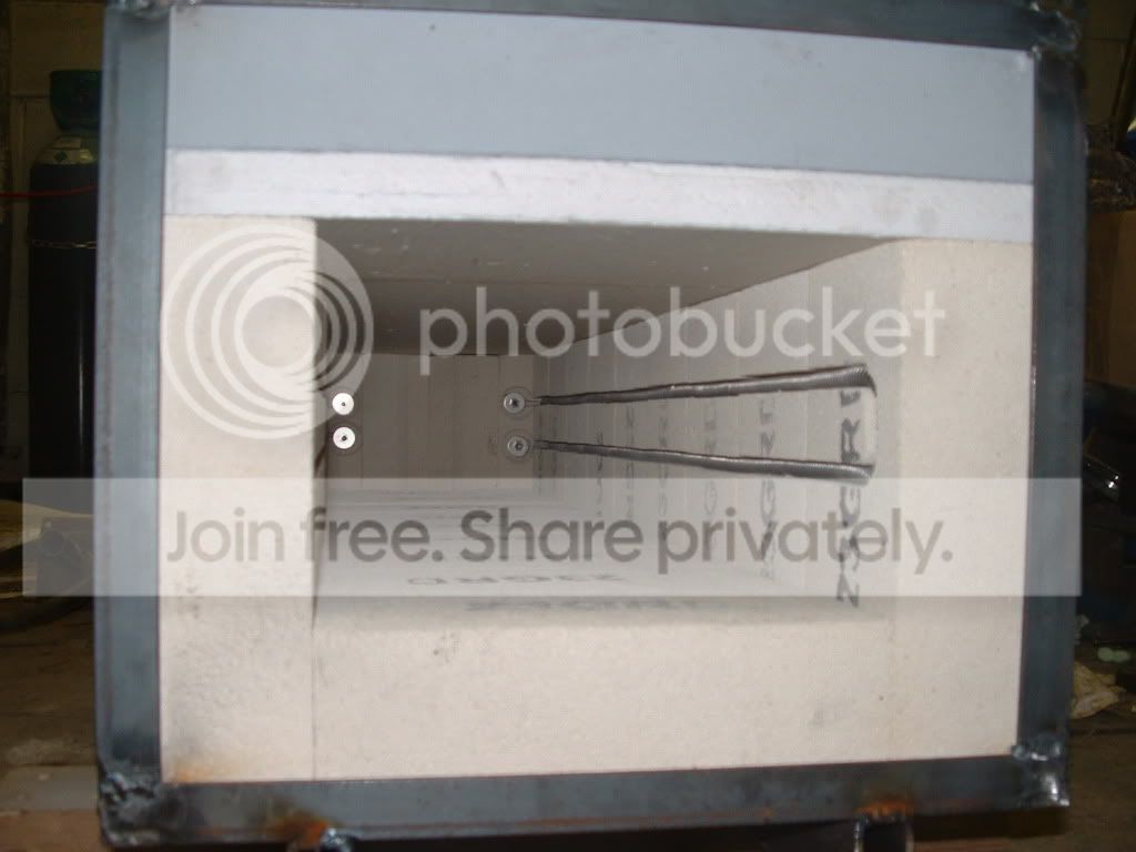

Ok, I have a preliminary plan and parts list that I would like advice on. Here is the list!
Interior Chamber Size: 9”w x 5 ½”h x 22 ½”d.
Frame: Welded Steel Angle 1/8 x 1 ½.
Exterior: 1/8 alum diamond plate, place 10-24NC sstl pan head screws to miss upsets.
Bricks: K23 soft firebrick 9” x 4 ½ x 2 ½ wt= 2 ¼# ea.
Door: Angle frame with adjustable hinge and welded inside Gr8 bolts (nuts to outside).
Latch: Cam locking adjustable type with refractory rope door gasket glued into groove.
Feet: Extended side vertical angles with foot levelers.
Elements: BCS Kanthal #7101 x 2 $49 120vac each x 13A.
Connection wire: BCS High Temp AWG12 x 6ft $24.99.
Connection: Micarta block located on bottom of oven with SStl 10-24NC screws. Use extension handibox with blank cover (no bottom on handibox).
PID Controller: Auber #SYL-2352P $78.95 for SSR output and soak feature
SSR: (2) Auber #MGR-1D4825 25A capacity with exterior heat sink.
Thermocouple: Auber #TC-K-KLN $27.75 2300deg F.
Finish: Black heat paint on steel angles.
Cooling: Possible cooling fan on PID and SSR’s heat sinks.
Thoughts? Red flags?
If you can find it in your budget to get some Kaowool (sp) to help insulate the brick from the exterior plate this will do two things keep the heat inside and keep the aluminum cool in case you bump it with your arm. If you plan to attach the PID to the side of the unit use angle iron and allow a little air flow between the exterior of both units. I don't think you will need the cooling fan you make the call. I have been using my DIY Furnace for 10 years without one and seems to be fine (I did tear down the exterior of the chamber to wrap the bricks with the Kaowool blanket). Get a tube of High Temperature Fireplace Caulking to seal your brick joints. One note I made my unit so I could easily remove the Top Bricks to access the interior to replace the Kanthal elements should they fail. Were you wiring this 120v or 220v....If you can access 220v Do It cuts the Ramp time to near nothing!!!!

When I built the first one, I wasn't sure how hot the surface would get, so built the frame, fitted the bricks and fully intended to clad the outside with either plastic-coated steel, aluminium sheet or stainless steel sheet, once I'd measured the surface temperature and knew what would be most appropriate. Using a type K surface thermocouple, I measured 129 degC (264 degF) at the outer surface of the bricks after several hours at 1177 degC (2150 degF).
It seemed pretty clear that cladding would look nicer, but would probably be less safe than leaving the brick surface exposed.
I borrowed an infra-red camera from work and used it to measure the surface temperature at 136 degC with the oven in use. I could press my hand against the brick surface for a reasonable period of time (tens of seconds) without harm or serious pain. When I took my hand off, the cooler handprint was clearly visible with the IR camera for some tens of seconds.
The surface temperature was obviously too high to allow the cheap option of plastic-coated steel. Aluminium looked like it would be fine, but it was pretty clear that brief contact with a metallic surface at something in the region of 250 degF would be significantly more dangerous than contact with the IFB at a similar temperature,
I actually did the math for putting a thin layer of kaowool between the bricks and a skin, and there was very little change in the calculated surface temperature. Certainly not enough to justify the extra work.
Your plan is for a 9" wide chamber using 9" bricks?
It gets a lot easier if you reduce the width so that a 9" brick across the top is supported both ends. I usually go 7" wide, though you could probably get away with 8".
When I built a sword-length HT oven with a 42" long chamber, I went 9" wide and 6" high (9" x 4.5" x 3" IFBs) and used a layer of 1" ceramic fiber board (1260 degC/2300 degF rating) and 3" of Calcium Silicate board (1000 degC/1832 degF rating) for the roof. It made for a quick and easy build and I used the same construction for the door as I used for the roof.
I have always used 3" bricks, rather than 2 1/2". Once you've cut the element grooves, a 3" brick still gives maybe 2 1/2" of remaining wall thickness. With 2 1/2" bricks, it would be down to around 2".
I don't like the allthread-through-the-wall method of connecting the elements. I now use twisted Kanthal through the wall and connect to the elements on the outside.
