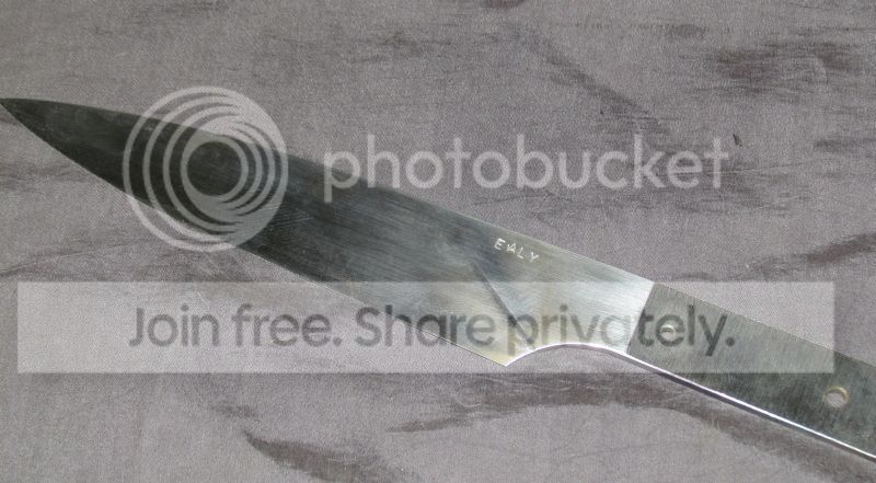

Here is a photo of the "sweeping" plunge I use on kitchen knives. The camera is aimed is directly at the edge after I pre-ground the bevels before HT. The stock is .125".

This is how Delbert Ealy does with his kitchen blades.

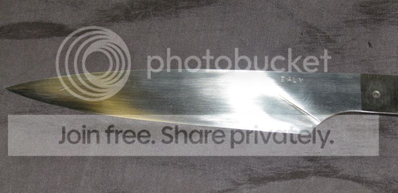

Update pic. This is hand rubbed to 400 and buffed I'm going to 500 then 600 then buff with white compound. Let me know what you think.
BTW The edge is ground to .002
