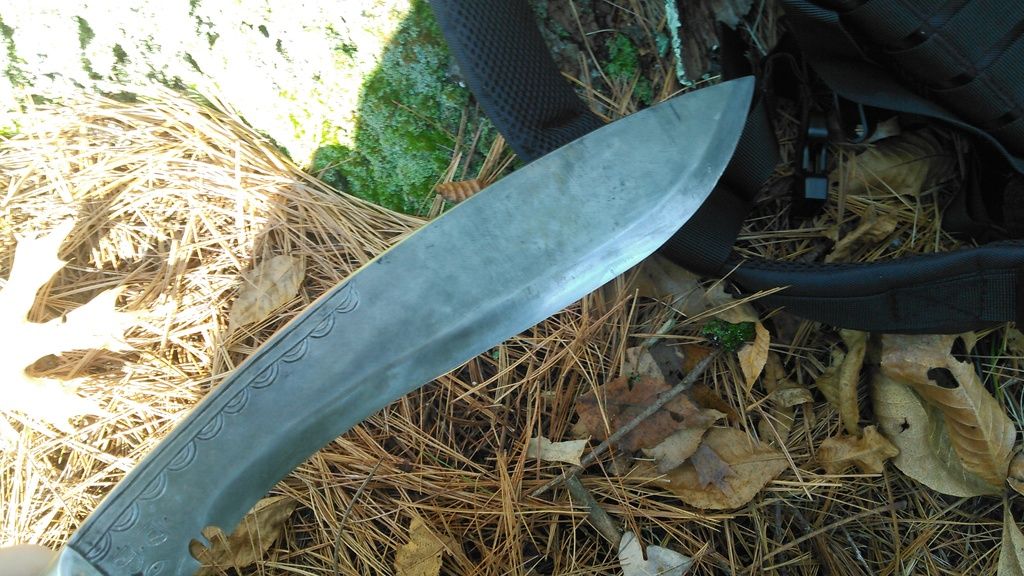

I second the apple cider vinegar. I've taken the forge scale off 3 of my blades so far. The first one I did with a grinder, and while shinier, it wasn't worth it... At all...
After that I did the vinegar, which gave the patina look that I love so much anyways. I used the technique outlined by Bawanna above. Here's the Tamang after some use.
