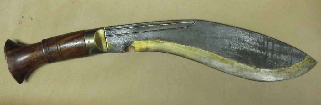

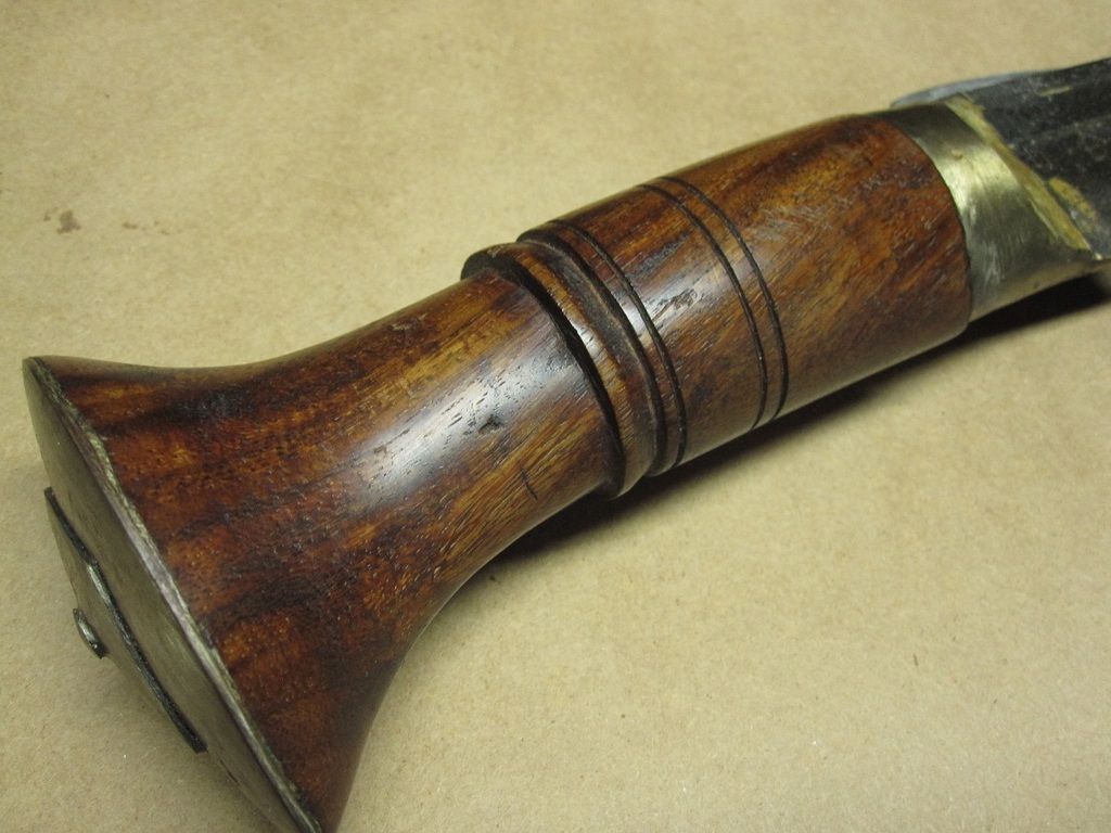

I mostly use pure tung oil to finish my handles. Sometimes I will start out mixing it with mineral spirits to thin it out for the first couple coats. The old standard is 1 coat a day for a week, followed by 1 coat a week for a month, followed by 1 coat a month for a year. If you make it that far I don't think it'll ever wear off. The stuff soaks into the wood and polymerizes while it dries, leaving a plastic-y/waxy finish behind that will seal things up nice and tight. On a couple of my heavy use blades I've also put several coats on the blades and it's helped a lot to keep the rust away. It cures to a dry waxy finish even on the metal. No slippery wetness that you'd get with some other oils.
I lost count of how many coats of tung oil are on this one. Water beads right off the wood.
The blade and bolster are well coated too.

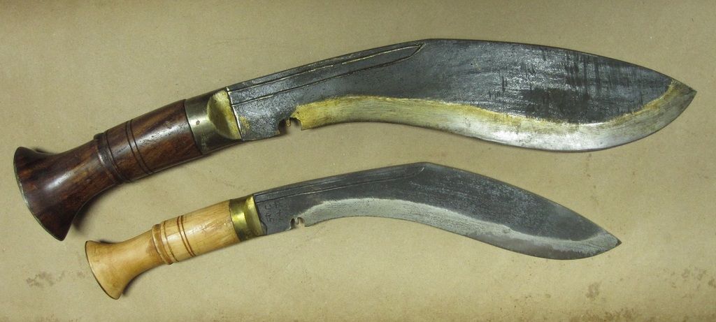

It's a big one! With 15" KLVUK for scale:
The KLVUK is in the earlier stages of tung oil coating.

Very cool! Make sure to get the 100% pure stuff if you can find it. A lot of "tung oil finish" you find in stores is actually a mix of all kinds of stuff. I use Hope's brand. I also recommend a good sanding for the handle before you start oiling. Take it up to 600-800 grit or so.
