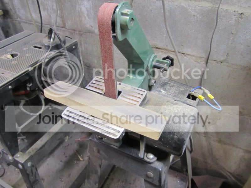

As you can see, the 1x30 was getting a little... worn in.

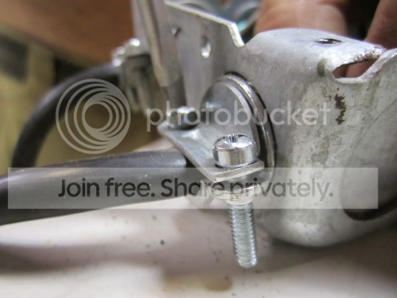

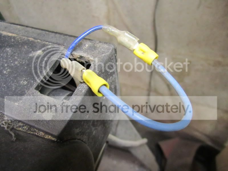

The on/off switch stopped working, so I made it so it would always stay "on", and I'd have to reach over the belt sander and unplug the lead from the outlet to turn it on & off.

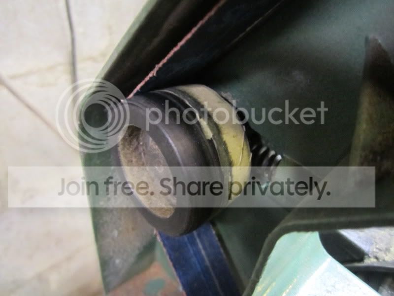

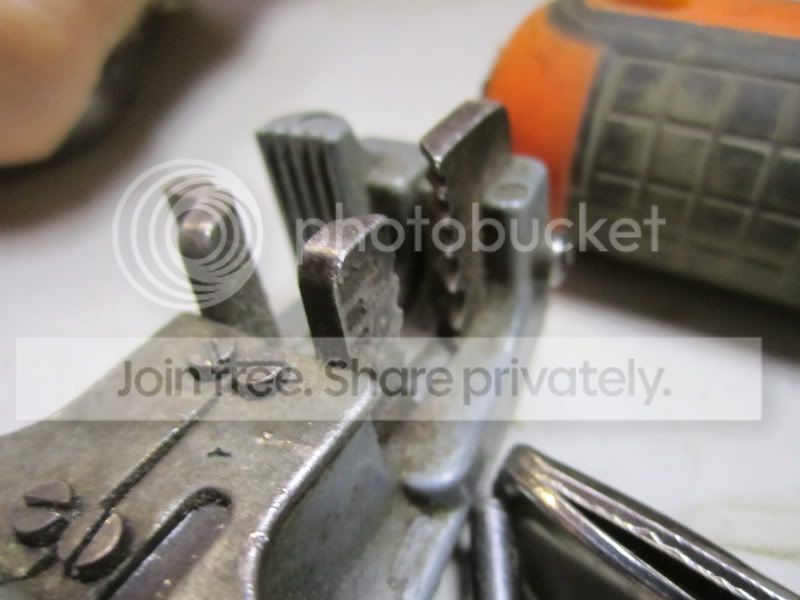

The wheels were wearing down on the inside, throwing off the traction. I combated this by wrapping masking tape around the wheel to try to even it back out... but in the end, I had to wedge a folded piece of paper underneath the tracking springs anyway.

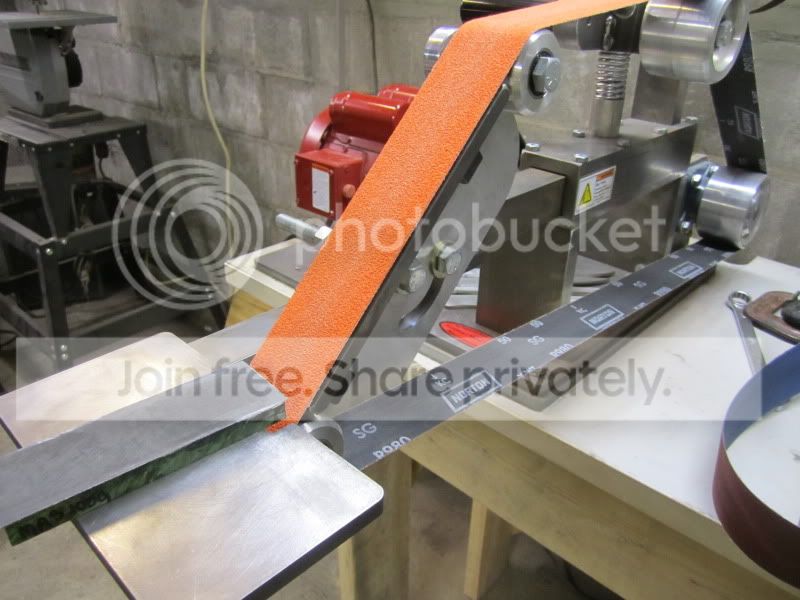

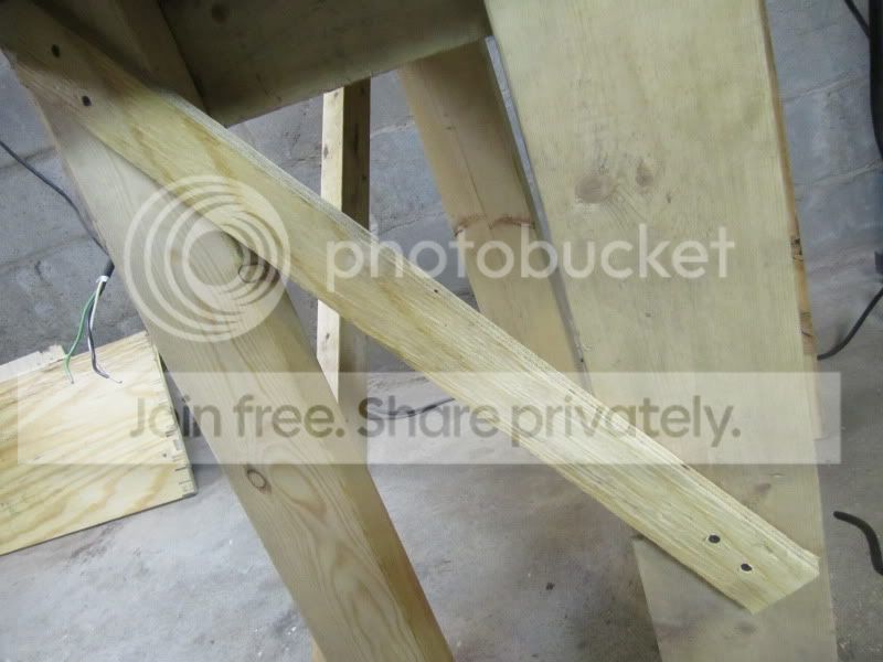

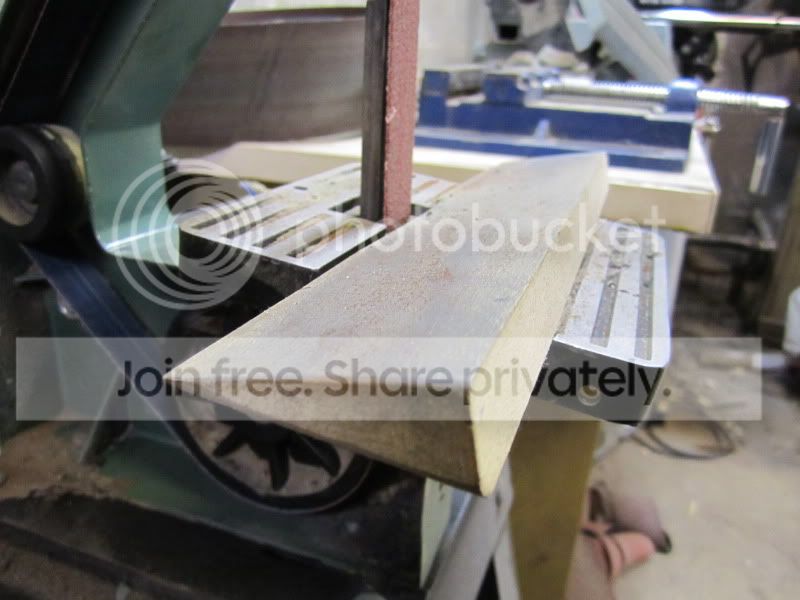

An angled piece of wood attatched to the work rest gave me my angle (with a pitch indicator to double check the angle).

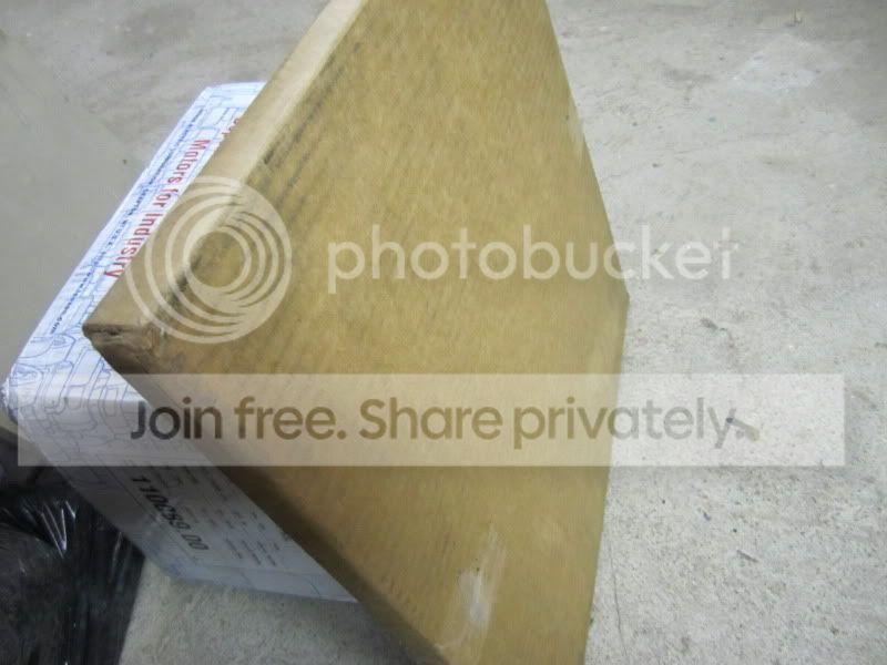

...a wooden frame which I soon broke down and screwed on to my table for reinforcements, because this thing is heavy!

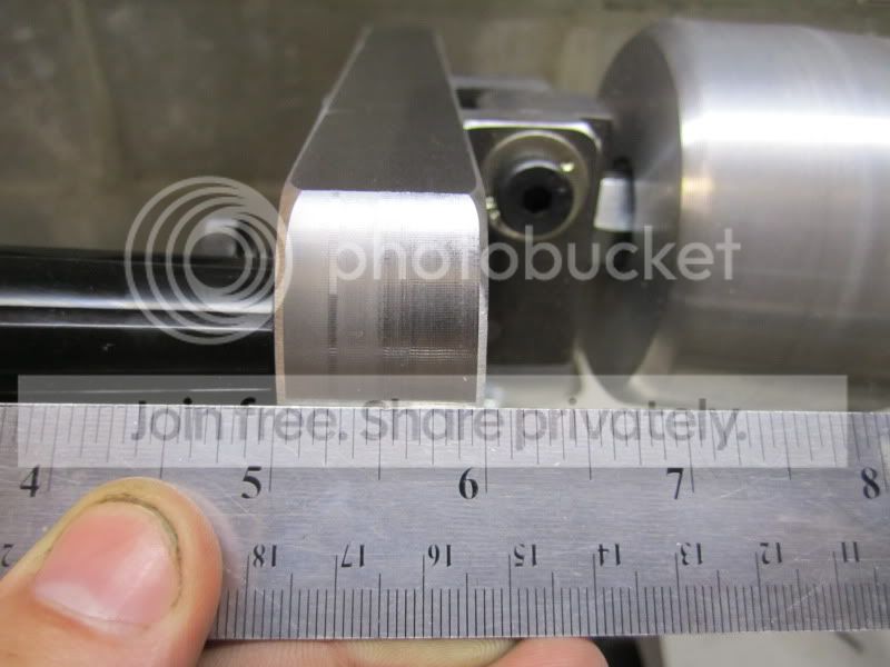

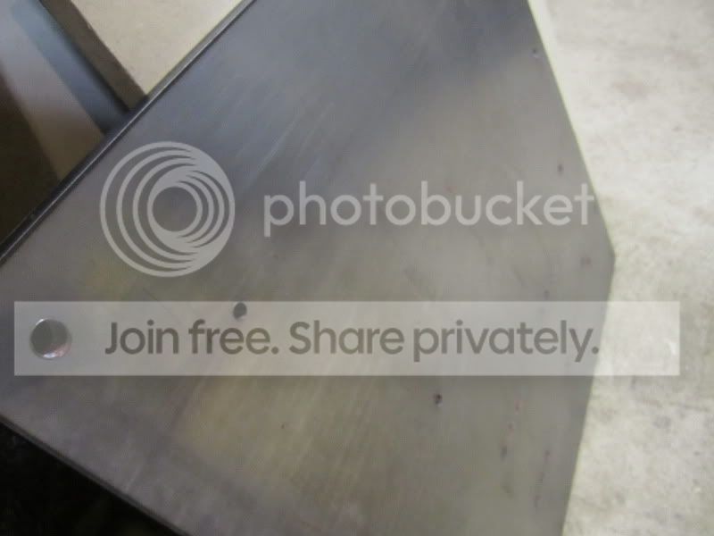

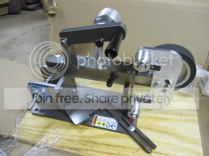

Right off the bat I noticed how thick the steel is. Quite thick... most of the plates are 1 inch.
Most of the edges are nicely chamfered, no burrs.

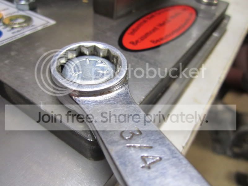

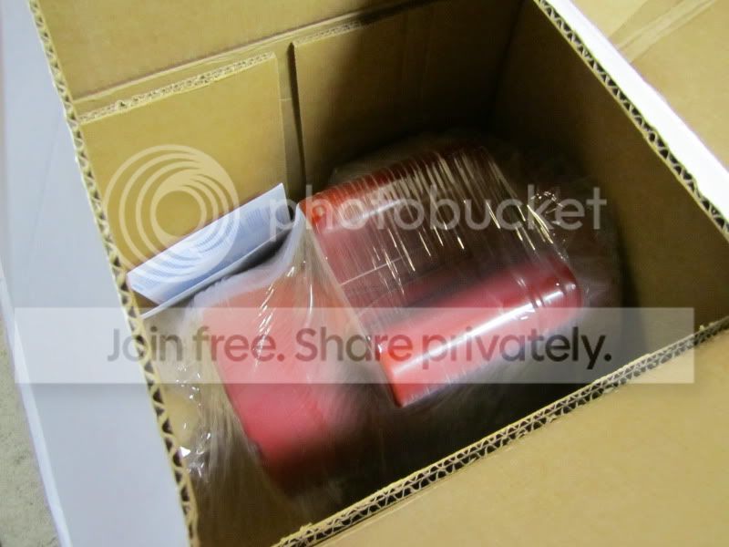

Not too much later that day, another delivery containing the base plate & motor arrived. Another heavy, solid chunk of steel. Time to hook it up.
A bit of wiring, this & that, the grinder was spinning backwards so had to do some screwing around...

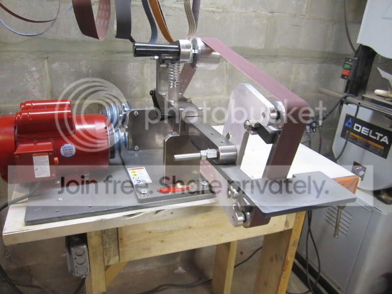

There it is. All hooked up with a 220 grit ceramic belt on.

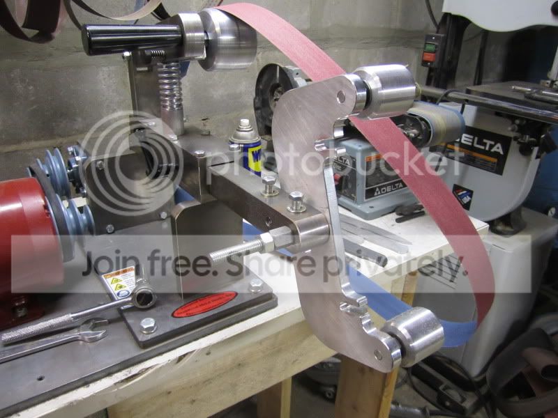

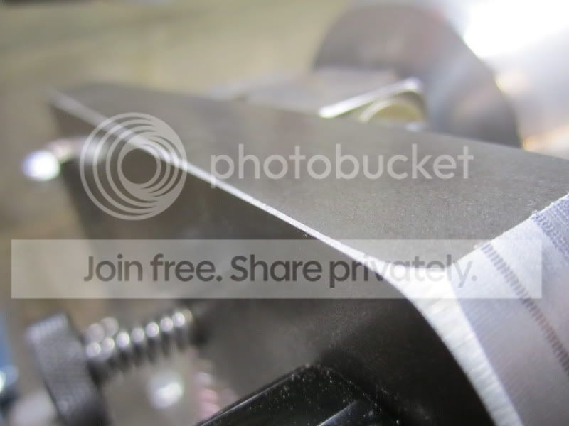

This particular tooling arm has the attachment with the steel backing plate, useful for scandi/flat grinding. With two simple bolts the backing plate can be removed and you have yourself a mean slack-belt option for convexing.
Tried it out... and although it will take some time to get used to the new changes/shape/size/power/etc.. I was very impressed. It definitely removes metal faster, let's just say that. :cool: And very even, now that the backing plate is twice as wide.

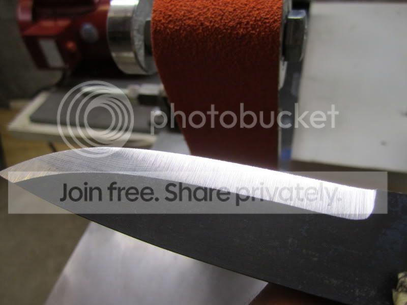

50 grit Norton Blaze Belt is... ridiculous.

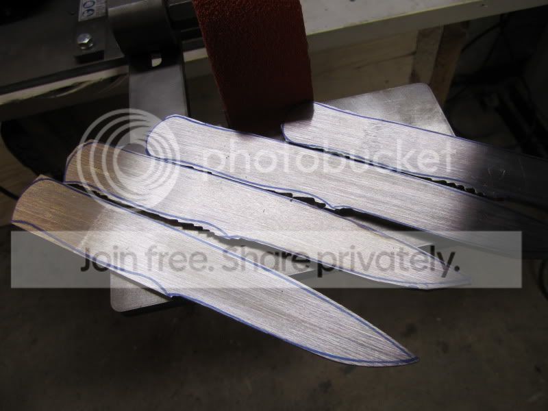

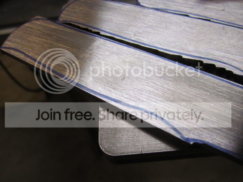

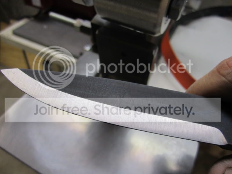

So I decided to grind out a batch of four blanks, see how it really works. As you can see I left some extra material on, I didn't go nearly as close as I usually do with the angle grinder on purpose (to test the KMG).

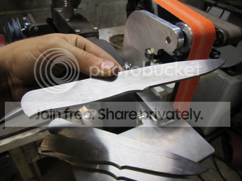

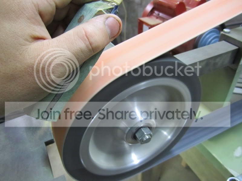

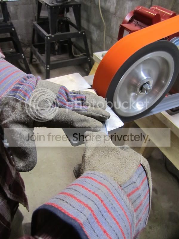

8 inch contact wheel doing work
It worked very well, with a significant increase in speed & comfort.

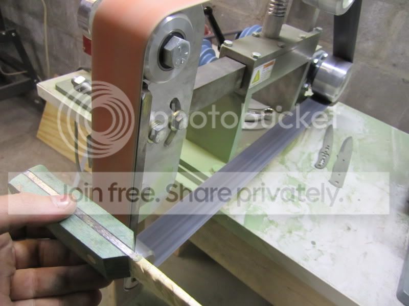

Here is the attachment without the backing plate for slack-belting.

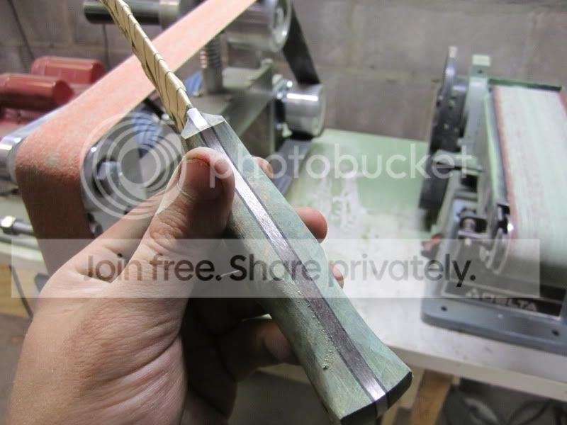

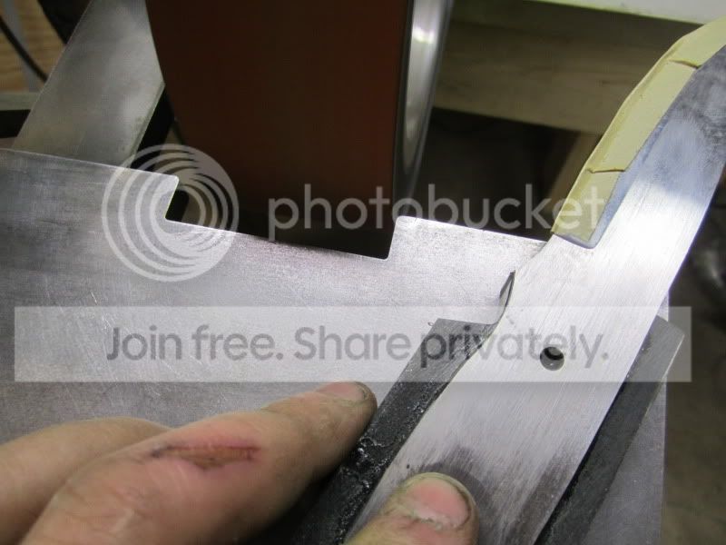

Here is the backing plate at an angle for putting the ramp on the front of some knife scales.
The 8 inch contact wheel can get around corners with ease

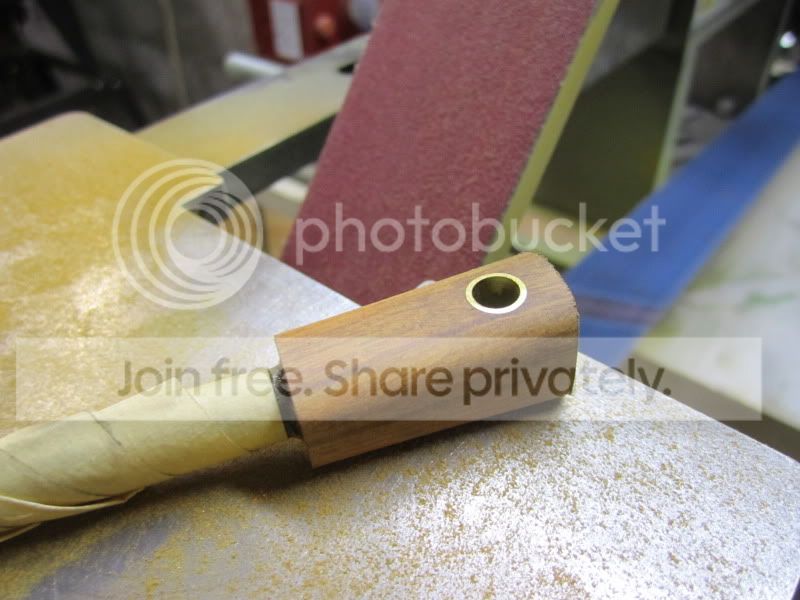

Easy to get the handle material to the tang
Handle contouring.

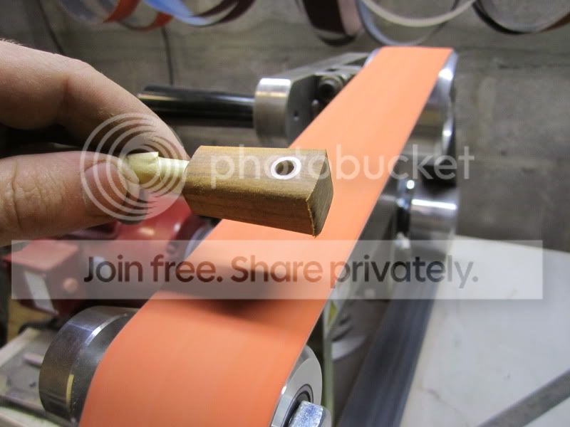

And using the top part for the basic shaping of a firesteel.

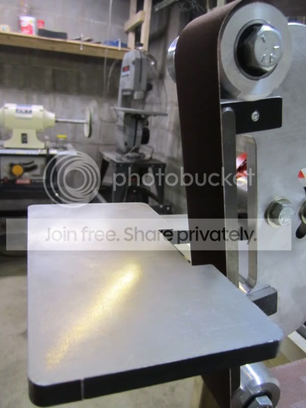

The only thing I wish was different, was that the work rest was a bit longer. If they had an option on his website to buy a longer workrest, I'd be all over it. However, the company was nice enough to let me know that most people have great success by fixing (even glueing) a longer flat work rest on top of the original. I'll probably end up doing that for my 10 inch blade leuku knives.

congrats on a great grinder. Here is a tip about the platen (metal backing plate) removal. You can just unscrew the two screws that hold the platen to the bracket. The bracket stays in place and you dont have to realign it every time you need to use the slack belt. This saves a few minutes each time it needs to be reinstalled.
