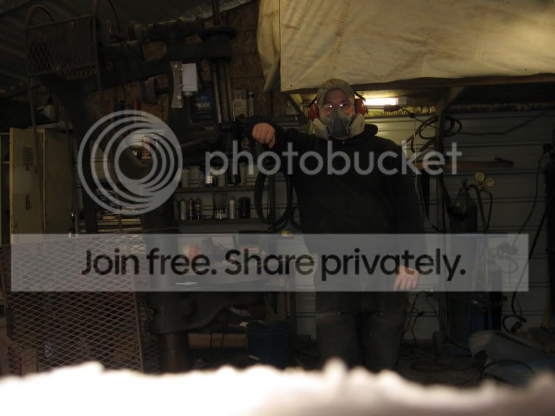

Figured I hadnt done a build up on here so here you go.

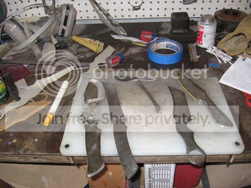

First the messy a$$ shop:barf:

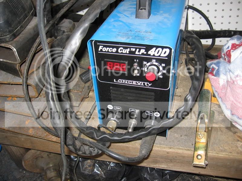

The plazma

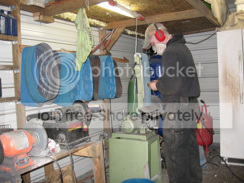

The sander, this thing works great for radius's.

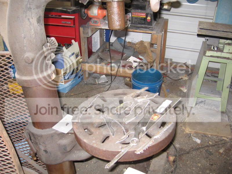

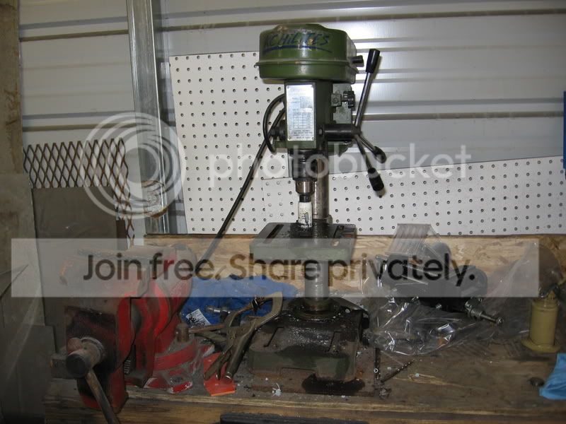

drill press
The loot and then the man drill press:D

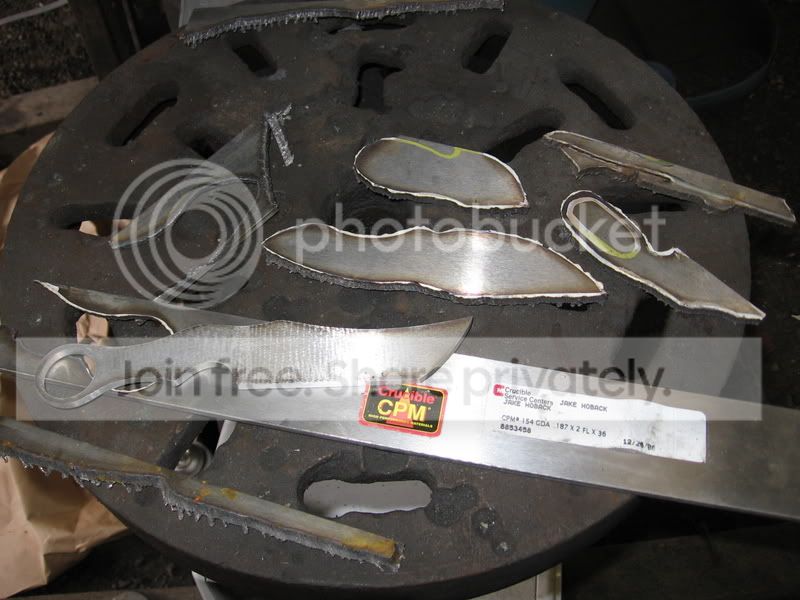

Cut outs
Next batch

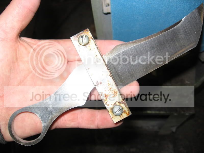

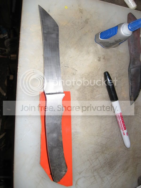

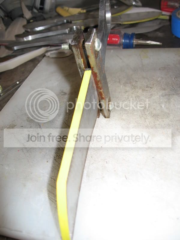

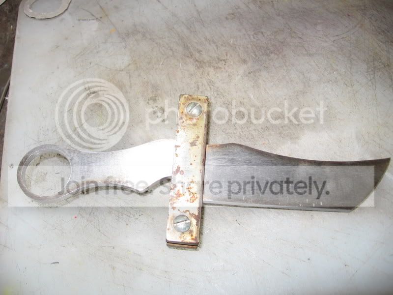

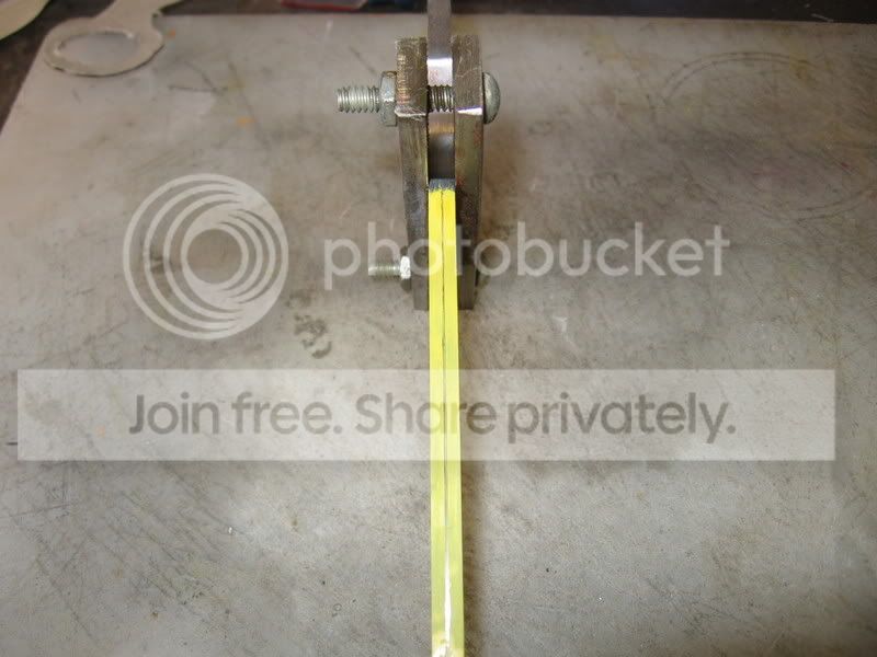

Now for the knife I'm working on, this is after I cut it out with the plazma, then ground off the kerf with a 4.5" grinder. I then put it into my cheap plunge cut jig.

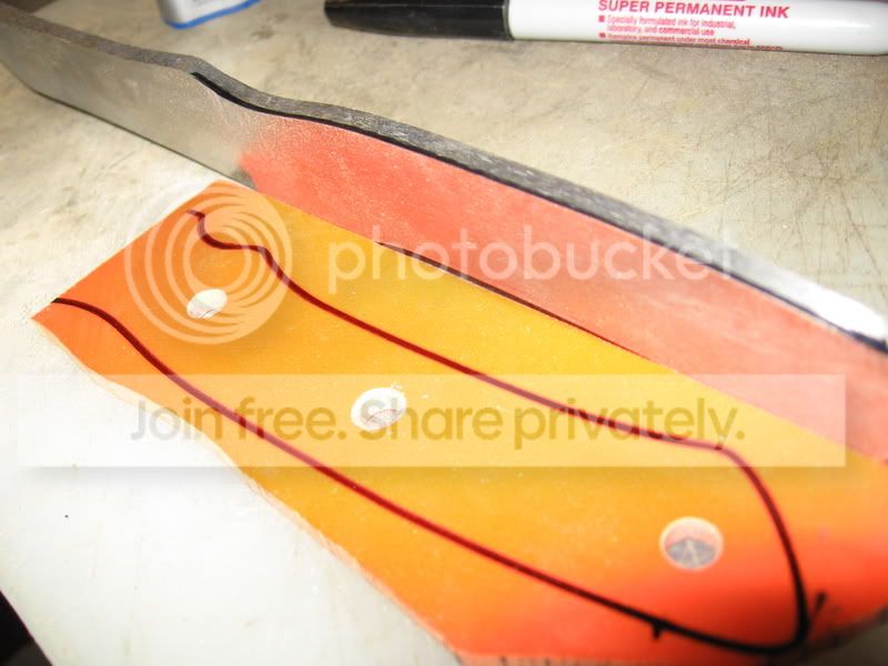

Then cover the edge with paint pen, and scribe the middle.
Then start grindin
Took it down to 320 grit then hand finish later
More later

Thanks a bunch guys. I'm still working on the drill press, that thing is huge pushin about 1200 lbs:D Got to get a new motor and some leather belts for it.
that design is awesome. i think we would like to see some of your finished stuff, thanks
where do you get those belts?
they look like 6x48, if so i cant find'em anywhere.
Thanks I will post some more pics, I usually put them in the pic forum.
The belts are 6x48, I get the belts from western tool supply here in Olympia.

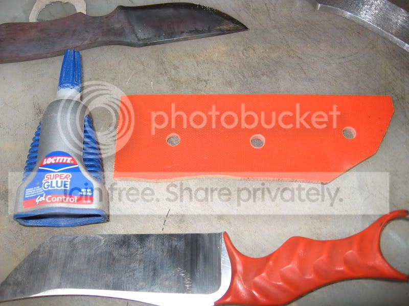

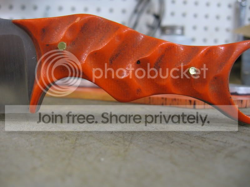

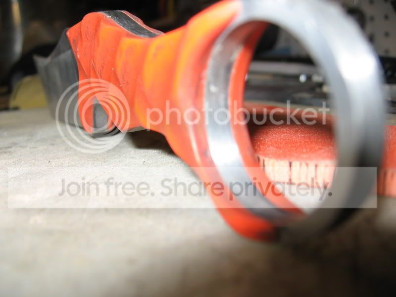

got some more done tonight. I forgot to show how I got the handles situated at first.

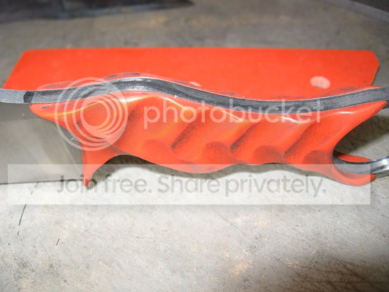

Started by cutting out the ruff shape of the handle and then I put a couple of dot of super glue on the handles and then bound then together. Different knife but same gist.
I then used a huge bastard round file to cut the shape I wanted into the slabs.

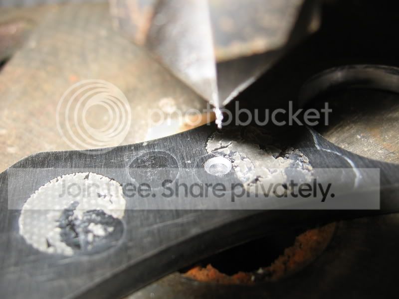

I usually use alum pins but I decided that brass would look better in the application, and allot smaller pins too. The handles are not glued on yet, just a little bit of super glue to hold them on. I still need to finish sand and send out for HT.
Always be sure to chamfer the holes so you don't get cracks during HT

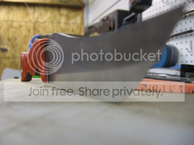

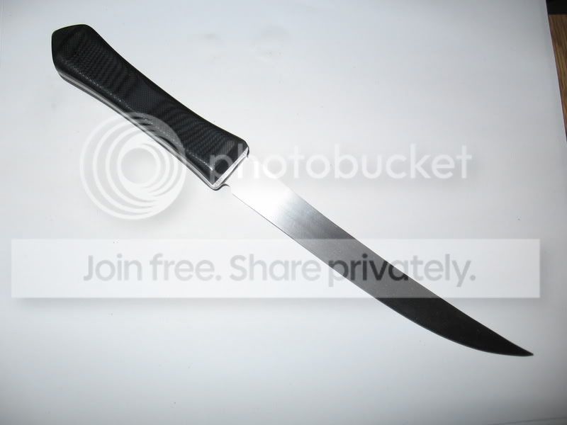

got this one done the other day, still needs HT though, hell of a sanding job:grumpy: I oil sanded it down to 500 grit. When I get it back from HT I will take it to 1200-1500 grit and polish it up:D should turn out tits
Love the way you do the handle, looks like it would feel really nice in the hand.

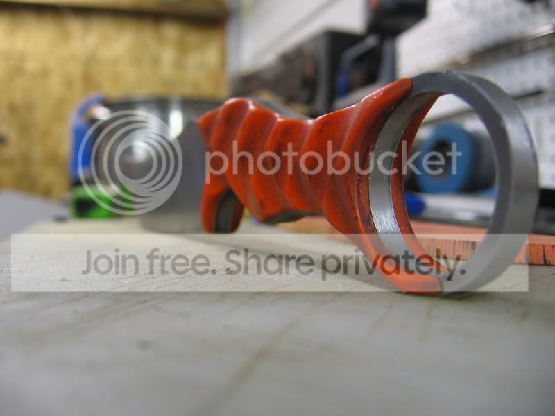

Sorry for the delay on posting more pics:) been busy.
I started hand sanding the blade down then got side tracked with profiling a few more blades, the ended up finished 3 more:rolleyes: I should have it finish sanded and ready for HT this weekend if I dont drink to much green beer:D
