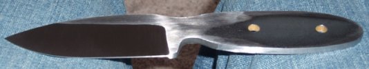

Ok here it is. I spent some time on this blade here and there and was able to finally finish it last month. It was given to a Lt Col as a gift for completing his command of a Special Operations BN.
I am hoping that this will be my last Full Tang Knife where the handle is epoxied to the blade because I feel that a carbon steel blade should be easily disassembled for cleaning or re-polishing.
I used a medium grit scotch-bright on the blade. Amboyna Burl Wood Handle and a differential heat treat. I did not perform an acid etch (although on my next blade I am going to try it), so the hamon is only noticeable at the right angle.
While there are some definite improvements to be made on this blade, it is the best one I've made so far (not sure if that says anything).

Sorry to bump, but was wondering if you guys could tell me what you thought of my latest knife. I have two Knife projects in the works and I am trying to learn off of this last project. I was out of the knife-making art for over 2 years, since my last deployments put a halt on things. Looking to finish two more (make that 3) before I go down again. Thanks for any input you can provide. I have been re-learning allot and I am very interested in learning etching (Thank you Dave Kelly for your info), Hand Polishing, hidden tang, and more unique hamon. A recent post by Stacy has given me the idea to switch to Satanite. Thanks again.
I think it's a great looking little knife! I hesitate to even say this, as it is completely my own personal preference, but I don't generally fall for sway-backed knives, so-to-speak, but that's taking nothing away from this little guy. Without the narrowing waist from the spine, you'd have a bit more space for enlarging those great looking bolsters.
Maybe something that you could do that many people prefer is to hand sand the blade with scratch marks going parallel to the spine. At a higher grit (1200+) with hand sanding, I'd think that hamon should really pop. Again, that's a personal preference, and I don't mind a nice machined finish on a user knife.
One other thing would be to try and match the pin and bolster materials for a more uniform package. Maybe try some SS bolsters with SS pins, or brass bolster and pins.
Great job overall!
