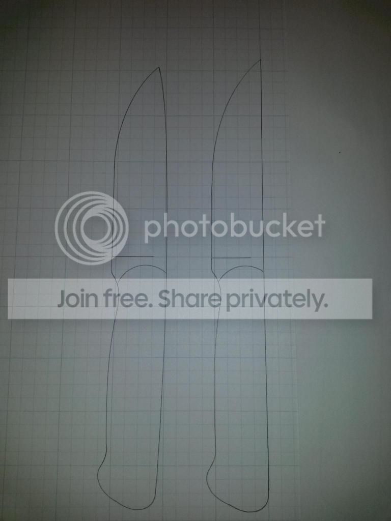

Thanks for the replies. Perrin- why don't you like straight lines. That is interesting to me. Thanks.
The simple answer is that I just find it more aesthetically pleasing to the eye. Stacy has equated it to the shape of a woman in other threads I've seen. I have tried to sketch an example. Not sure if I have illustrated it effectively but here it is.
I tried to keep everything as much the same as possible except that the spine has a gentle radius. This does affect the tip and makes the one with a radius have more of a drop point then a straight point and the handle seems to have a little more meat to it but overall they are pretty much the same. The difference is subtle but there. You are welcome to look through my photobucket where I have a few more drawings saved.
