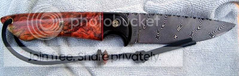

Just finished this one up.
Sheath is drying.
Specs:

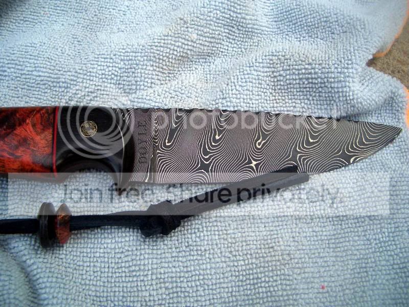

1095/nickel damascus .187"
9.75"oal blade is 4.5"

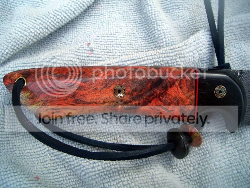

handle is dyed boxelder burl w/intarssia ebony bolsters
mosaic pins, red and black spacer material
beads on lanyard are made from handle material
pics are lousy as always
all comments welcome
Thanks for looking,
Matt Doyle
sweet looking knife matt. i really like the damascus pattern. sweet filework too. i wish i was good at it.
Sweeeet! The boxelder is stunning and all the colors and design just flow together.
The pics are actually pretty good (though coop would like to add you to his campaign to wipe out towels as picture backgrounds).
I really like the look of the solid black bolster against the burl, nice job.

Nice Matt! So, did you fit the handle slabs that well prior to etching or did you just dunk the whole thing since it was stabilized? ;)

I like how dark the whole knife looks. It adds an air of sophistication as if it was wearing a tuxedo.

Richard, I'm not particularly good at filework either, I'm just too stubborn and bullheaded to give up!:D

Deker, I really wanted to try the dunk the whole knife method on this one, but to be completely honest I just don't have the cajones to try!:D I use a set of short pins so that they don't protrude through the handle material and then finish the whole knife, dissamble, etch, reassemble. Maybe on the next one....

I'm sorry Matt, but I humbly disagree. This knife is definitely worthy! Great knife. The color contrasts just ooze class.

That is really a nice piece, looks great, bet it would be a great user. Just one of these days, all you fixed blade guys are going to turn me into a collector of them too. Gosh, I just realized I already have been bitten by the bug and have the disease, Richard_J sold me a great user. Sharp!!! The handles on this one are outstanding, the file work looks good too!
All around NICE!:thumbup:
