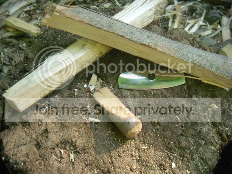

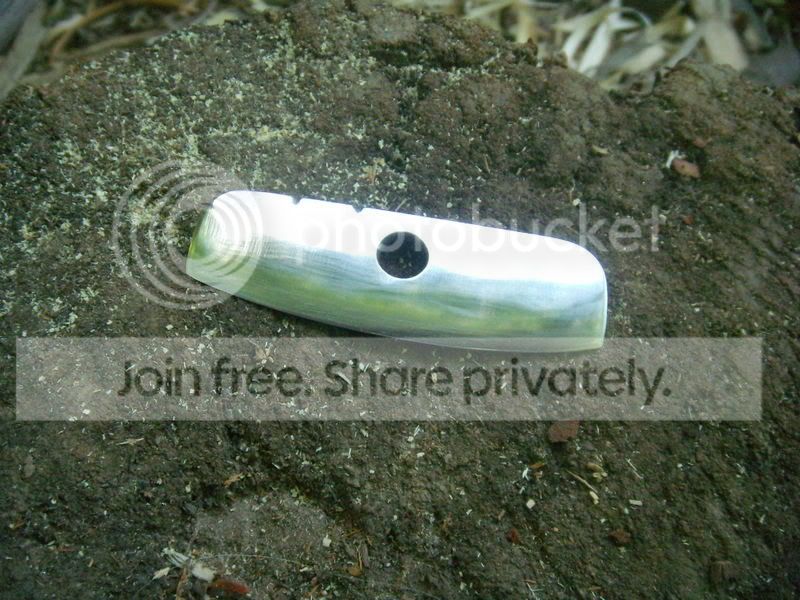

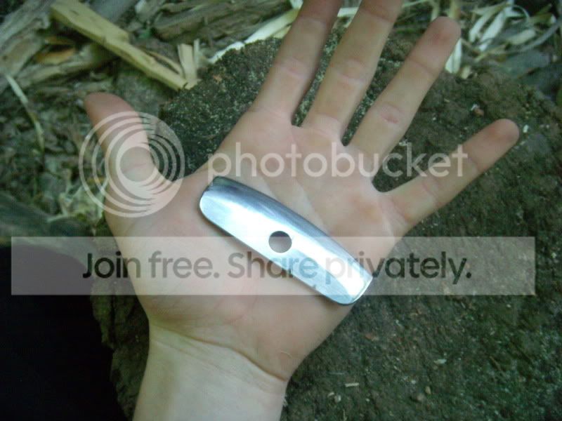

so the other day i was staring at this piece of steel that wouldn't really fit into any blade/handle shape that i could think of, so i decided to try to figure out a new style...
i came up with what i call the "steel flake". the idea is that it is a very minimalist knife, based on the stone flake that the more abo/primitive guys like to use sometimes instead of a knife. this just takes it up a notch. if i remember correctly, DOC CANADA likes to do things rather primitively...perhaps he could offer some comments?
anyways, onto the blade:
1/8" thick, chisel grind, O1 steel

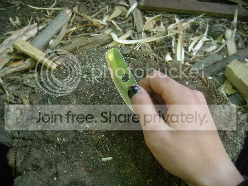

first grip style:
second grip style:

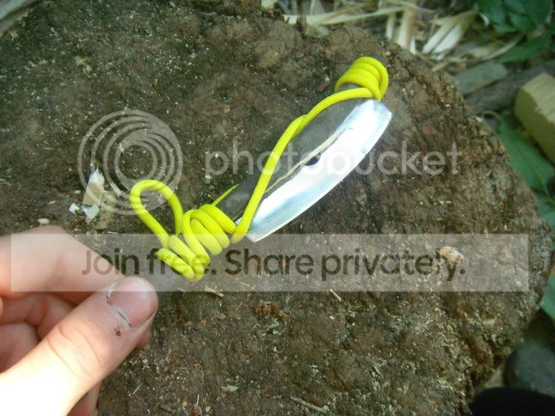

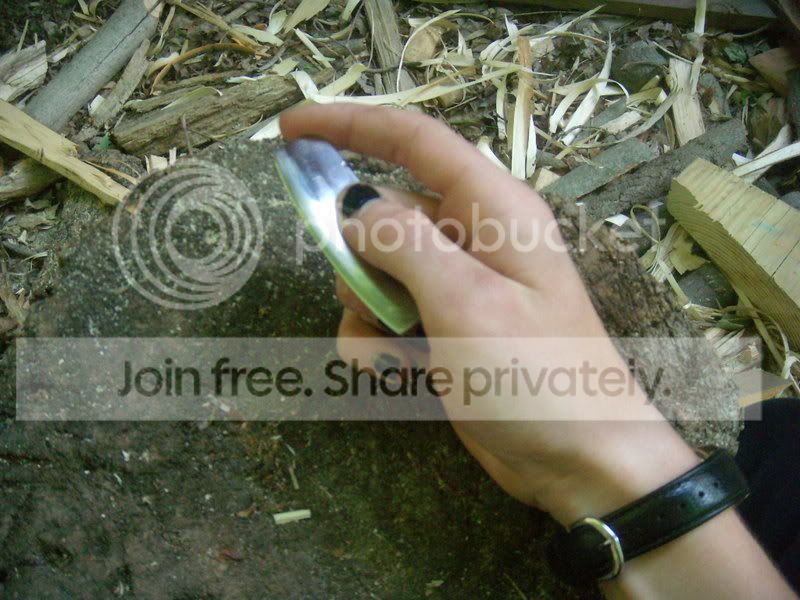

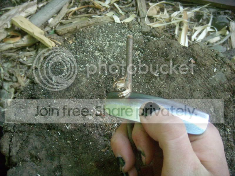

third grip, for whittling. the opposite hand holds the stick, with the thumb on the back of the blade, and guides the blade into the stick.:

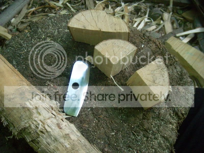

batonning a short log round:
batonning a stick with the help of a wedge:

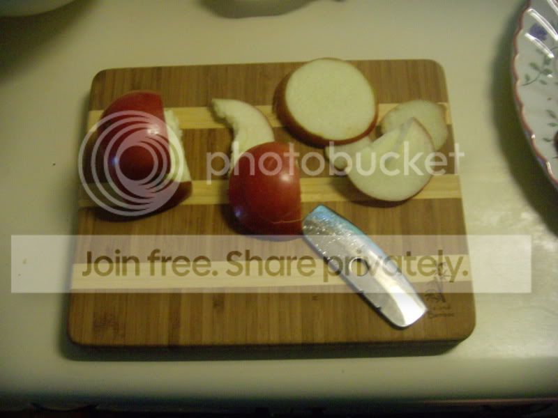

slicing an apple:
made a hoko style knife with it, including cutting the branch with the blade:
overall, i think this style might have potential. the big problems were in slicing the apple (the blade is a tad short, even on a small apple) and trying to use it as a hoko knife (the blade isn't really wide enough to offer a good cutting angle).
i think it might work well for skinning game, based on videos, but i have never skinned anything before so i can't really say.
other than that, i think a regular V grind might be better, over the chisel. the edge is also a tad bit thick on this, making it wedge a little in the apple. i will also say that it made me a little nervous having no handle to keep my hand away from the edge of the blade...
so what do you guys think? does this have any potential of seeing real world use with anyone?
That is a great idea. When I saw the first pic, I thought it would make a great hoko, then scrolled down and saw it. Very cool and useful tool. I generally don't like chisel grinds, but I think it would work well on this and would be easy to sharpen on a rock.
I think it is neat.
I can also image great gouts of blood as I tried some of your techinques. :)
Kind of a ulu without the upper 3/4s.
Nice.
Interesting! My first thought was that the hole was for hafting, though not the way you did it. I envisioned a groove in the stick, allowing more of the blade to show, and perhaps 1/3 of the blade extending beyond the end of the handle. It is true that most flint knives and scrapers were not hafted at all. Have you seen the titanium credit card knives?

the hole really helped alot keeping the knife where i wanted it. i think in the future i might not round out the whole as much, to allow the skin to catch the edge more. i might also try making the hole a little bigger...
my new drafts of the design have it looking more like a mini ulu than this, with a wider blade with a more rounded back...a little like a seashell.
