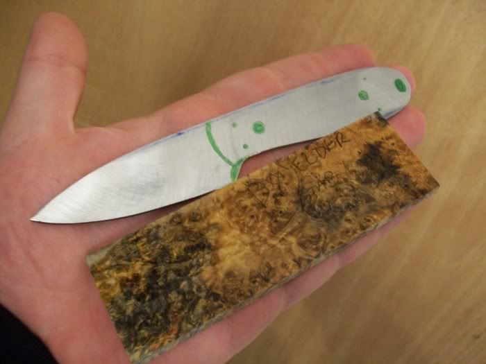

Decided to try another one. Steel is from a big broken double handled Dexter Russell cheese blade. Looked like someone used it as a cleaver. I carefully cut out my pattern from the flat section, trying not to ruin any heat treatment the blade already has.
I'm embarrassed to say, but I have not a clue what type of steel this is exactly, or if the spine of these particular blades have a suitable hardness. The blade said "Dexter Russell High Carbon Stainless".
I'm grinding my knives on a picnic table in the backyard with a Craftsman 2X42 grinder. I dunked this blade often because the Craftsman is a high speed nightmare.
Handle material is stabilized box elder burl. Never worked with this stuff before and boy does it stink to high heaven. Glad I have a respirator...lol.
Planning on using 4 nickel silver pins on this one, and a black spacer.
Hope you guys like it!
Strange angle, but it was the best pic of the grind I had...lol.

This will be my second completed knife...lol. The first was a cord wrapped disaster that i just keep around. I have other blades profiles ground out, but they are on hold for heat treatment, and the setup of my Coote grinder.
I will certainly turn this into a how-to if it would help anyone. Im very new to knifemaking, but I have studied it all my life. As I progress with this one, I will be sure to add more pics and fill you in on how I do things. I'm still learning a whole lot too so bear with me...lol.
