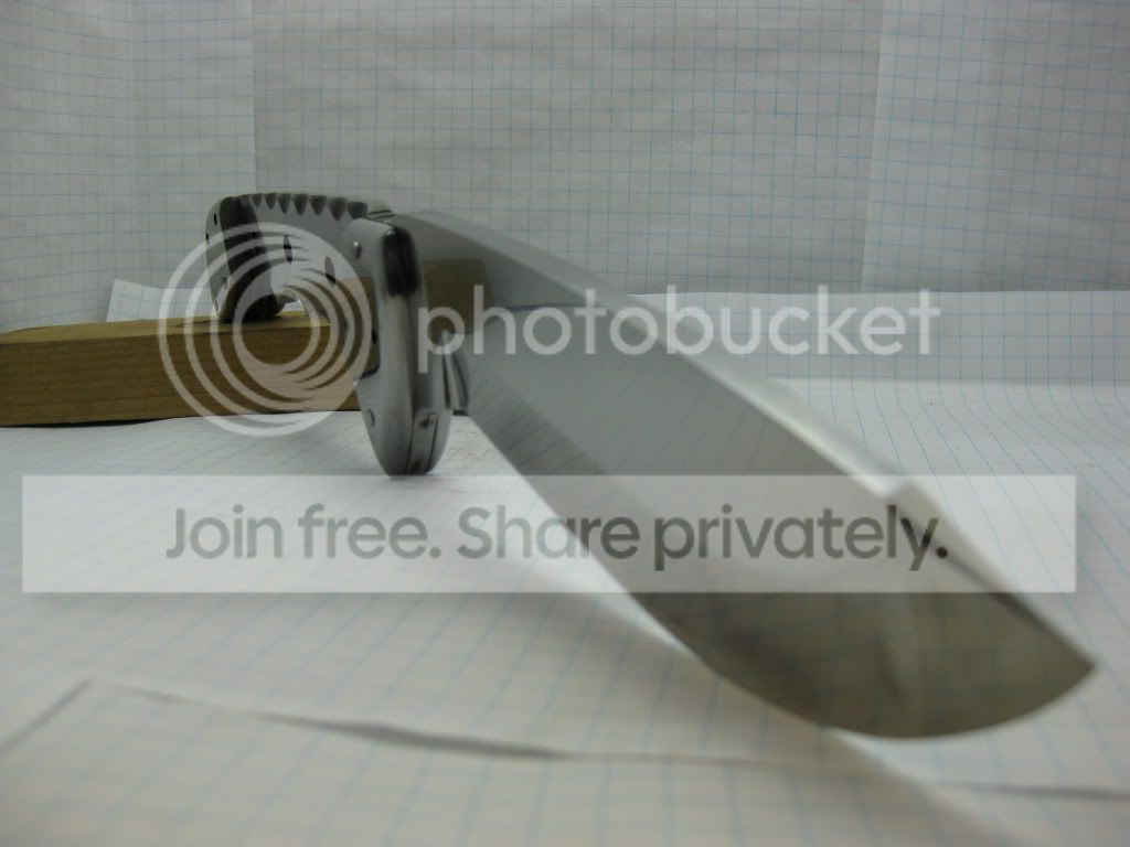

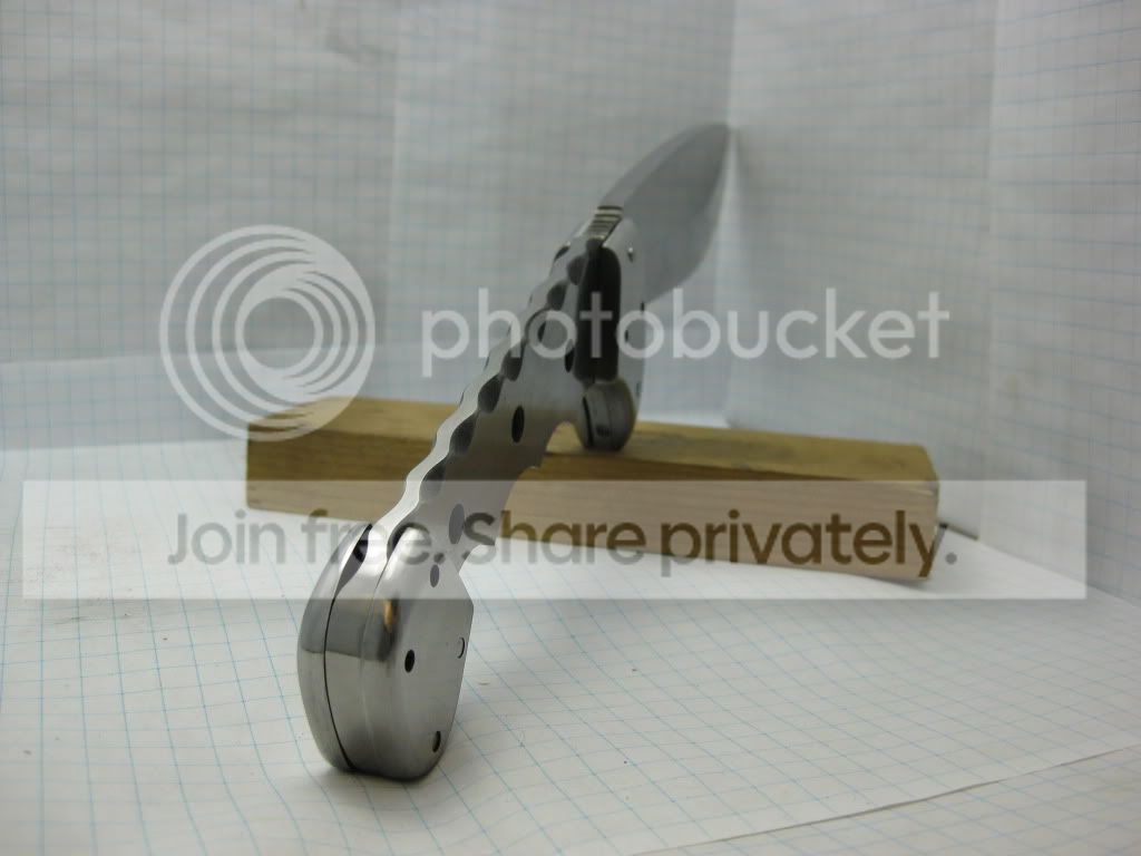

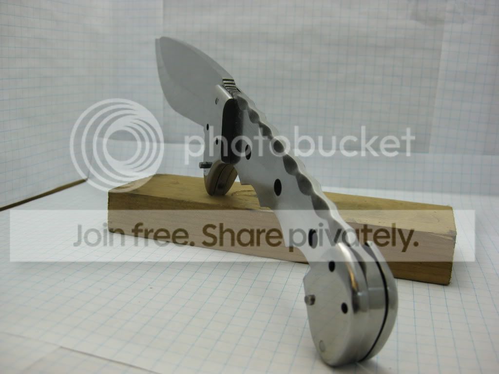

well kind of a WIP, like a dummy I didn't think to take pictures when I was forging the blade and rough grinding, the pics start at around 80 grit, and also include my first attempt at file work, which I am super happy with:)
comments and suggestions welcome ;0)

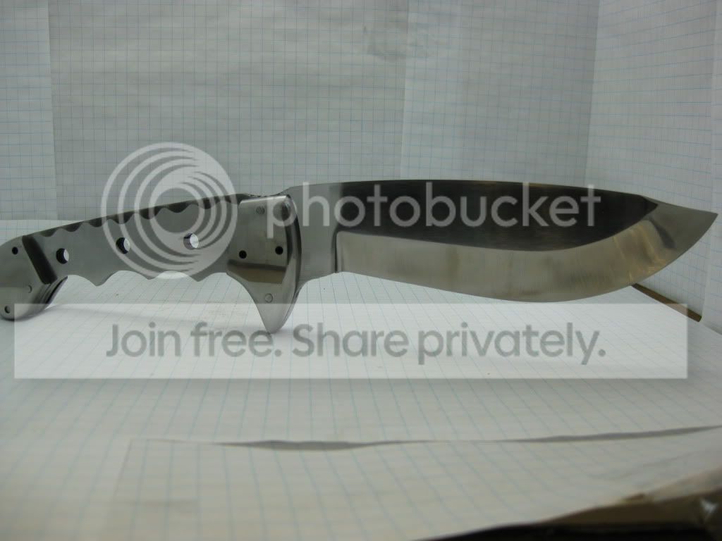

well I got a bunch of sanding done today all the way down to a 5x norax, just need to pick up some 2000 and 2500 grit paper to finish this week end, then comes the hard part choosing a handle material, I sure wouldn't mind some suggestions
I have a nice piece of red oak and brass pins, I also like the 2 tone black and gray micarta,
and I decided to put together a cheap photo box, paper and card board powered by a 1000 watt metal halide bulb, pics turned out real nice I thought

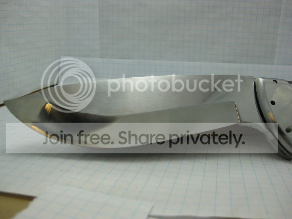

Nope you you didn't miss them, I guess I have gotten so wrapped up in the build because it is going so well that I completely forgot to add that info, so here it is
Steel. OCS 5160, taken from a 1978 Chevy motor-home
Heat treat. Using the non-magnetic method, quenched in motor oil warmed to 135 degrees, which I have done to a dozen test pieces now and have gotten very consistent results, thanks to mark's tips
knife dimensions.
over all length 11 7/16
tip to bolster 5 13/16
handle 5 5/8
weight 455 g
handle thickness 0.233
blade distal taper 0.233 to 0.190
blade at its widest point 1 11/16
bolster material OCS 5160 thickness 0.200

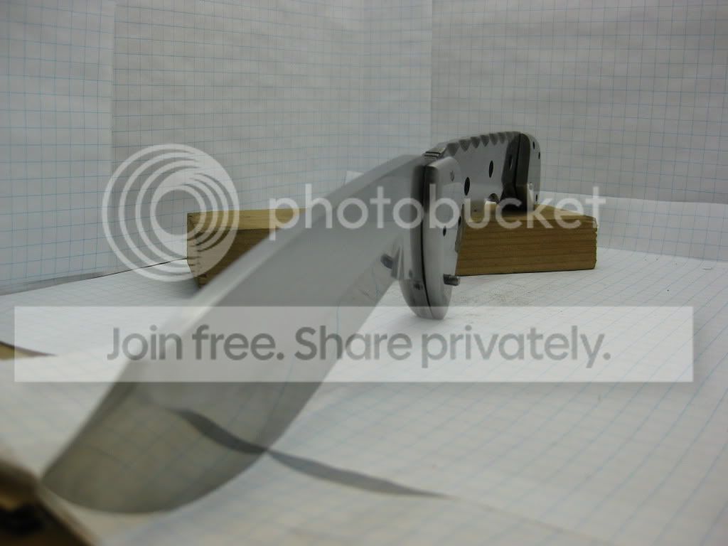

Very cool! For a handle material, I think black paper micarta would look real nice.
ya I agree... think the oak and brass pins are out, this knife seems to be taking on a new life other then the one I had in mind, I'm thinking the black micarta with steel pins and black carbon fiber pins for the front and rear bolsters, a nice contrast
EDIT....it was black and green G10 I was looking at not micarta
Wow. That carbon fiber's really cheap. yeah, that's a way better deal. TKS does have micarta rods, around $2 for a foot, but the cf rods are still much cheaper.

well I made a few changes from my last post, I decided to go with steel pins in the bolsters instead of the black carbon fiber, and I liked the black and green G10 so much I couldn't bring myself to drill holes in it, so i went with hidden pins instead, I drew the original pin layout in MS paint, and it looked a little to busy, this way the whole knife looks a lot sleeker
So what do you guys think? thumbs up or thumbs down, I think I am going to make a few more similar to this one, so suggestions would be welcome

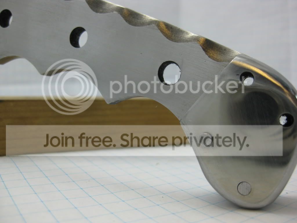

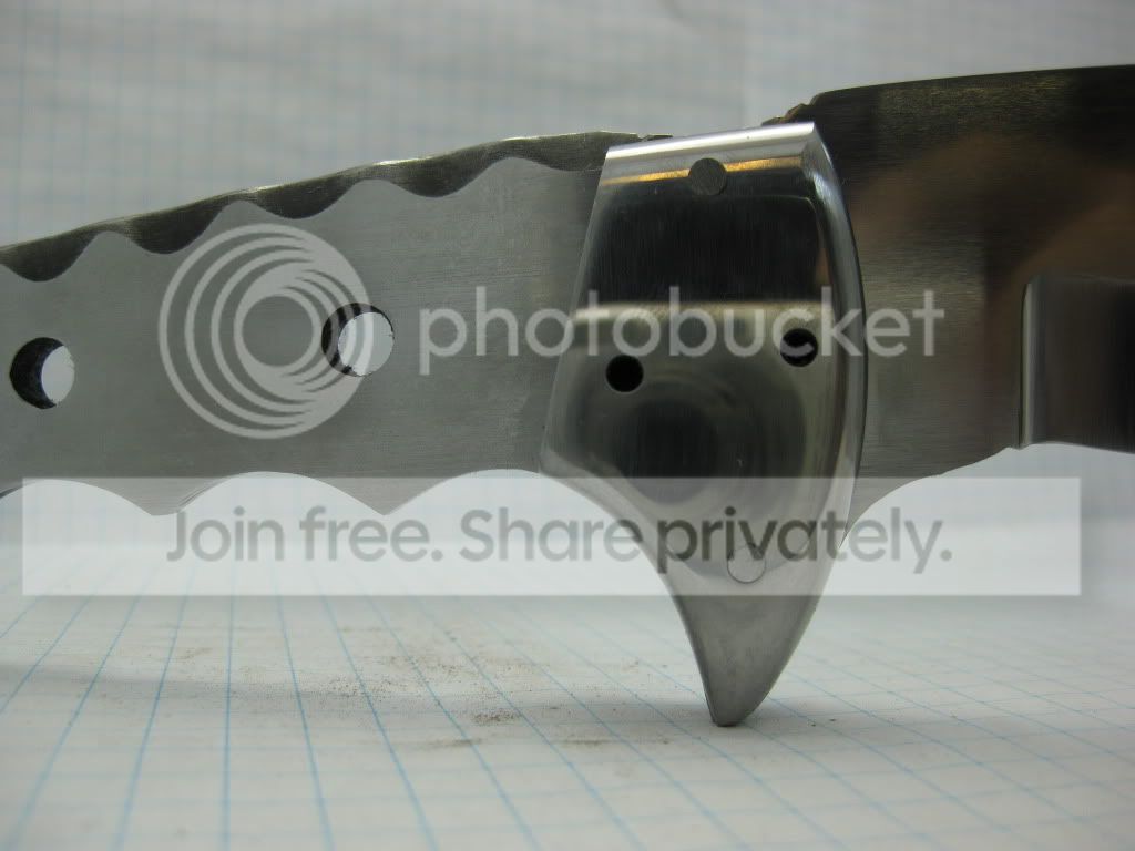

The finish looks great, but why did you leave the top of the tang sticking proud of the handle? Just doesn't look right to me. Doesn't look comfortable either. Perhaps make it all flush and filled in with colored epoxy since the filework is so deep. Also maybe move the thumb notch forward of the bolster, as when you choke up your grip and use your thumb it's more comfortable to be able to bear down directly over the cutting edge.
after I finished the file work it kinda reminded me of an animals spine, and if you look at various large animals the spine is quite prevalent, kinda took the idea from that,
Looks really good.. I like how the file work is outside of the handle on the tang.. Only - would be it would look even better if you stared the file work at the rear of the handle instead......
But I do like it a lot... Good job!
If you bevel the bolsters and the G10 with hidden pins the scales definitly will not come off
