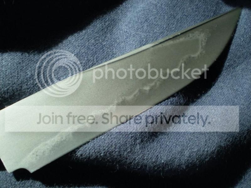

I finaly got around to using some of Don Hanson's W2.
Thanks to Jeff Helmes for drawing it down to usable size from 1 3/4" round with his power hammer.
This is the first W2 hamon i have tried since building my oven and using houghton K.
I gave the blade a long soak at 1425f quenched in than tempered twice at 450f.
The quench k seems to work great for hamons and no dredded tink.

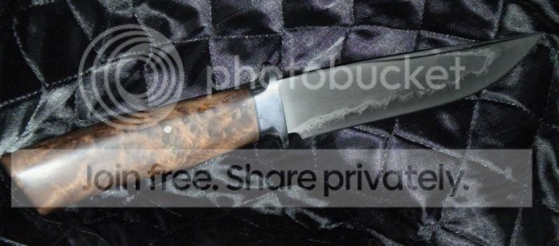

Now to the knife the blade is 5 1/2" to the guard and 1 1/4 wide with an o.a.l. of 10 5/8"
W2 with a 416 s.s. guard and stabilized redwood burl handle.
Bob
Knife looks great Bob! :thumbup:
Only thing I wonder about is the pin placement. Any reason for it being off center that much?
I figured someone would ask about the pins notice i said pins and not pin look close there are two.
The lower one is not clear in the picture. Why two? Why not it's different!
Thanks guys.
Bob
I like it! Nice hamon. I was thinking of mentioning the pin when I read further. Noticing the bottom pin, it does look more balanced.
The hamon looks like choppy surf... the sort that seagulls enjoy. You should consider etching a seagull with wings spread onto the flats. :)
