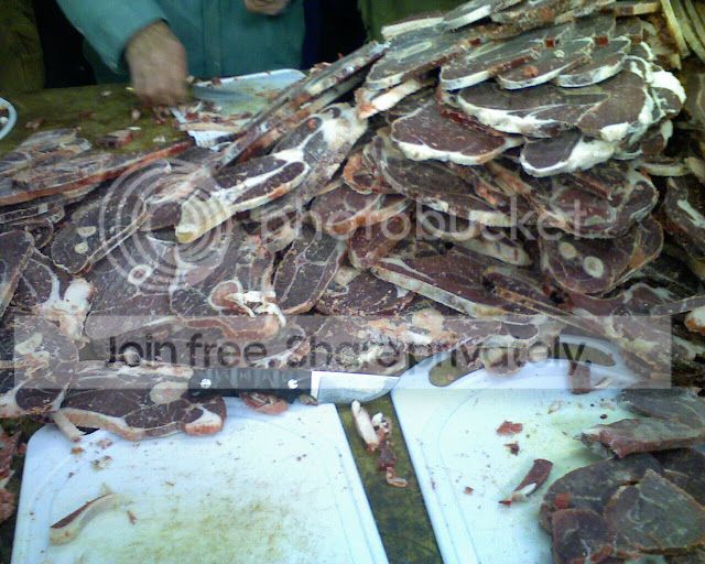

Listen to these guys. 1084 from Aldo is really a great steel for making a blade. I wish I had started using it sooner. A customer just contacted me about a knife I made him that I used the 1084
This is what he said and here is a pict.
"Here are some recent action shots of the blade you made me
End of the season hunt club supper. 30 bear and 40 dear legs. Me and a few guys. Cutting the bones, fat and gristle from the meat for 5 hours straight. Adam your knife. Is a sharp SOB. After 5 hours she was cutting like a champ. I didn't even strop it during the cutting session. And that's all I did besides cleaning it when I got home. On that sweet lil block you made me! "
