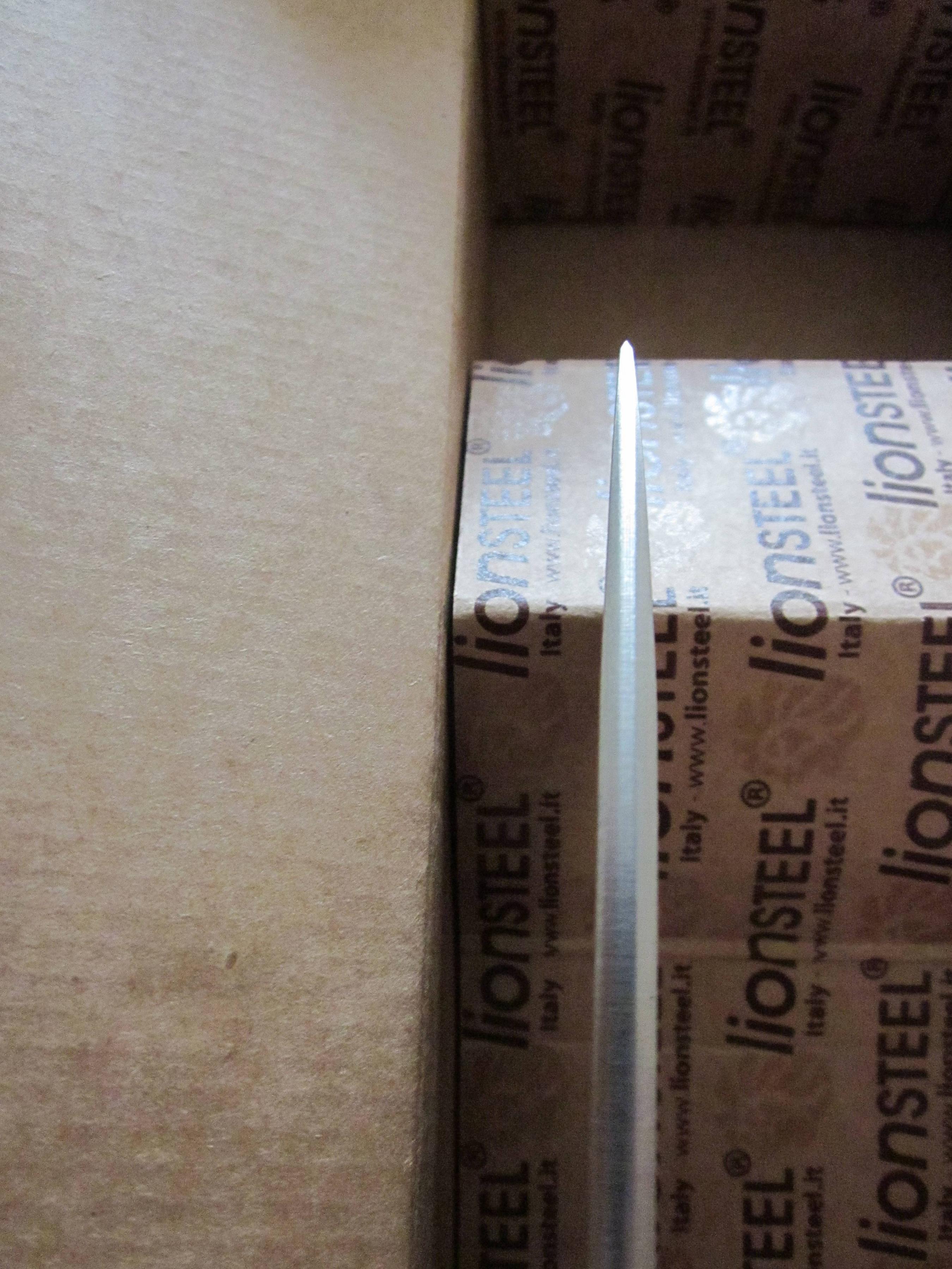

First off...I'll try to post pictures about the M4 asymmetric grind when I'll get back home (in 6 hours).
LATER EDIT : Got back earlier than expected, so here are the promised pictures :
Here you can see the knife as it arrived, fresh from the box.
This is the picture taken when I realised there was something off with the edge (can you spot it ?)

CONCLUSION : Even if the angle is kept the same on a professional sharpening system (measured with a digital protractor, it is 15.05 degrees on the left and 15.11 degrees on the right), the asymmetry cannot be repaired. The culprit is the uneven grind, this particular model (mine...lucky me !) having too much metal on the left side.
As was already proven by another forum member, this is not a singular error : http://www.bladeforums.com/threads/new-lionsteel-knife-m4.1403725/page-5#post-17012012 .
In a grossly exaggerated illustration (forget my lack of artistic talent), this is how my blade looks like, seen from above :
I'm looking at mine right now and the grind from the spine all the way to the edge (including the cutting edge both sides) is perfectly symmetrical.

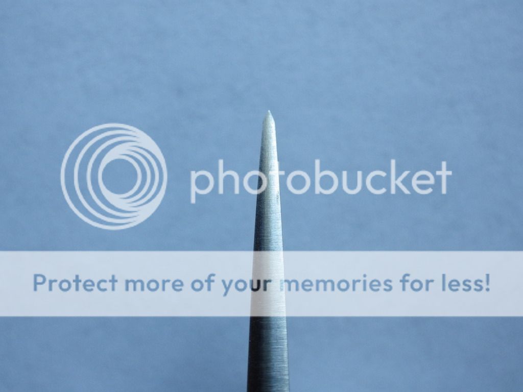

Here's mine looking down at the spine using a Pentax SMC wide optical 16mp lens in 1cm macro mode.
The glass is less than 1/4" from the knife. The knife is perpendicular to the camera lens. I'm providing a uniform light color background to increase contrast. Nothing to hide - nowhere to hide.

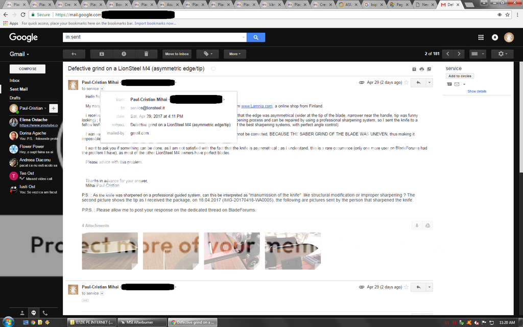

As for contacting LionSteel - I did it (even if I don't expect something possitive) two days ago... and still waiting for an answer :
LATER EDIT :
1) No answer from LionSteel for 4 days now.
2) After 5 days and a second email, I got an answer :

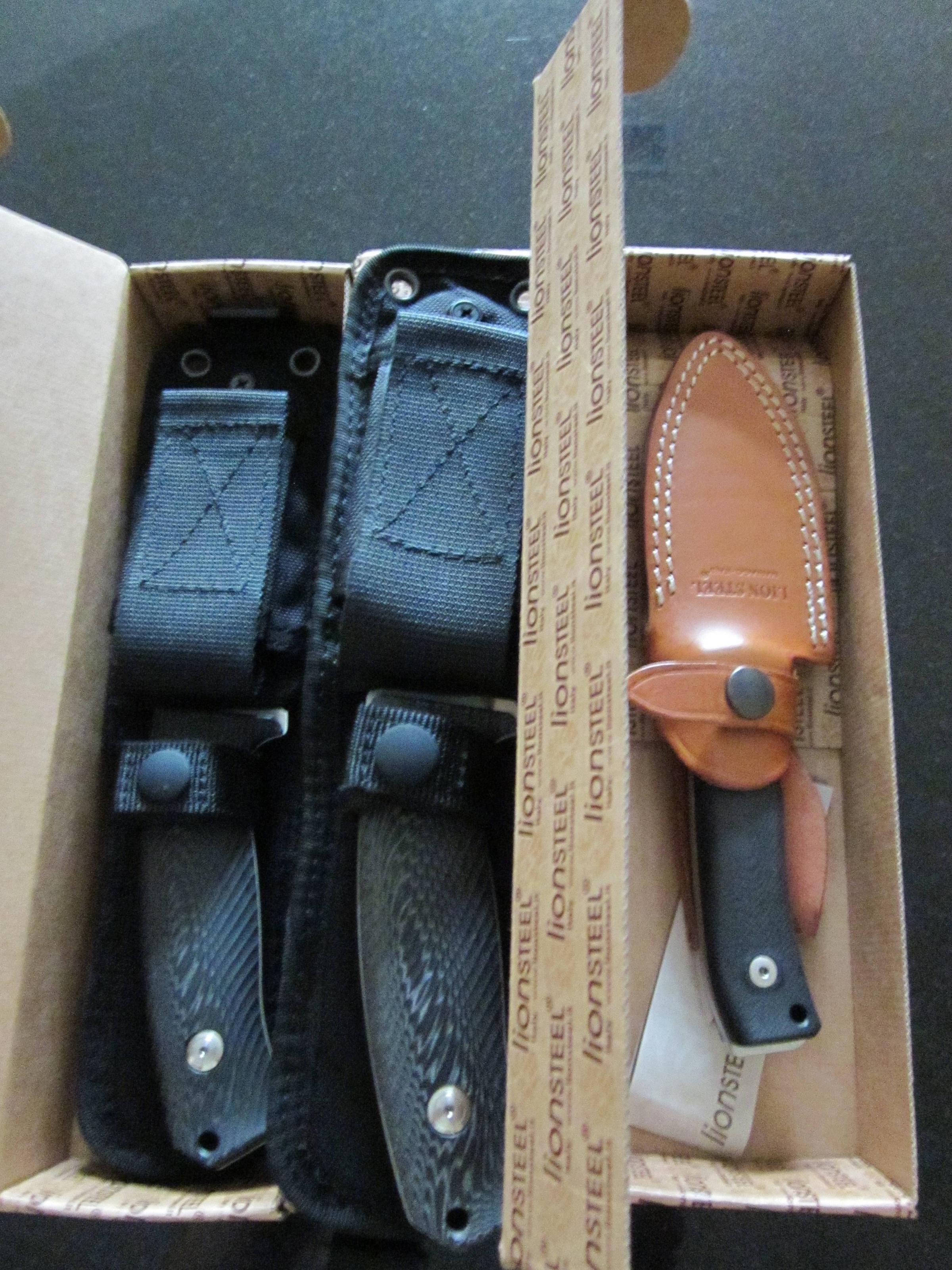

My LionSteel M4 with Cocobola Wood handle is very nice. Great price of $132 shipped. Leather sheath fits nice and snug.
Sharp blade with even grind. The sharpened edge is a little uneven resulting with a slightly off tip. In the handle it looks like the screws were tightenend a little too much and thus raising the affected area a little. None of these are issues that need me to send it back.
Overall, very happy with the value, quality, size, weight, materials and how well it fits the hand.
