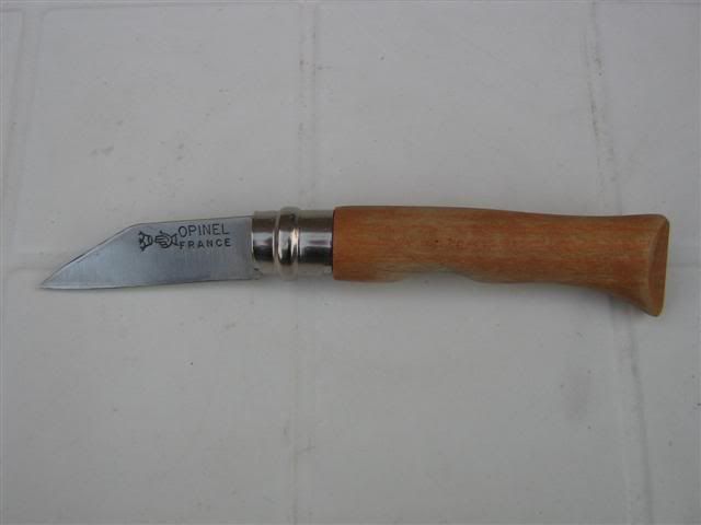

I started modding an Opinel n°6 yesterday. (I must admit that before yesterday, the only thing i have ever carved was a spoon.)
This n° 8 i have reshaped earlier, with future whittling in mind. I used a dremel and a wood file:

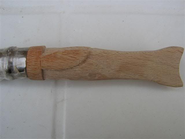

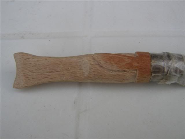

With this n°8 i took on the n°6 yesterday evening:
I've still got a lot of work to do, until my "fish knife" is finished. However, when i got this far, the shortened n°8 retaliated for what i've done to it. It tried to resize my left thumb. It'll be fine tomorrow, i guess...

Zeppos,
That's looking good!
