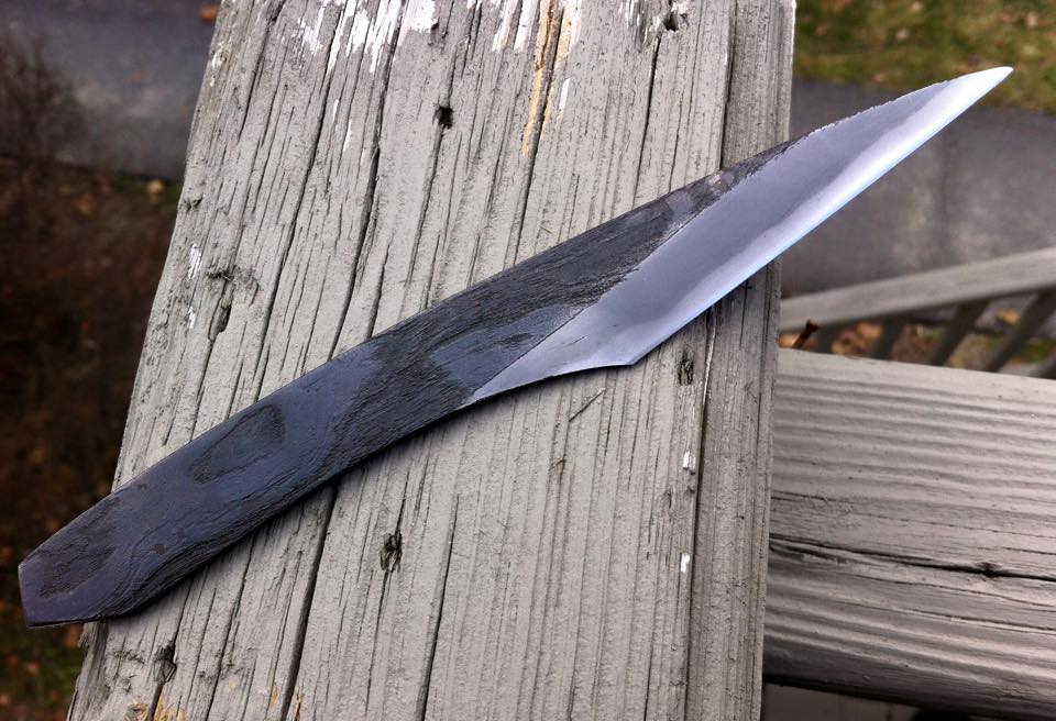

Hey guys,
I have a 1x30 harbor freight and I have used it before to do knife repairs such as this. I only used the grinder to remove metal, quick passes and water dunk and almost no heat at all was generated, and I sharpen by hand on stones as I run a small hand sharpening business in my spare time from home.
But I am now wanting to make my own knives. I have cut a few 3 inch pieces of D2 to make some chisel ground marking knives for practice before I attempt to make a kitchen knife with the 52100 I ordered. I took the "toolrest/table" off because it was annoying and am freehanding the bevel. I have ceramic belts in 60/120/220 grit and just ordered a few different 400-800 grit belts of different kinds to see which ones I like the best. Now on to my question.
I noticed I can get a bevel I am pretty happy with at 60 grit but when I try to use the higher grit belts my bevel is extremely hard to keep from getting faceted. At 60 I can keep them pretty straight. Here is the first freehand 60 grit bevel I ever ground.
This thing just goes so fast and hogs off metal in the blink of an eye. I put my fingers behind the bevel, kiss it to the grinder softly till I feel the bevel go flat and then start my pass. I cannot keep it on the grinder for more than 3 seconds without it burning me so I give it a water dunk and repeat. A bevel as wide as the one above takes me many passes, even though it is only 1 inch wide steel. Should I just keep my bevel at 60 and work on finishing it after heat treat or do I just need more practice? I'd like to finish the bevel at least at 220 or 400 on the grinder before I do my hand finish but after hours of frustration today it seems I cannot get a bevel I am happy with off anything except for the 60 grit belt. Out of 4 chisel grinds I was about to get one consistent bevel up to 220 and the rest I left at 60 or took back down to 60 out of frustration. Will it be easier to use the higher grit belts after I get them heat treated or should I just keep practicing until I develop more muscle memory?

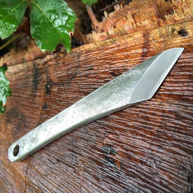

I sometimes find that when doing a small kiridashi-type bevel like you have there, it can be difficult to keep the bevel crisp and flat in the higher grits on the grinder. If you have low-grit DMT stones (I use the 120 grit lapping plate and up), it's pretty easy to polish little bevels. Then I go to water stones.
Those kiridashis are beautiful Tene. I'm basically trying to make a western version using only 3 inch of steel so I don't waste too much was I learn to bevel grind. I love my stones and have done many repairs on my 140x atoma (next stone up is a 500 Beston soaker and is a little difficult to remove the 140x scratches but not impossible) and planned to used it while finishing my kitchen knives after heat treat. I'm a big fan of Robin Dalmans work as his kitchen knives were part of the reason I wanted to start making my own and he also takes most if not all of his bevels from the grinder to a diamond plate to finish by hand. I want to make extremely thin kitchen knives with convex edges and planned to flat grind/heat treat/finish on a slack belt then go to stones. First things first, I need to get good on this 1x30. If anything it'll just make me better when I move to a bigger/slower grinder. I just ordered .125" x 2" x 48" of 52100 and if I can make 5 bunkas with 5 edges I am proud of I won't know what to do with myself. I'd just be too happy.
