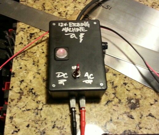

And someone had asked for a pic of my etcher, Strig I think... Nothing fancy... I use a lighted rocker in place of the usual neon bulb, and a 12.6v transformer where some use 24 (too hot IMO) but otherwise just a simple AC/DC unit. Long long leads as I use it as a plating powersource too. (And incidentially you can either use a variac in place of the transformer or a simple dimmer switch for variable voltage...)
