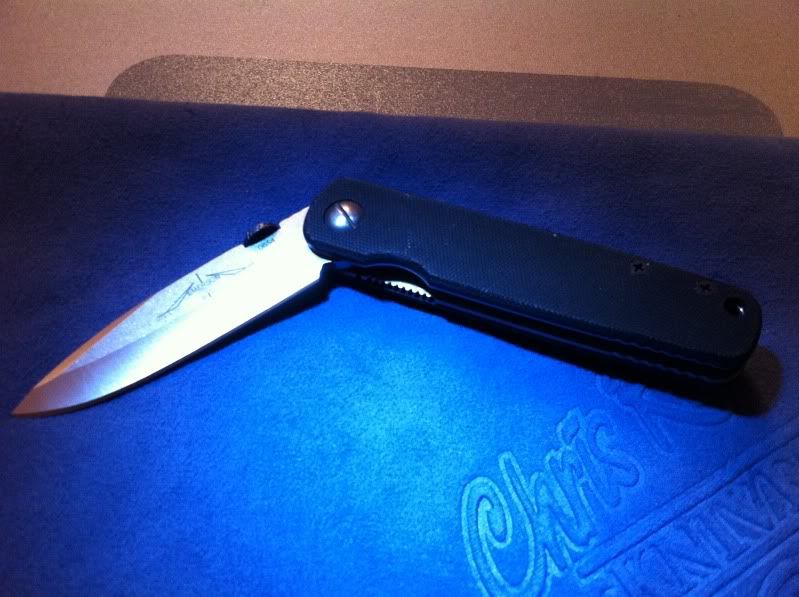

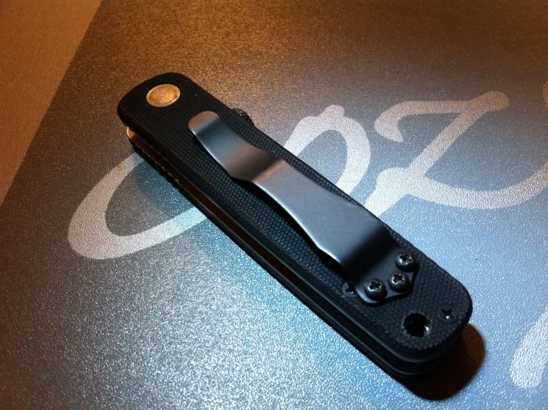

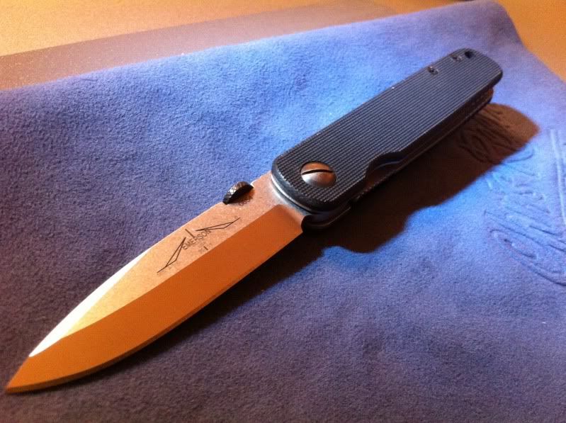

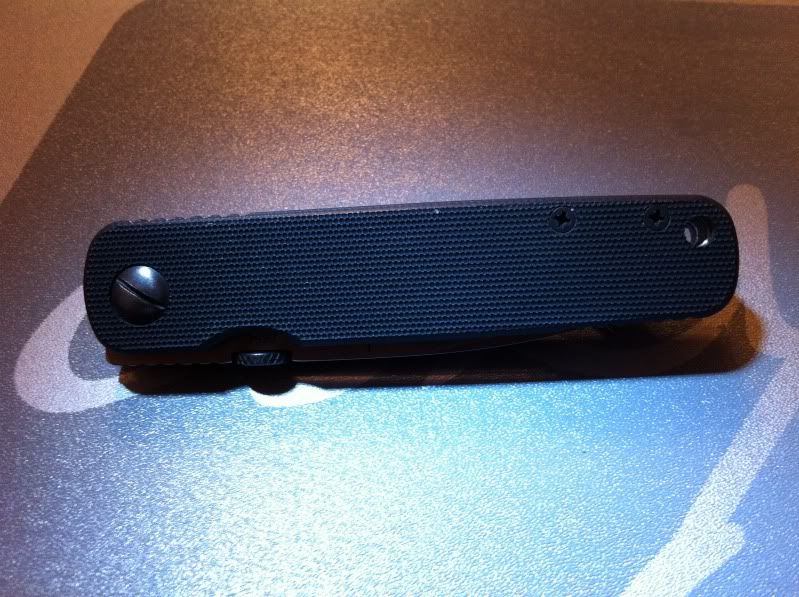

Just received my first Emerson; a Mini A100 satin finished. For some reason this knife spoke to me. The heft and solidity of such a small knife took me by surprise and made a positive impression on me. However, a few small annoying issues detract from the overall experience; i.e.
1. Loosening pivot screw after many deployments
2. Sticky liner lock
3. Serrations on thumb-release of liner-lock are too sharp for my tastes
4. Blade action is too tight where the pivot screw needs to be in order to maintain adequate centering and inhibit blade-play
5. Burnt electronic smell
A few other minor cosmetic flaws exist but were not unexpected based on reviews of other Emerson knives. Overall, the Mini is a great back-up EDC to augment my primary folders. At $160 plus shipping, I'm somewhat satisfied and glad to sample an Emerson product.

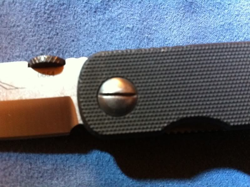

Initial Screw placement

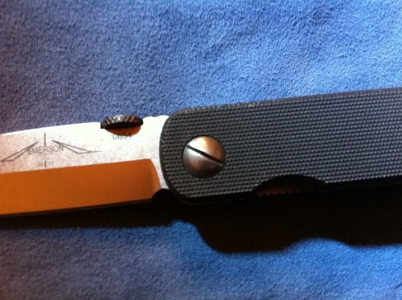

Screw adjustment after many deployments

The double detent appears to be only as effective as how much the pivot screw is tightened. Perhaps any credit to blade retention is attributed to the pivot friction. In any case, a hard shake akin to the mob rapping on your front door for their money will dislodge the blade with the pivot screw in the factory position. A light to moderate shake will unseat the blade with the pivot screw in the desired position for any kind of flicking ability. Both screw positions are depicted in the photos above from the initial post.

Update; the Mini A100's blade action has finally loosened after extensive usage and Loctite has secured the pivot screw. It has become my favorite sub three-inch EDC. I only wish Emerson placed the clip on the butt of the knife so that it rides lower in the pocket.
