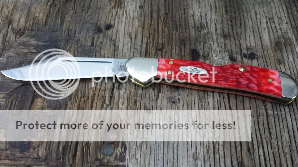

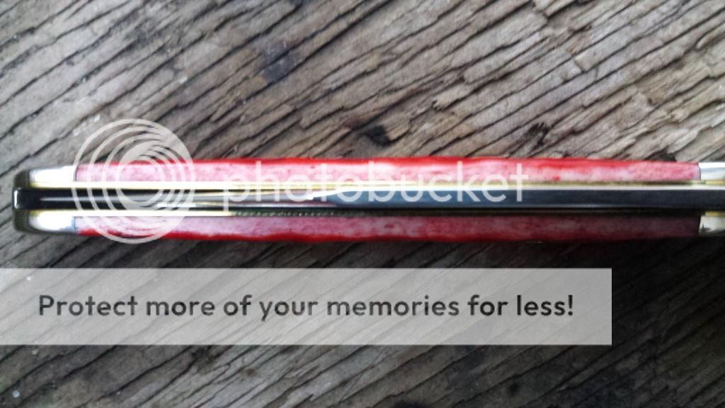

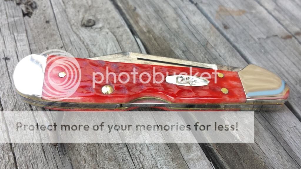

First off, let me preface this by sayin I do intend to carry this knife as a user, I'm truly not too concerned since it will be in my pocket alot. Now, that being said. I'm am a little unimpressed with the dye job on this one. The ends and edges of the scales seem to be lacking in the color department. Is this normal on bone scales? Is the white actually supposed to be red or is it just how these things are dyed? Overall I'm happy with the knife, blades pretty centered, locks well, pretty decent f&f, came sharp but it was a very toothy edge. I've got a few other Case knives with bone, never really seen this though. So what do you guys think about the dye job?

Not sure why Case is so inconsistent with their dying. :confused:
If that was my knife I'd be on my way to picking up some rit dye in red.
I'm just gonna carry it as is, like I said, it's a user so I'm not too concerned with it. Just was wanting some opinions on if this was normal. Sounds like case is inconsistent with their dying?

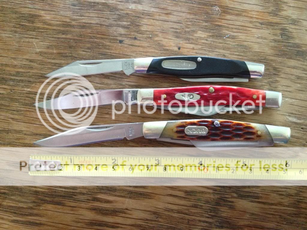

I had a similarly dyed medium stockman that I ended up not carrying much because of the dye job. So, I dyed it again myself and I was floored by the change!
It's bizarre, CASE often sends out this Strawberry Pink Bone with 'icing' edges claiming it's Red. Some people have said it's due to environmental regs about dye use. That cat won't jump as GEC puts out really nice shades or darker Red, Queen too. CASE's Chestnut Bone is beautiful, that doesn't have this slightly dipped look.
As Todd has just shown, some decent dye results can be obtained. I've used strong tea to good effect, coffe works too and colour dyes. will post pix later but got to run off to work, aaarghhh!:grumpy:
I could be completely missing the boat on this one, but it seems to me that in this case it's more likely a procedural problem than a materials problem. The places where it's white are all on the edges where the bone would have been sanded down during the hafting process. Seems to me like the dye didn't fully penetrate the bone. Either they're not letting the bone soak long enough, or they're not using pressure/vacuum properly. This is all conjecture on my part, and I could be wrong. Maybe one of our members that are more experienced in the manufacturing process will chime in with some more useful information.

Its classic case wishy washy dying- if its red call it red if it's strawberry pancake with whipped cream round the edges call it that.On second thoughts don't because who would buy it. Just lie and hope no one notices. Sorry to be harsh but not the first time its happened.

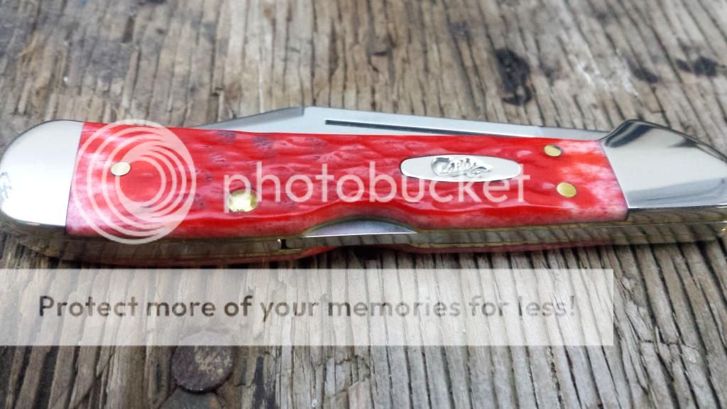

Here's after about 2 hours in some black coffee. Seems to have darkened it a bit. I think I'm gonna give it a couple more hours
