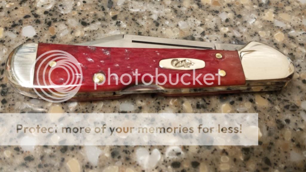

New Mini-Copperlock dye job
The inconsistency of the dye is one of my peeves with Case. I wish they were a bit more careful with the colors.
They can sell that "frosting" any way they want, but to me it is simply a lack of quality control. I went to a gun show a while back, and one of the vendors there had blue scaled CASE stockman patterns out. The variance was incredible. They went from a deep blue, thoroughly dyed, to a "blue berries and cream" which in my eyes was atrocious. He didn't care much, and as those that don't work with their hands as craftsmen often do, passed the inconsistent quality off as the result of being "hand made". Right.
Yeah it is pretty annoying. It's just something you wouldn't feel you need to worry about from a company with a reputation such as Case's. I'm hoping the coffee soak will darken it up a bit. It's in a cup on my tool box at work as we speak.
I like the dark red color they do on the pocket worn red bone knives, it has a brownish tone to it and I cannot remember seeing any on display with light spots in the bone. Several blotchy knives in the peachseed jigged red and chestbone bone though. The blotchy dye jobs look too pinkish to me.
Definitely looks better already. :thumbup: Maybe a little longer and you're good to go.

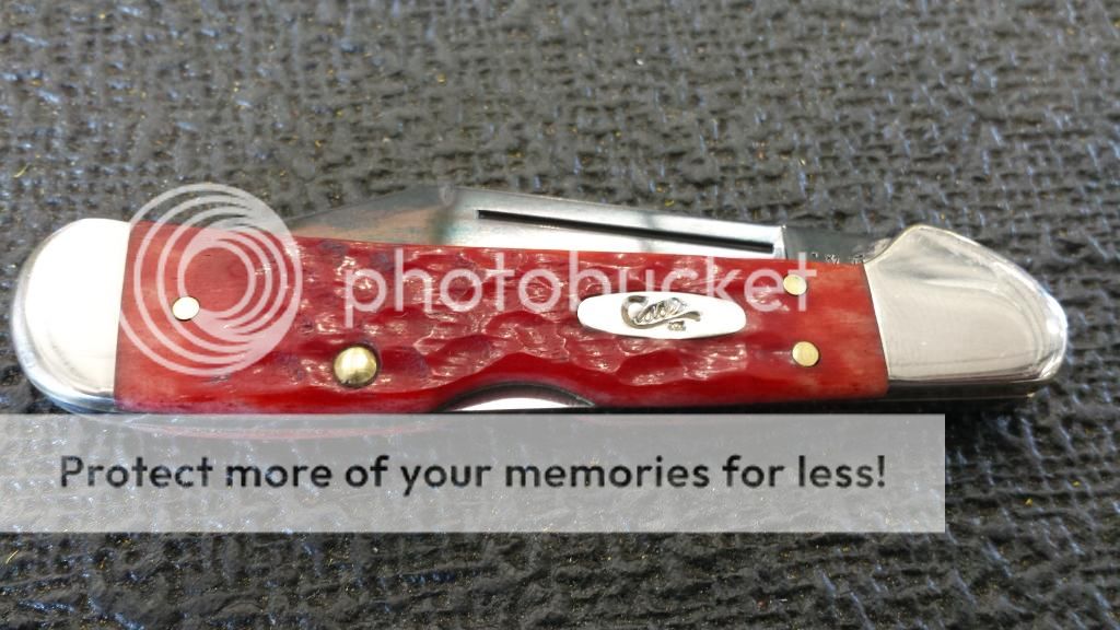

Well here it is after the tea treatment. I'm pretty happy with how it turned out, most definitely better than when it arrived! But I did notice that it made the scales swell up about 1/64th of an inch and they are now not flush with any edge. Hopefully they shrink back down without any damage done, I'm crossing my fingers.
Any thoughts on the swelling of the bone? I should have known it was gonna happen but dang it I didn't think about it. Will they shrink back at all? And if they do, will they pull away from the handle?
It looks much better, the exposed light colored portions looked as if they'd ground into undyed bone in my opinion. What I would do with the now slightly oversized bone, and you might not be able to do so as I have no idea of your personal abilities or what tools you might have, would be to sand it flush with fine grit wet or dry sandpaper. Start with 220 then progress finer, with like 320, 400, 600, 800, 1000,1500 and 2000, then put the finish shine back on the bolsters with a buffing wheel and rouge polishing compound. But I always keep various pieces of sandpaper around for piddling on stuff; a cheap buffing wheel that you can chuck in a drill or cordless drill and a bar of red/rouge compound will easily polish up the bolsters to put that last bit of shine back that even the 2000 grit paper can't. It would be a simple task, wouldn't take over an hour or so if you're used to working on such things.
