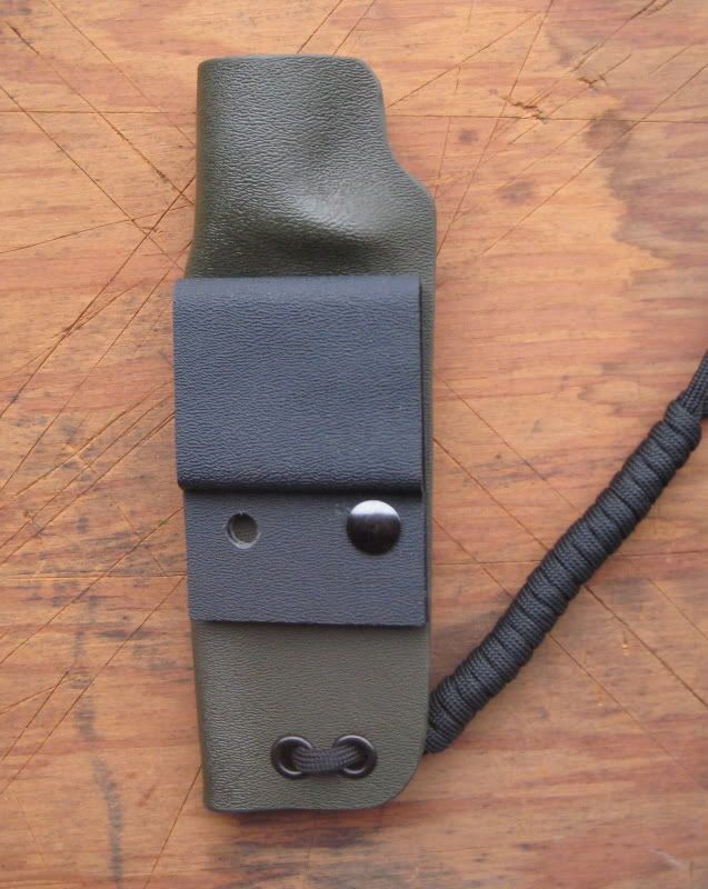

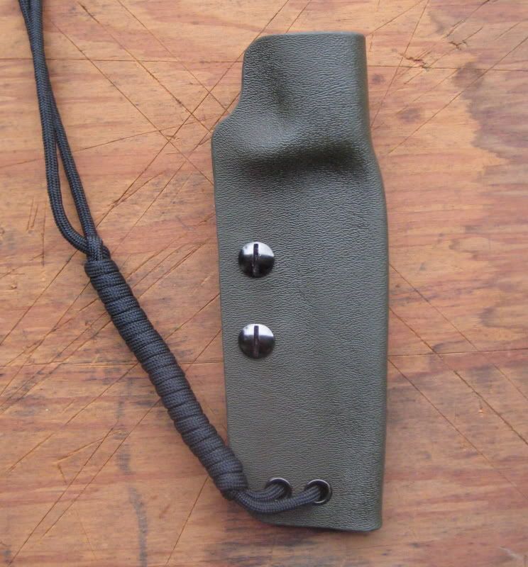

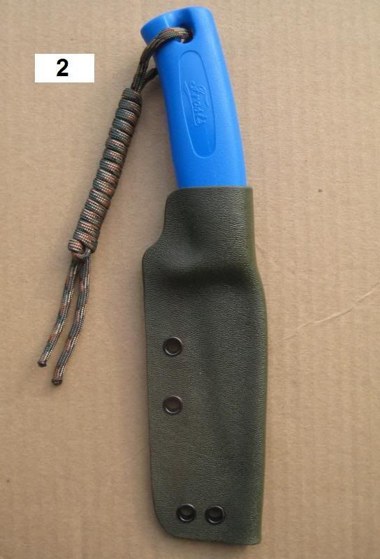

Very nice. Here's my own attempt at improving on the stock Mora 760 sheath:

Nice Kydex, Longbeachguy! Looks like you put a little effort into your edges.:thumbup: It takes a few more minutes but it looks a lot nicer than a belt-grinder edge with Kydex boogers filling the openings. I use a sponge-type sanding block after a fine file to clean the edges up - cheap and effective.
Thanks! Yes, I start with a belt sander on the edges then finish with 220 then 400 grit sandpaper. You pretty much get a polished edge after that.
