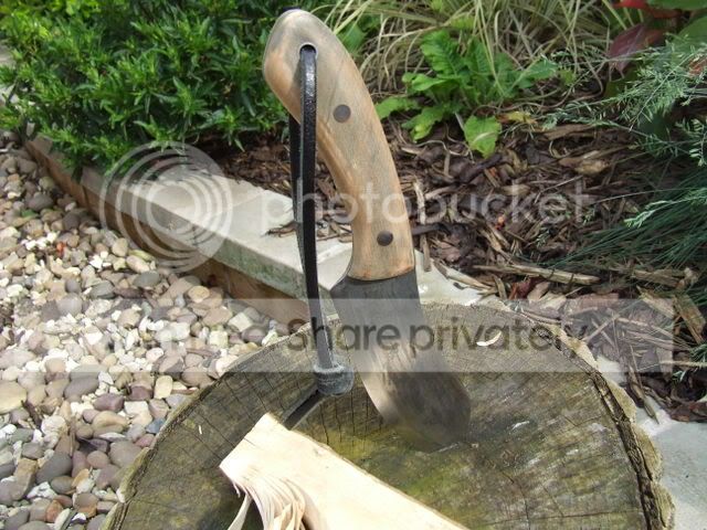

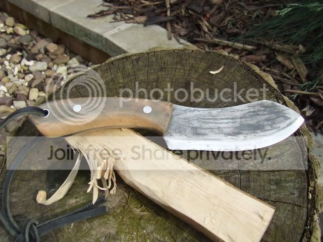

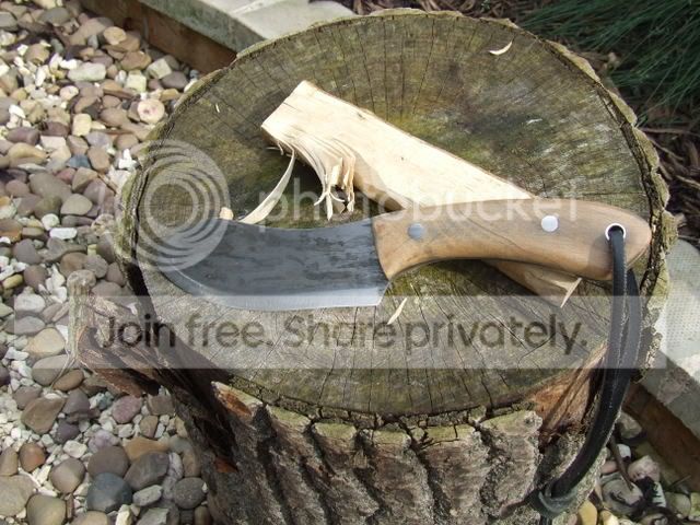

OK fellas i made myself another nessmuk the other day thought you guys might like to see it. its 01 3mm steel. lightly stained maple scales and the blade as a mustard and vinegar patina. let me know what you think. thanks for looking.
nice work. like the scales and the patina.
what tools did you use to make it?
Hi Siguy i used a little angle grinder to cut it out ,a little bench grinder to do bevels and shape the scales, a bench pillar drill to drill pin holes. heat treating is done with a propane torch and some thermalite blocks . any more questions just ask. cheers.
Looks good dude. :thumbup:
I really like the curve to the handle. Looks uber comfy.
That is one pretty and useful looking knife. It makes me want to start getting ready to grill on a open fire.
