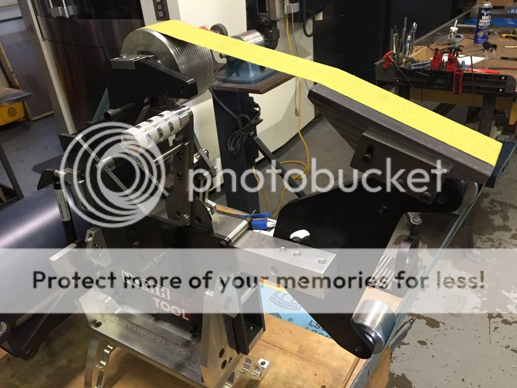

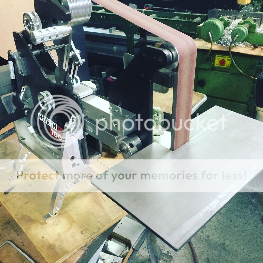

Sorry for the picture size, people keep talking about the gas shocks for belt tension being a problem, we have never had one fail yet, and that's with a couple hundred in use some by full time knife makers.

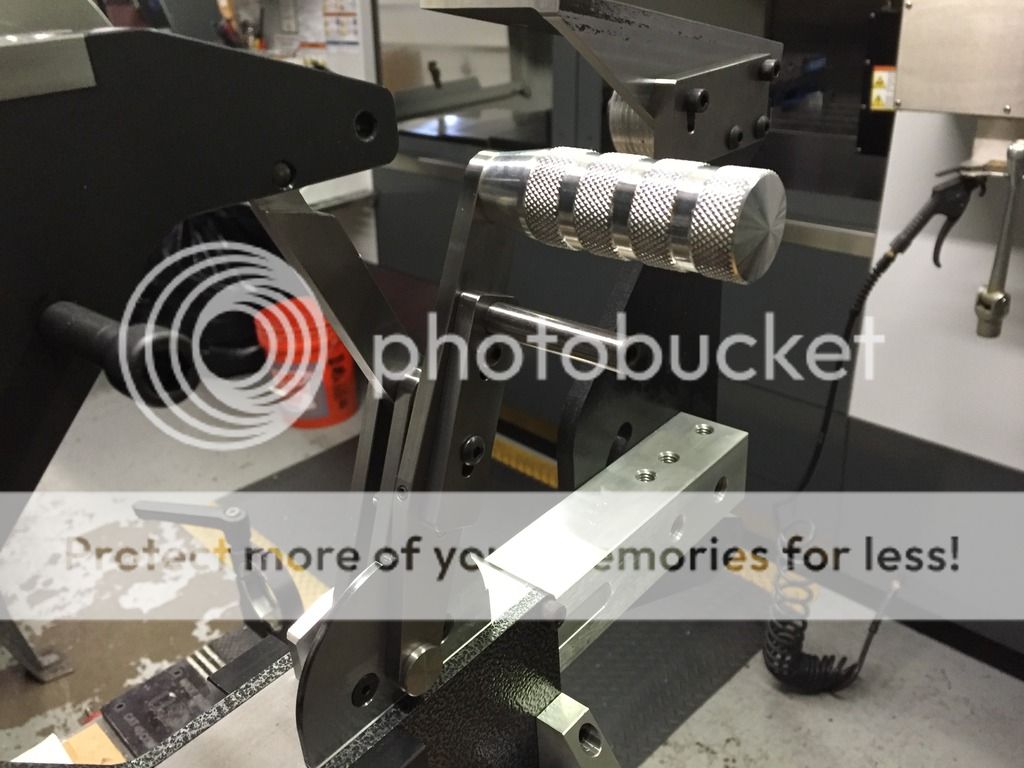

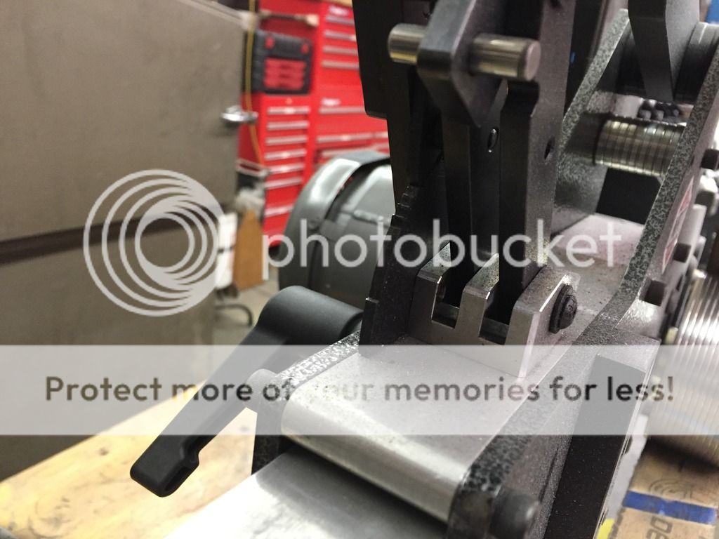

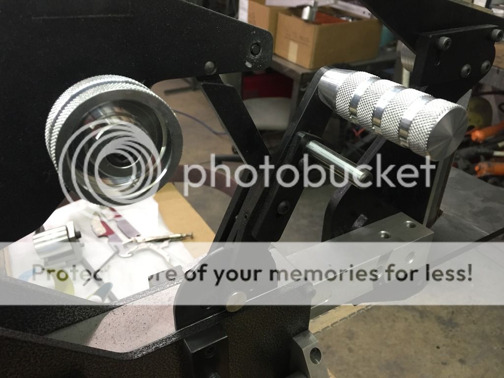

Because there was so much concern about them we made a ratcheting belt tensioner, the arms are 1018 the ratchet wheel and pawl are d50 it has mechanical advantage from the fulcrum point, so much so we put a stop on it, all the steel parts are black nitrided so you get corrosion resistance and they are 68-70c .008 deep, we machined pockets for the stainless spring and pins so everything is covered to keep it clean, it bolts on with the same mounting holes as the gas shock so it totally modular.

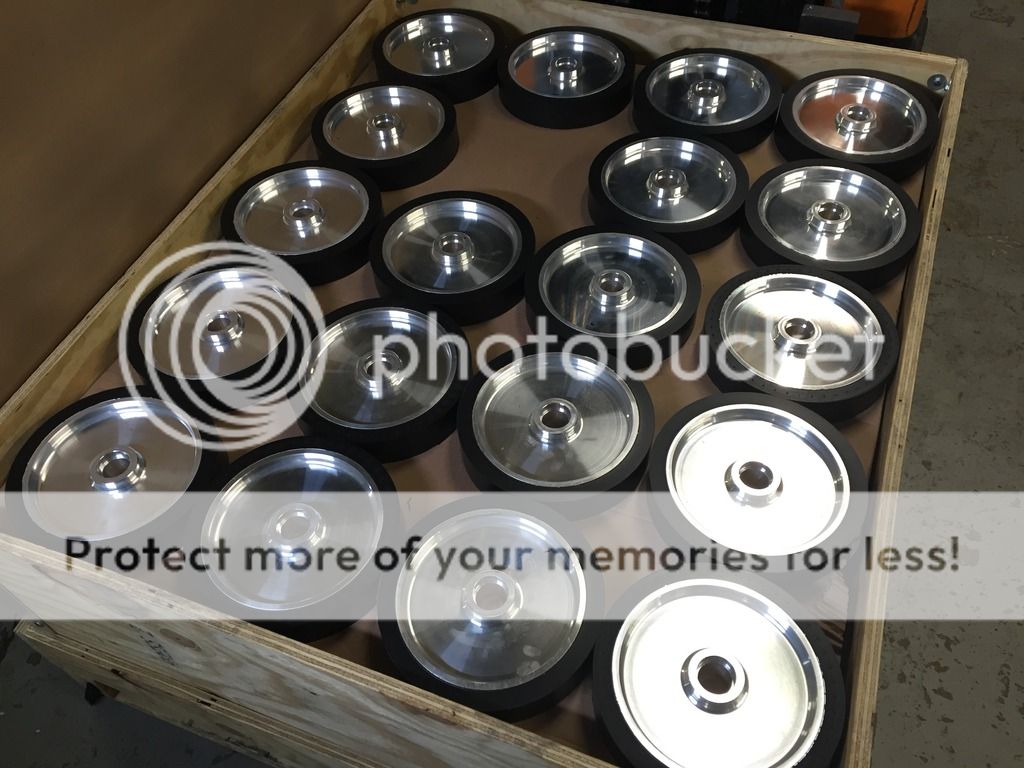

We do finally have our 10" contact wheels done, 6061 hubs oversized bearings 1/2 bore, spacer between bearings, 70 durometer peroxide cured rubber faces blasted chemlock primer and adhesive applied before molding, vulcanized at temperature with 500 ton molding press, then we grind the faces to make them truly concentric.

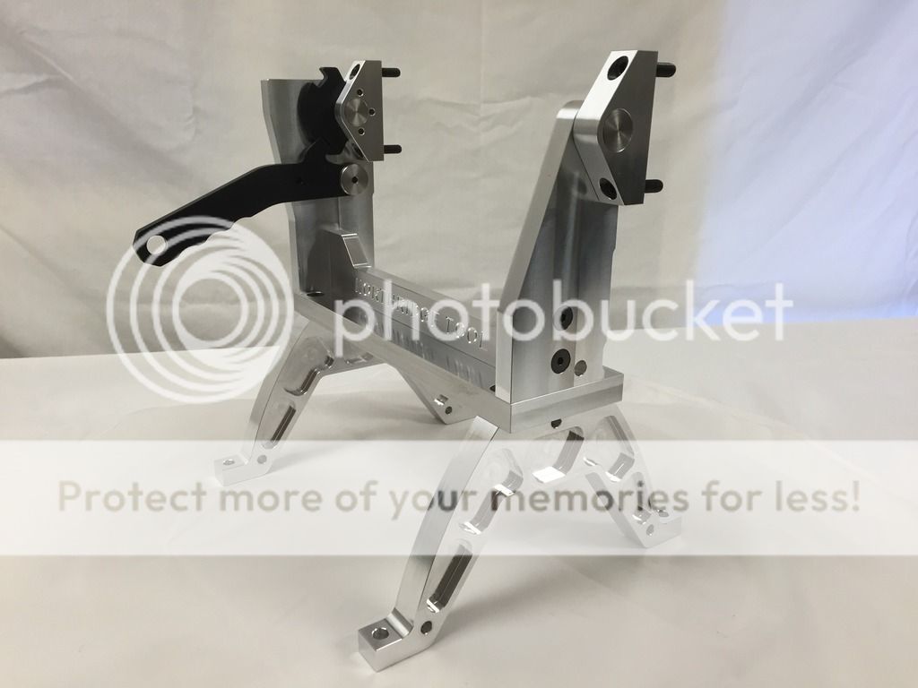

Our tipping stand does not pivot on aluminum, it has pressed in steel backed bronze Teflon bushings, it has stainless steel pivot pins, it also has steel backed Teflon bronze crush washers front and back so no aluminum is rubbing, the locking handle and locking receiver are cnc machined for a perfect fit black nitrided 70c .008 deep corrosion resistant, and stainless spring and pins are are located inside we pocket everything out and its covered so no grinding grit gets in.
Just an explanation of our pivot hinge.
