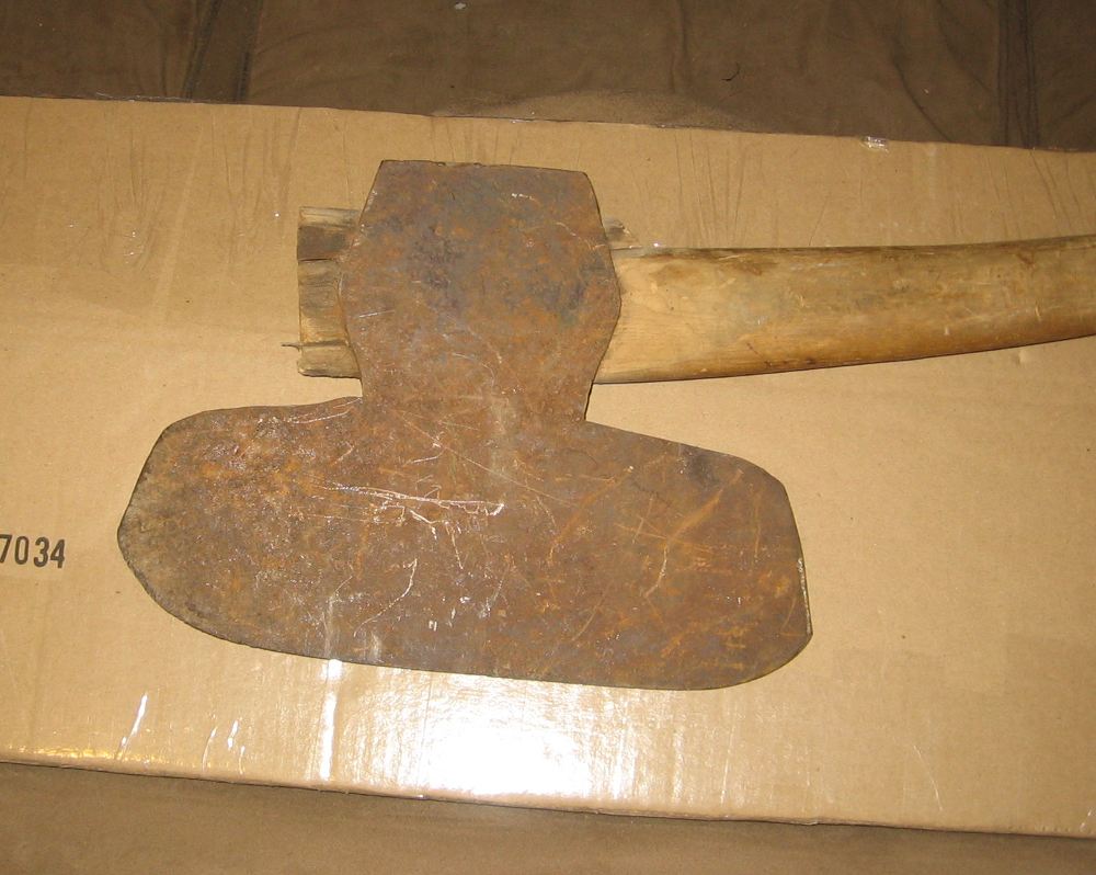

This is something I've wanted for some time. This one is old and rusty and needs a new handle. It's in what I would call 'used but not abused' condition. Under the rust is a nice hunk of old steel.
Edit: To see this axe hung see this other thread.
http://www.bladeforums.com/forums/showthread.php/935049-Making-a-broad-axe-haft
Here's the back side. You can see that the toe has been filed a few times. It's been used but I think there's still some life in it.
The poll has just a few minor dings in it. It doesn't look like it's been beaten on.
The length of the bit is 11-5/8". It's big enough to do some real work without being too unwieldy.

The depth of the eye is a substantial 4-3/4". It's enough metal-to-wood contact that it should stand up to punishment pretty well.
I'll restore it at least to good usable condition and I might even polish it up a bit.

I cleaned this axe up today with a brass wire cup on an angle grinder. The brass wire removes the rust without removing the patina. Here's the front side.
And here's the back side. There's enough pitting that this axe will never be a show piece but it's still going to be a fine user.
Once cleaned up I noticed that a forge weld is visible just beyond the eye. So this eye was forge welded rather than being punched and drifted.
This is an old one. While it may have been done with a power hammer this axe was certainly forged by a blacksmith. There's no logo on it, just an '8' (weight confirmed by bathroom scale) and that little mark at the bottom of the poll next to the eye.
To make this a decent usable broad axe I need to clean up the working surfaces, those that contact the wood. That means the flat back side and the edge bevel on the front side. The back side will have the most wood contact.
I started by flat filing the back from the edge to the eye. As soon as I a put the file to it the high and low spots immediately showed.
The low spot on the left tip is an area where the blade was slightly bent. I debated about how to deal with that. Filing it out would take too long and remove to much material. But if I heated it up to forging temperature to straighten it then I'd have to re-harden and temper the whole edge.
I decided to try to peen the edge back straight, much as one would peen the edge of a scythe. It's a cold day here in the NW, close to freezing. I didn't want to risk chipping the edge so I warmed it slightly with a propane torch. Not hot enough to temper it - just warm to the touch but not so hot that I couldn't keep my fingers on it - maybe 130°-140° F. Then I gently peened it back straight, working with the closed jaws of my vise as my anvil.
As I continued flat-filing the back I noticed a line begin to show, separating the carbon steel bit from the lesser steel or wrought iron body of the axe.
Then I honed the edge with a Norton stone, touched it up with an EZE-Lap diamond hone and gave it a couple passes on a steel. While wiping the finished edge clean I accidentally got my finger a little too close to the edge. It cut me like a razor.
It's ready to be re-hafted now.
