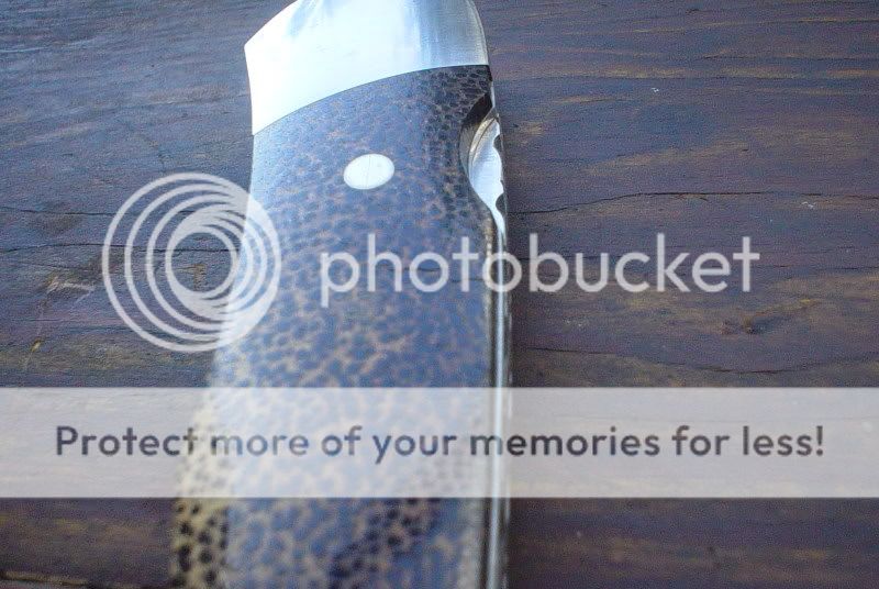

I just picked this Les Voorhies knife up from Bladeforums classifieds, and I am really fond of this knife already.

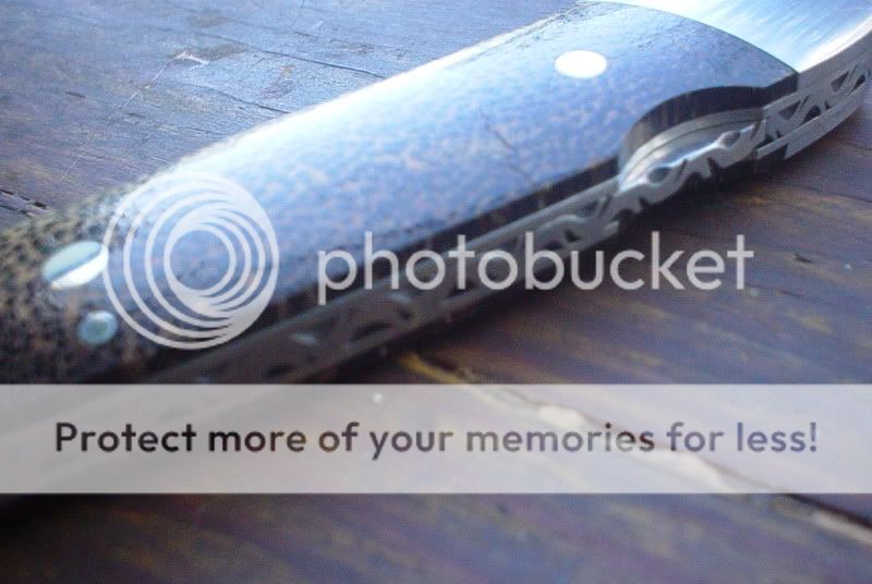

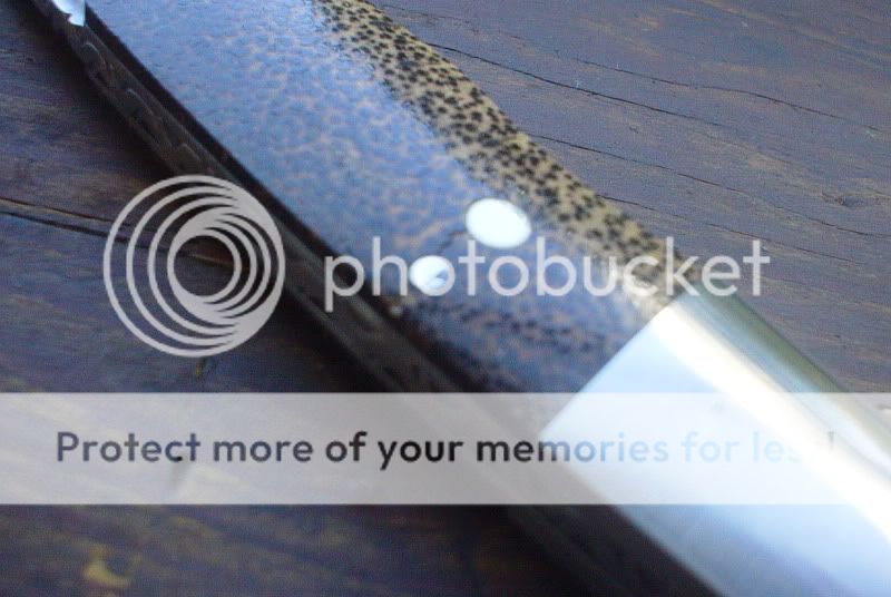

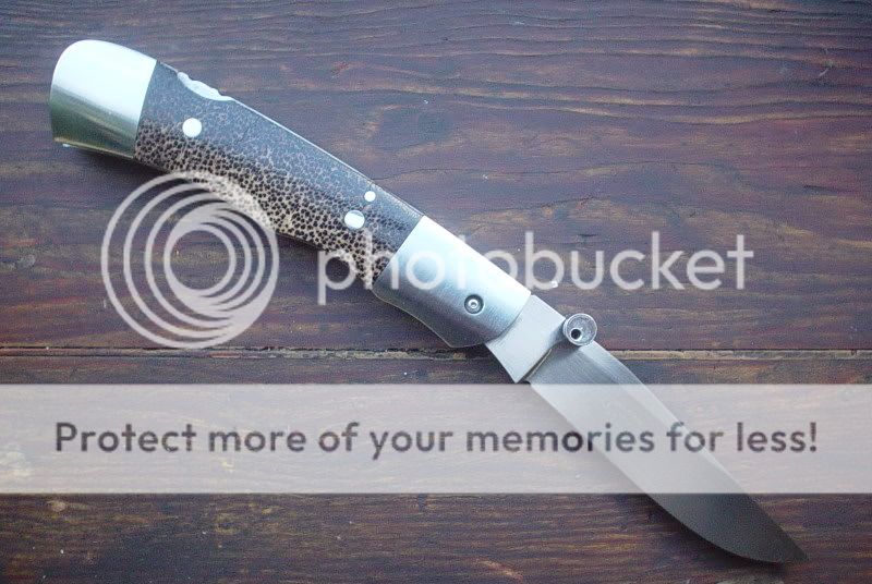

I made that knife in the late 90's (97ish maybe) and took it to the Badger show in WI., when I put it on my table I noticed that the handle material had small cracks in it so I decided not to put it on the table. A dealer (Bob Wolf) came by to see what I had and after making his purchases I showed him the knife and what happened to the scales, he asked me what I was going to do with it and said he'd like to have it for a carry knife. I sold him the knife cheap with the understanding the he keep it for his own use, 3 hours later someone came by to show me the knife they had just bought.... it was that knife. I learned a lesson about selling seconds, on the rare occasion I have one, I don't mark them anymore :)

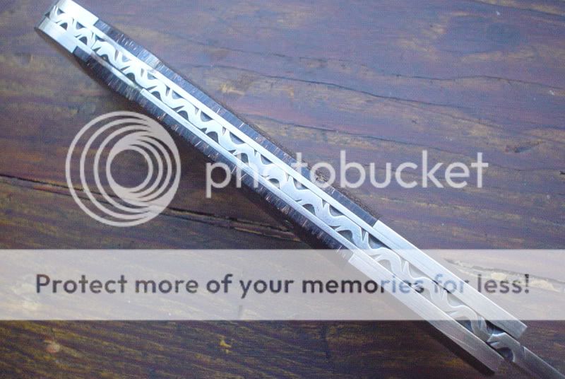

The blade is ATS34 and the liners and bolsters are probably 400 series stainless, the thumb stud was added by someone else.
I hope that helps, I'm not sure how close I am on the year I made it, it was just before I started making liner locks.

Neat story, but what kind of handles are those. They remind me of some kind of fish looking skin or something.
the scales are made from palm. Beautiful, but accustomed to a humid tropical environment, hence the shrinking and cracking.
The thumb stud that whomever put on looks to be the "One Handed Bandit" that used to be sold to put onto traditional lockbacks like the Buck 110.
Just to be precise, the scales are black palm. It happens to be my favorite wood so am rather familiar with it.
I've owned many, many knives with black palm handles and black palm scales and none were ever highly subject to expansion and shrinkage. The material is extremely dense and if, say, one was making a decorative box, one would find the material very difficult to work by hand.
That said, much of what I owned was stabilized. That always helps. But when dealing with pin placements, the inevitable can eventually occur if the pins are that close together, ie, a crack now and then. The button size also plays a part in the density issue.

...and MORE specifically, that is "end grain" black palm. It is a VERY porous wood and checks miserably! Stabilization is mandatory if wanted to last for knife scales.
Those little black specks are fibres (not the botanical terminology) that run longitudinally. It is VERY cool looking wood, but presents challenges working it.

Dunno if she'll ever go back for new scales, but the more I carry er, the larger the cracks get and little pieces are falling off near the cracks. I love the look and texture of this palm wood regardless.
