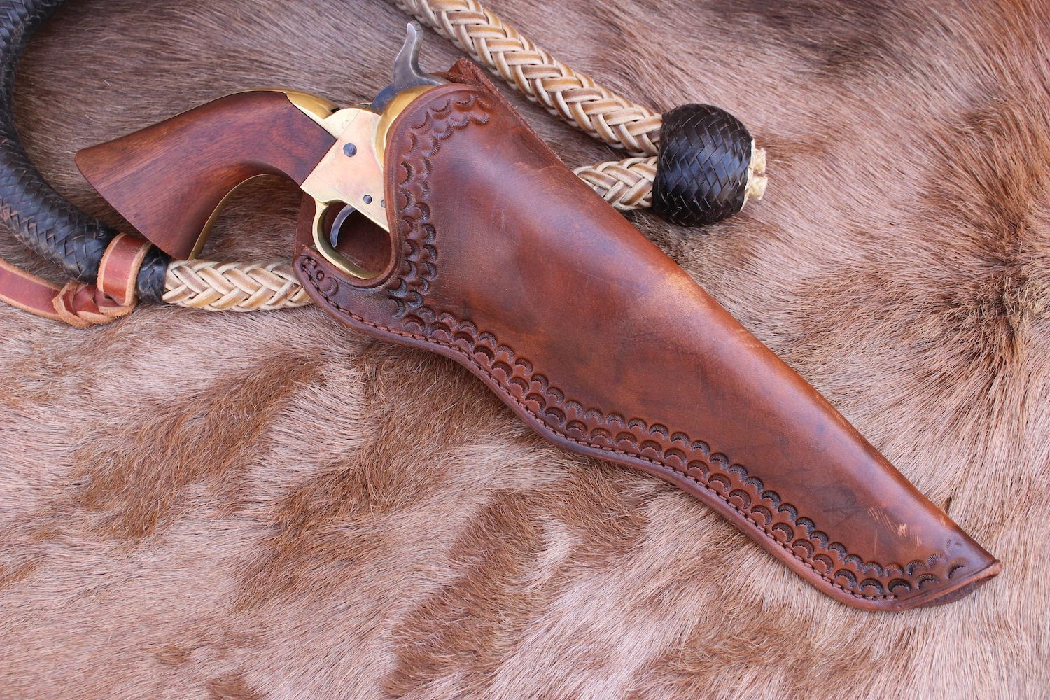

Busy day in the shop Monday. I made two rifle scabbards and three holsters, so I guess it was gun day. One of the holsters was requested by the customer to have a special finish. First time I'd ever tried this so I thought I'd share with you and see your thoughts. The customer, a close friend too, asked that the holster look like it came out of the 1860's. Not just the style of holster but that the finished holster literally looked 150 years old. I asked him if he wanted me to drag it behind the truck for a while....
This style of holster is called a California Slim Jim. It originated with some of the early saddelries here in CA and has been around ever since. Originally made for Cap and Ball revolvers it worked so well that it made the transition to cartridge guns. Its pretty versatile and can be worn crossdraw or on the strongside. The dark brown one is the one I made to look old.
Here is a close up. My friend was really pleased with how it came out. Whadya think? This is taking antiquing to a whole different level.

One thing I've been playing with is to lightly wet the leather, wrap it in plastic wrap, then lightly press it against blacktop or something rougher depending on how much effect I want. I press down in a couple of random places. After antique it looks pretty cool/distressed. Thought about making a stamp for this, but it's pretty easy to do on any rough surface.

Strig pretty simple, Scratched with my finger nails before dyeing. Then tried not to get the dye job too even on purpose. Then some flexing after dyeing to get some surface cracks going. Coat of finish and then hit it with a sponge sanding block. Then oil some of the scuffs and finish over the top of others. High Liter in the stamping but not even and wipe away immediately. Another coat of finish and while its still damp a little more sanding and the gouge down at the bottom with a rat tail file. The temtation was to do too much abrasion and scratching. I googled lots of pics of originals and kinda looked at wear and tear on them to see where it was.

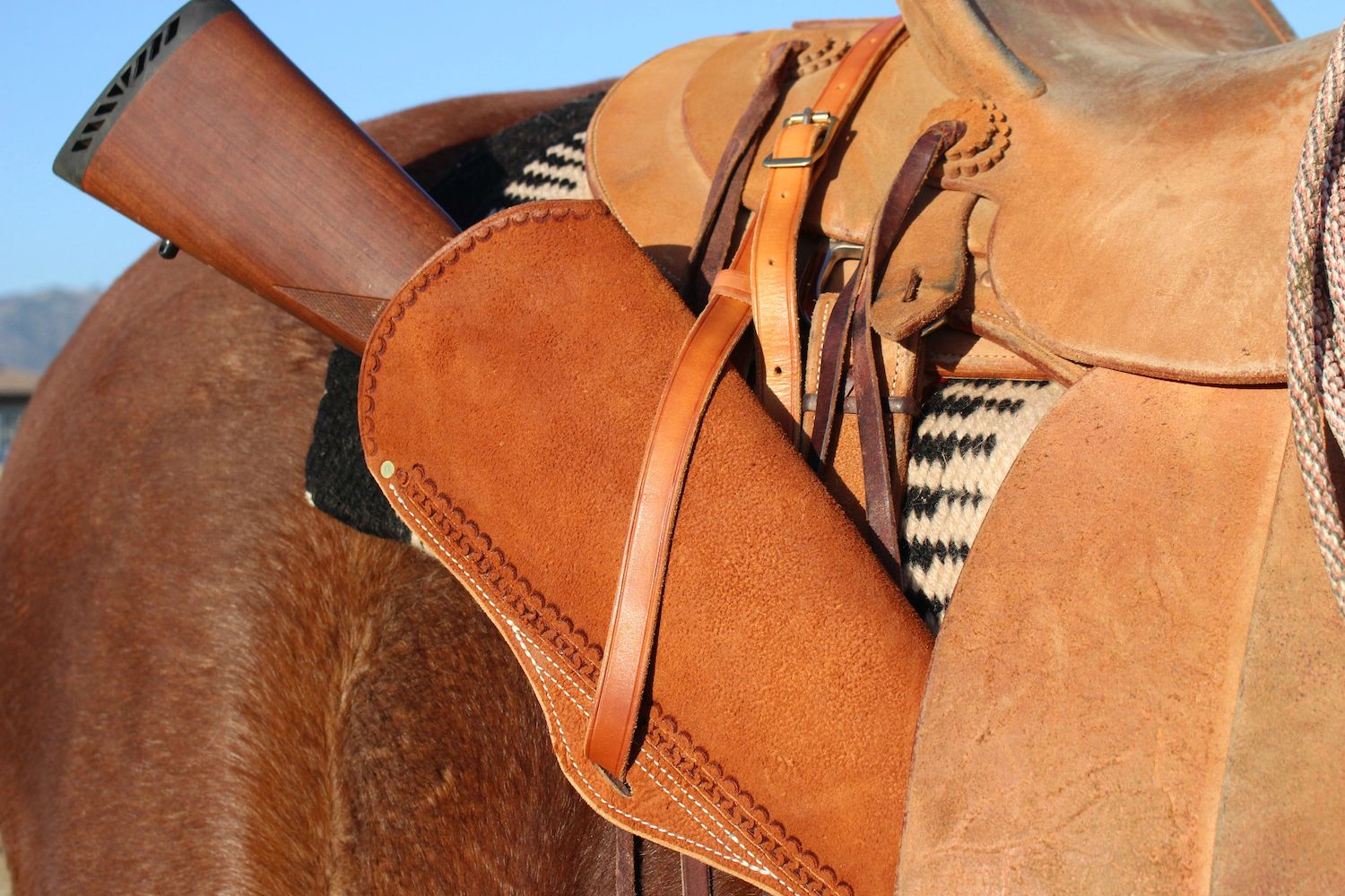

Kaiso thannks. Could do the belt, the boots would be past my pay grade. Better show you the scabbards cause its kinda like your left handed sheath.
So I cut out this scabbard and then look at the order form. Rough out, no biggie, turn it over and !@#$%^&. Thats the one spot where Wicket and Craig decide to mark some code in silver paint on this side. !@#$%^&. So I cut out another one and build up both.
So here's the roughout one to fill the order. They are identical except one is roughout and the other is smoothout. Shipped the roughout to the customer. Guess its always good to have extra stock. Well it was Monday have to screw something up.

Thanks Macan. I too just like that color. Oiled leather to me just looks like..... leather and exhibits all the qualities that we like leather for. Thats all I did to the rifle scabbards or the non antiiqued holster. Just a coat 100% neatsfot oil warmed up. then a coat of finish on the smooth ones. Nothing on the roughout scabbard didn't even rub the edges much.
