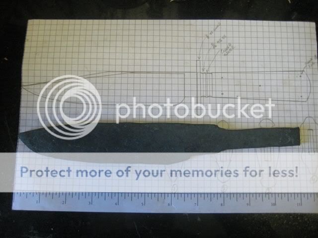

I've grown particularly fond of the cowboy style Bowie knives. The straight handles and smaller blades just seem very practical and conjures up images of the old west. I've been looking at Tommy Gann's work for awhile and really liked a piece he had at the 2008 Blade show and wish I had bought it. His work is very clean. Long story, short....this is a design we worked on and he is almost finished. He's also making a Spanish style sheath to go with it.

Blade rough forged

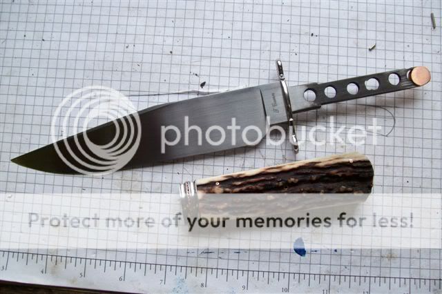

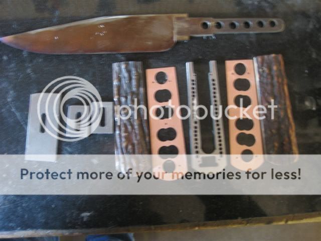

All the parts rough cut and milled and blade after it has been heat treated and tempered

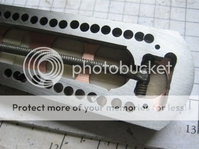

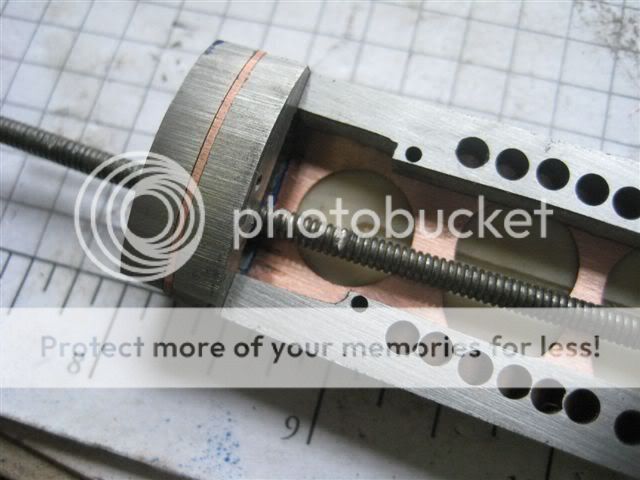

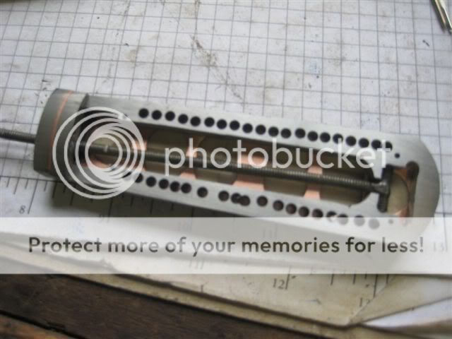

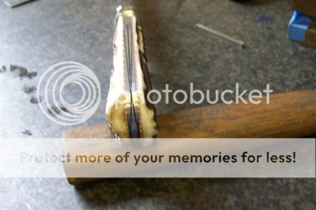

The frame construction . you can see the frame has been milled and holes drilled to lighten the knife the liner have been lighten to .i my need to remove more to get the right balance. i put the hole handle togetter with a rod and grind the stag and frame so they match.

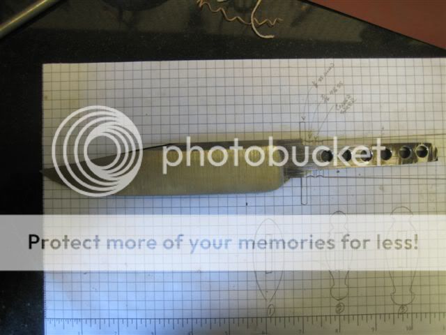

Blade rough ground. hole have been put in before heat treat to remove some of the handle weight

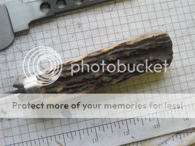

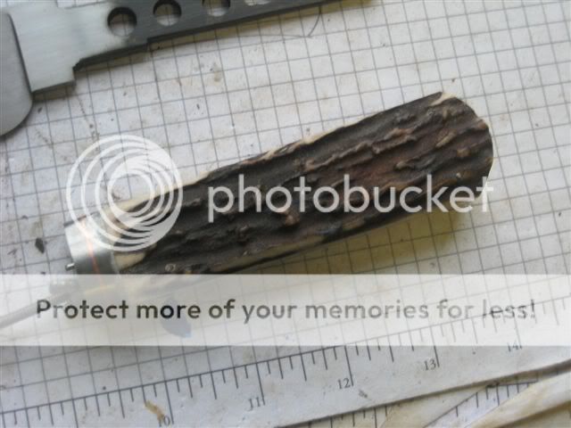

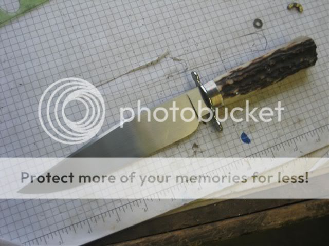

The blade is sanded to amost finished and the guard has been fit to the blade and rough ground. the stag has been sanded to match the spacers and ready for a dry fit.

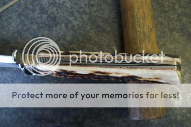

Pics of the stag on both sides

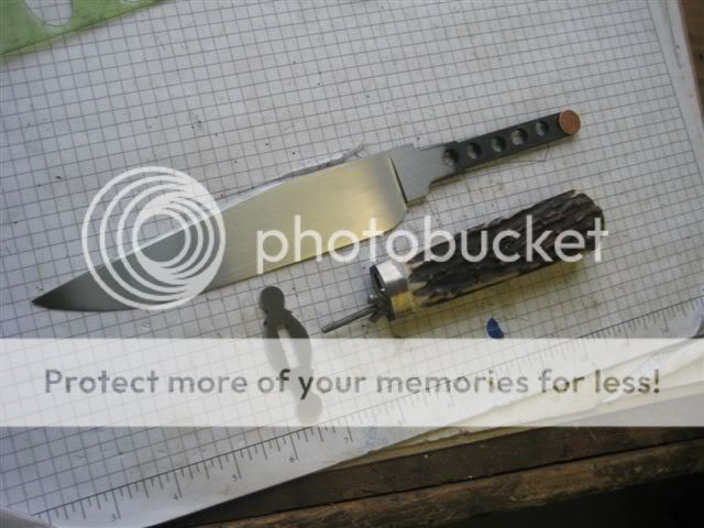

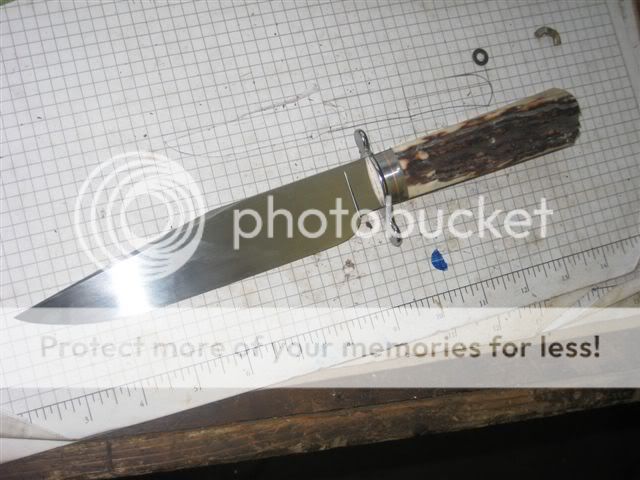

I will dry fit the knife to check the fit to the gaurd and the alignment of everything before I start to file the frame and spacers

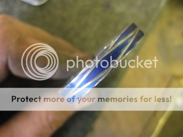

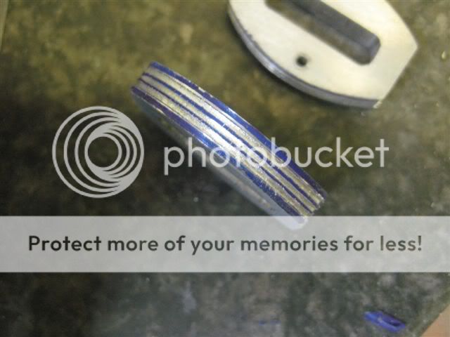

Layout of grove for the spacer i will leave a 30th's of space on each side and file a 1/8 groove ,sand and polish

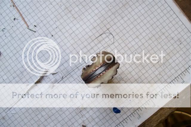

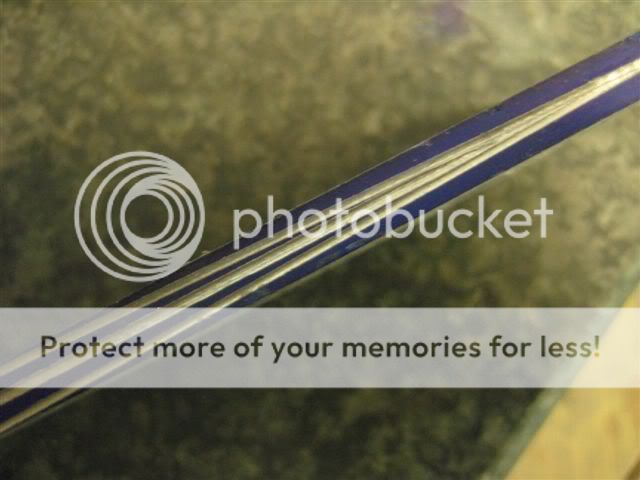

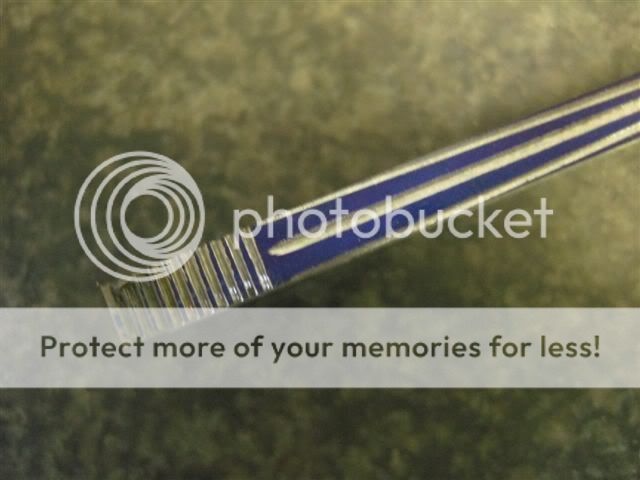

Layout the frame for the pattern, cut the lines in with a cutting wheel on the mill and a checking file and get ready to blue the cuts to see the pattern

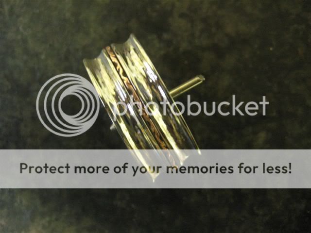

This is the spacers after they have been filed and polished

construction looks great, but the choil/ricasso region thus far looks poorly defined and ambiguous.
What does it want to be?
Best Regards,
STeven Garsson
choil does look a little funky, but a great looking knife otherwise:thumbup:

Stag rough sanded to the ferrule / spacer both sides
Fit one more time to make sure it all good before filing

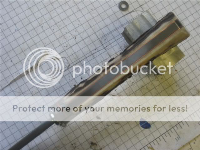

Frame was blued to enhance the details of the frame
Knife is ready to be glued. I put 1/50th copper shims on the sides of the tag to help keep the frame straight/parallel with the blade when glueing
After the knife has been glued

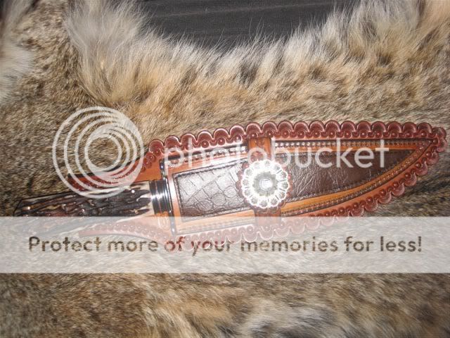

Knife & sheath. Sheath made by a friend of Tommy, Bob Bobbitt who is a cutom saddle maker. It has 3 small screws in it so that it can be removed from the back flap and be cared like a belt /belly sheath. The sheath has a sterling silver concho and gator skin overlay.
Thanks Tommy and Bob,
Bob
That turned out great, didn't it, Bob, and the sheath goes right with the Cowboy theme.
John
Thanks John. I may have it in time for the Little Rock show. We'll see ya Friday.
Bob
Congratulations Bob on a extremely nice Knife and Sheath package.
I'm wasn't surprised at all to see that spectacular sheath.
That turned out very well indeed. Knife and sheath combine for an impressive package.
