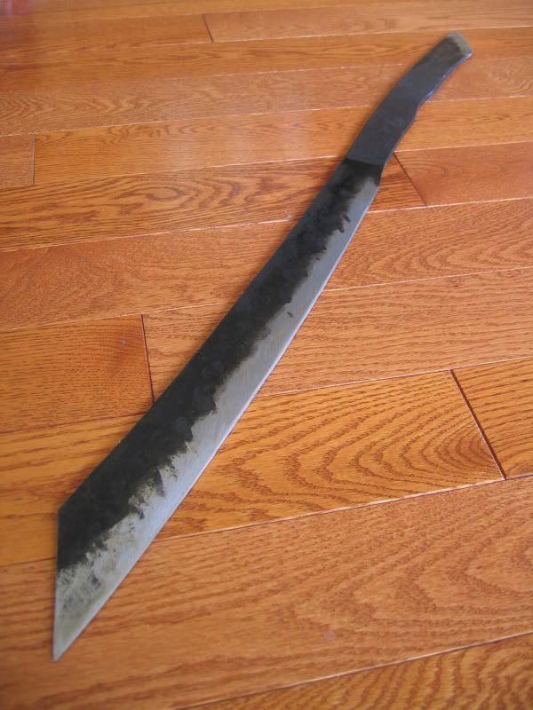

Parang, Bolo, Machete.... whatever, it's big.;)
As usual I jumped the gun before making a sheath... lol.
The Marchete
5160
18" cutting edge
9" handle
28" overall
5/32" thick at ricasso tapering to 1/8" at tip and butt of tang.
Handle is hickory with hemp wrap, soaked in epoxy.
Here is the Marchete at different stages of completion...
Concept drawings... I went with the Tai Goo inspired bushblade shape...
Rough forged..
Handle wood and size reference..
After clean up, heat treat and rough handle fitting...
Just about done... It still needs a final sharpening and perhaps a design on the butt of the handle..
Sheath still to come.....

Can you make something just a little bigger??
Rick your handles are looking very sharp. The wrap looks great and the Celtic knots really work.
I like this one a lot my friend.
Rick, it's awesome! Kinda like what I think you'd come up with as an interpretation of a "cloud cutter"! :thumbup:
that is sooper cool!
Great Work!
That is one titanic piece of steel. That is a keep the trail open kind of blade.
