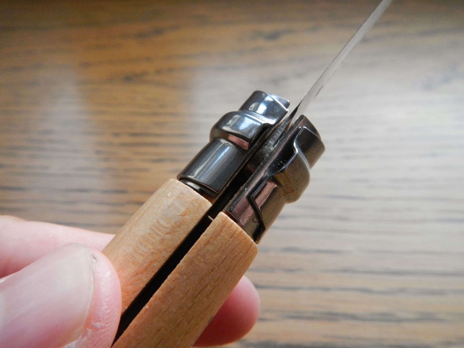

I think some of the criticism of the "new" lock ring is an overreaction. I have some new Opinels with the new lock rings. I have not modified any of them. And they are all very secure and solid. No blade play in any direction, and extremely solid lock up both closed and open. Here is a pic of a #6 and its lock ring. Would I trust this lock with my fingers' lives? No. But that would be true for any folder. BTW, the larger knives in the set in the background (the 9, 10, and 12) have the old lock ring. And I don't perceive any noticeable difference in security. Whatever the case, the Opinel lock ring, both new and old, seem fine to me, and are probably more secure than a lot of the frame and liner locks on really expensive modern "tactical" folders (e.g., ZT :D)
