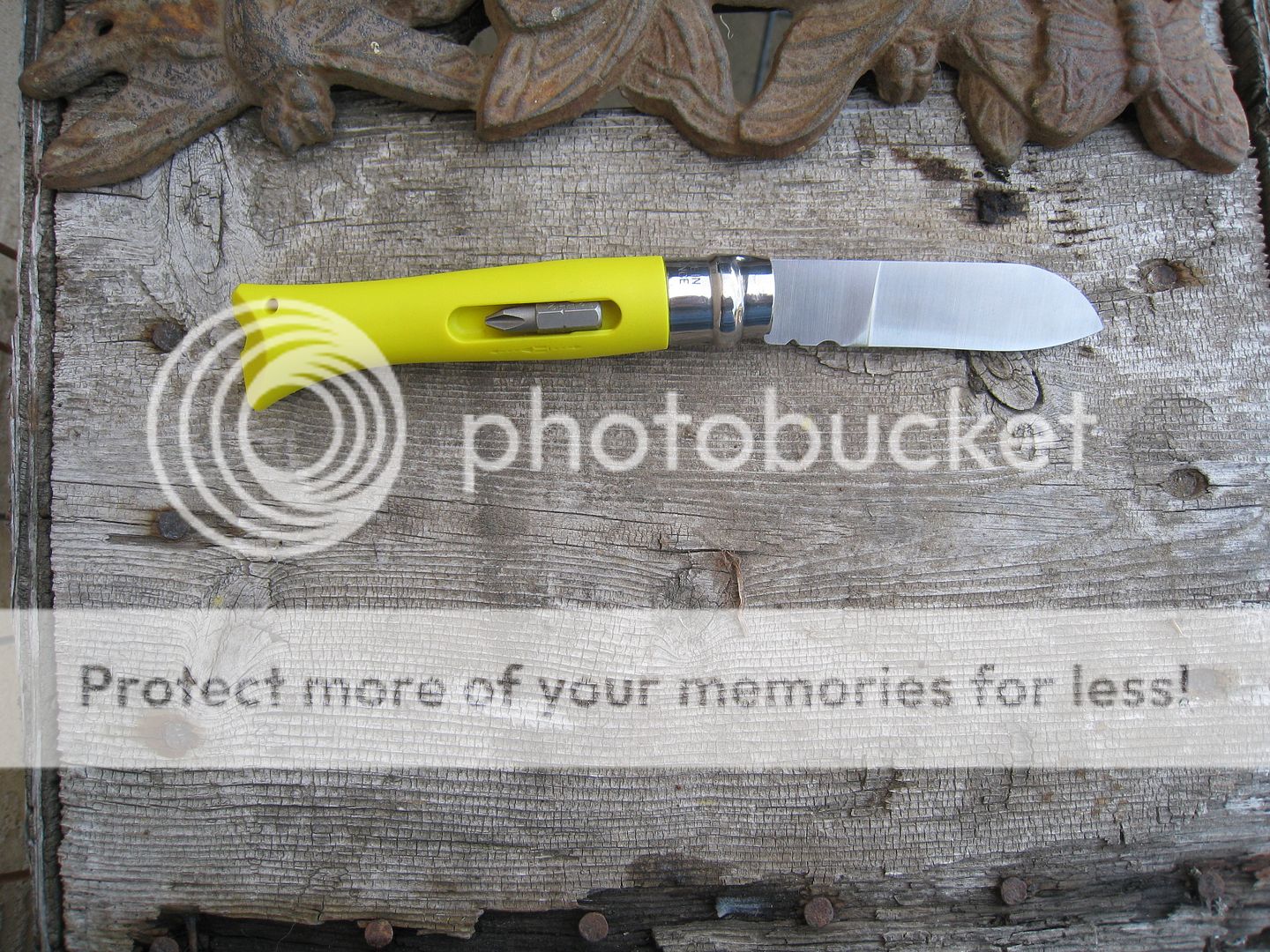

I'm one of the biggest Opinel supporters around, but I am totally uninterested in that new model design. Sorry.
I have an Opinel DIY, a gift from member ScruffUK. I find it a big large for front pocket carry. It is, after all, a number nine. But I mostly wear carpenter jeans and the #9 fits nicely in the leg pocket.
I found that the screwdriver bits work well. You can get pretty good torque on the handle, though you have to avoid tweaking the blade. I found that the position of the bit in the use position at the base of the handle gave good access to screws. It's almost like having a stubby screwdriver, but with a large, hand filling handle. When in use, a magnet holds the bit in position. In the stowed position, the bits are very secure, as they are wedged into position. Loss of the bits seems unlikely to me.
The blade cuts like, well like an Opinel. Takes a very fine edge and slices well. Opinel runs their stainless blades at ~58HRC. So, the steel hardness and composition are a close match to Buck 420HC.
There is a wire stripper notch and a wire cutter notch. The cutting edge starts beyond them. This means that while the blade is ~3 1/4", the cutting edge is ~2 1/4". I have not found this to be a hindrance in daily use around the house and in the back yard. While I have not used the notches on wire, I have found them to be useful for cutting stringy vines, the kind that have tendon-like threads in them. Also good for trimming minor branches in the garden.
I like the blade shape. I suppose I don't really need the wire notches, but I don't really object to them either. They do come in handy for some chores.
All in all, it's a "do-it-yourself" knife. It's designed to be carried and help with chores, as opposed to being an outdoorsman's knife per se. Since helping with household fixits is the major reason I carry a knife, this is a good fit for me.
I like it. YMMV.
Here is a view where you can see the start of the cutting edge...
