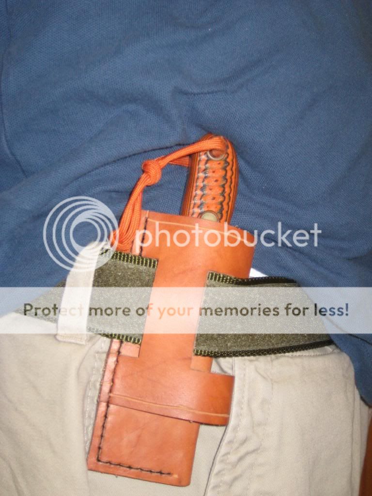

So I decided to make a new sheath for my GW.
10-11 ounce leather from Tandy.
I made a square sheath. Wet molded it, and then glued it up, and stitched it up.
Used a H-strap style design, which allows horizontal or vertical carry, on either side, front or small of back/behind the hip.
I still need to sand the edges and soften them out a bit. I am visiting family, so I don't have my sandpaper/ belt sander here.
some on the belt
you can carry it tons of ways, front back, vertical, horizontal, over the belt or under the belt. Right or left side. Front of waistband, or small of back horizontal.
Oh, I forgot to mention, this is my second sheath ever. And I still have a bit of finishing left to do on the edges when I get home, and also I messed up with the two grooves on the H strap. I tried to groove it after being stitched on, and you can see were I messed it up.

It is more comfortable than my tech lock sheaths. Those tent to make my belly sore after a day of sitting with the sheath on horizontal in front.
The only down side, is I have to undo the belt to take it on and off, which the tech lock makes a snap.

You could always throw a couple snaps on the loops so you can slip it up thru your belt and snap it for horizontal carry.
I was thinking that last night. I need to get some heavy duty snaps and snap setters, etc.
I think the next sheath I make will be a pocket clip version, so I can clip it in the front pocket so the handle shows. That way I can carry my SS and not worry about it being too long to cover up.
