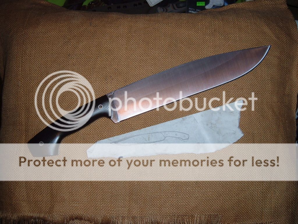

I went looking for a lost tool on a low, dirty shelf in the shop and found a small picture I had drawn sometime in the last two years. I found my tool, finished my project, and grabbed some steel :) Not sure what to call this one yet. It's similar to my Jungle Knife in the handle but the blade is somewhere between a Bowie, a Bolo, and a Seax. No matter what I call it, I like it!!!!! :) Overall it is 17 1/2in long. The blade is 11 3/4inlong tip to handle. I made this from 1/4in thick 5160 with a full flat grind. The tang is drilled out to reduce the weight a bit. Scales are black G10 with a lot of sculpting so it really fits my paw. This one runs about 26oz on my scale. It's big but it's balanced out to be a great chopper and a pretty decent slasher. Like many of my designs it could be that "if I only had one" type knife.
That thing looks awesome!!!! How does one go about ordering? website? As soon as funds allow, I really want one of these. Looks like and awesomely powerful chopper. Would love to pair it with one of my 4 inch EDCs.
Best way is to contact me when you see something you like. I don't take orders anymore so when you see something here or posted in the knifemaker's for sale section, grab it while you can :)
