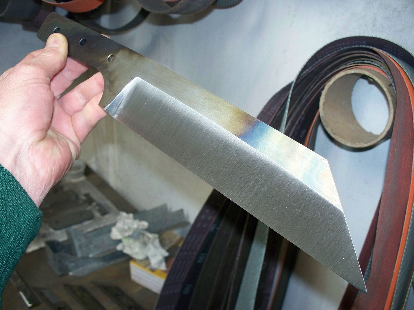

Today I mostly ground the flats on the current batch - S7, A2, 52100 and more.,.. It takes as long to grind the flats as the main grind or more. I'm at 600 grit on everything and will bring them up to 2000 grit tomorrow then back down to a nice satiny 400.

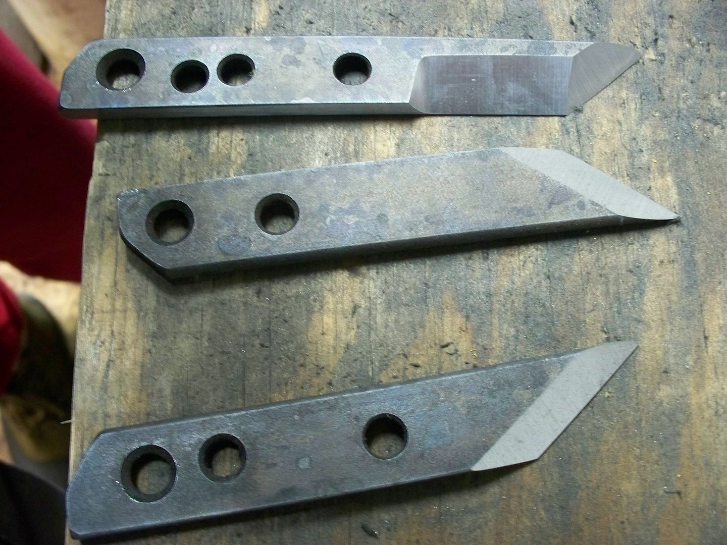

Kiridashis... left hand grind, rh grind and a custom in the second pic - a tanto too! The tanto is not yet spoken for.

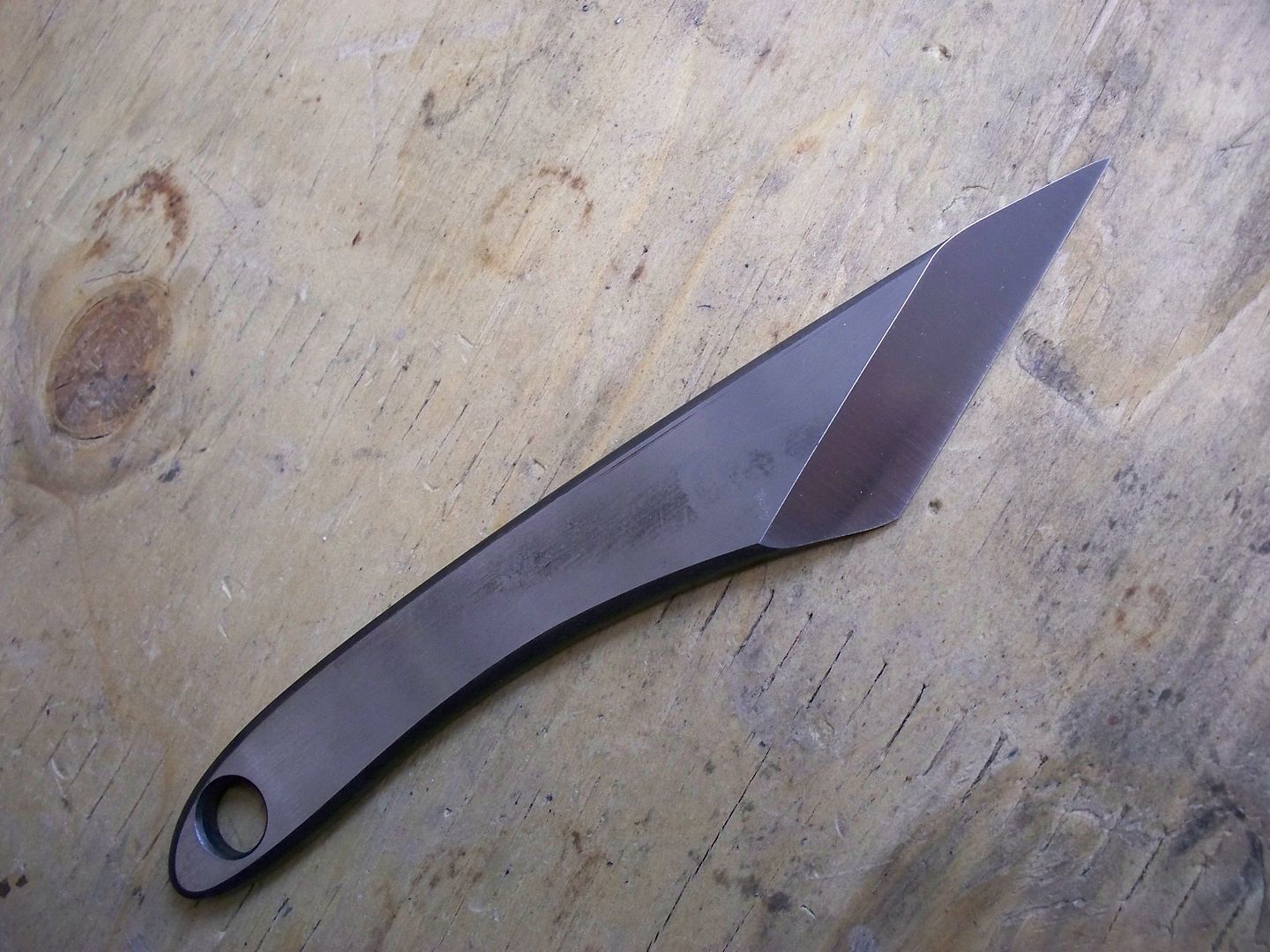

Custom Dashi for an order

Nice lookin custom dashi!

Dang... you can grind!

Thanks! Clean grinds are a big deal to me, I am trying to focus more on handles now but grinds have to be right.
One thing that you can't really see in pics is edge geometry in relation to the grind, it is a big deal to me to have it like I want it.
...as an example a full flat grind is nice but what is the point if the edge is .04" thick? A zero bevel scandi will out cut a thicker full flat all day long. I never worry about styles or extremes in that regard but the geometry must be right.
I know that when a customer feels the knife and cuts with it that is what will bring them back for more if they are a serious knife user. ...or if the knife has to be used in an emergency to pry and it does the trick.
That seax is beastly! That custom dashi looks pretty sweet too.
Thanks! The Saex makes me want to chop through a wall or something!
I think it would be really nice for splitting kindling and camp tasks too. Even with the pointy tip all the weight is forward due to the tapered grind. The edge at the tip is really thick for strength and power while the main cutting edge is a bit slicier for versatility and great weight distribution.

Thanks! The dashis are just rough ground there too, I'll take them up to 600 later for no scratch marks.
Yo Daniel... I sure like your custom dashi!! I'm always watching to see if one like that comes up for sale with a leather sheath. Your S7 5/16 pocket cleaver is still one of my favorite knives. Keep up the great work and thank you!

Thanks! I'll keep that in mind on the leather, sounds nice. I hope to make the dashis a permanent model too.

Thanks! I made one kind of like it as my first dashi and really like the style. This one was a custom order, I should do some more!
