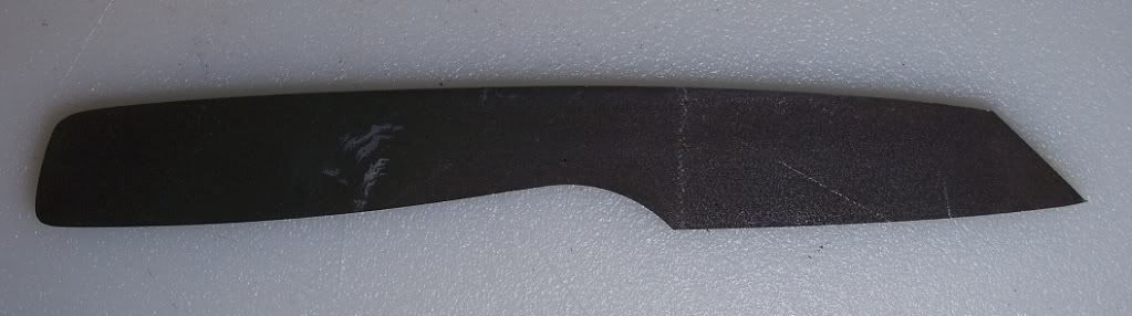

Scribing another one, I'll keep the first as a template.

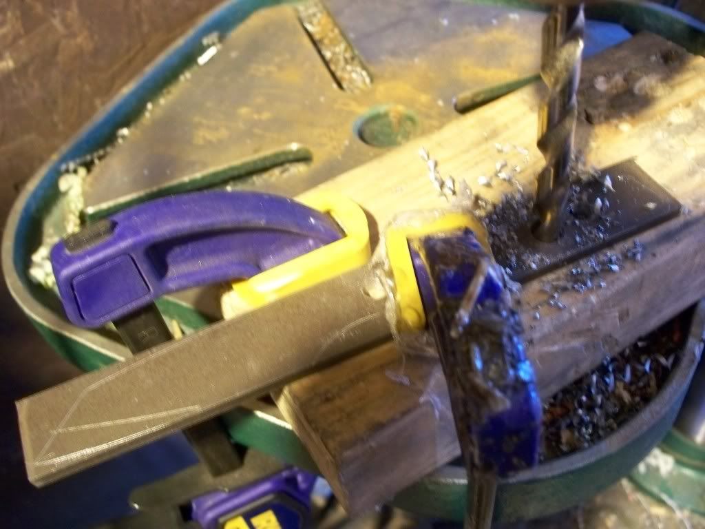

Drilling some holes for hardware and balance.

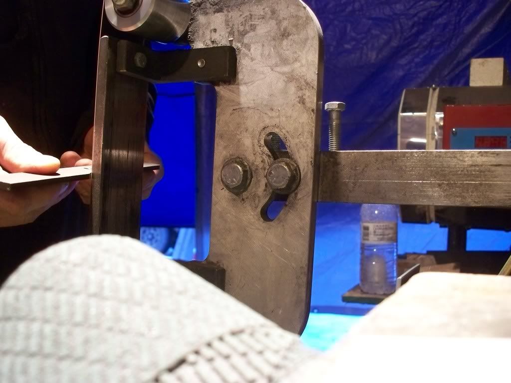

Grinding the profile.

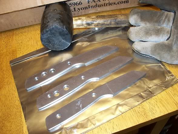

They are in the kiln as I write this, ramping up to nearly 2000 F and will be held for half an hour at that temperature. After that they will be plate quenched with my 1" thick Aluminum plate setup.

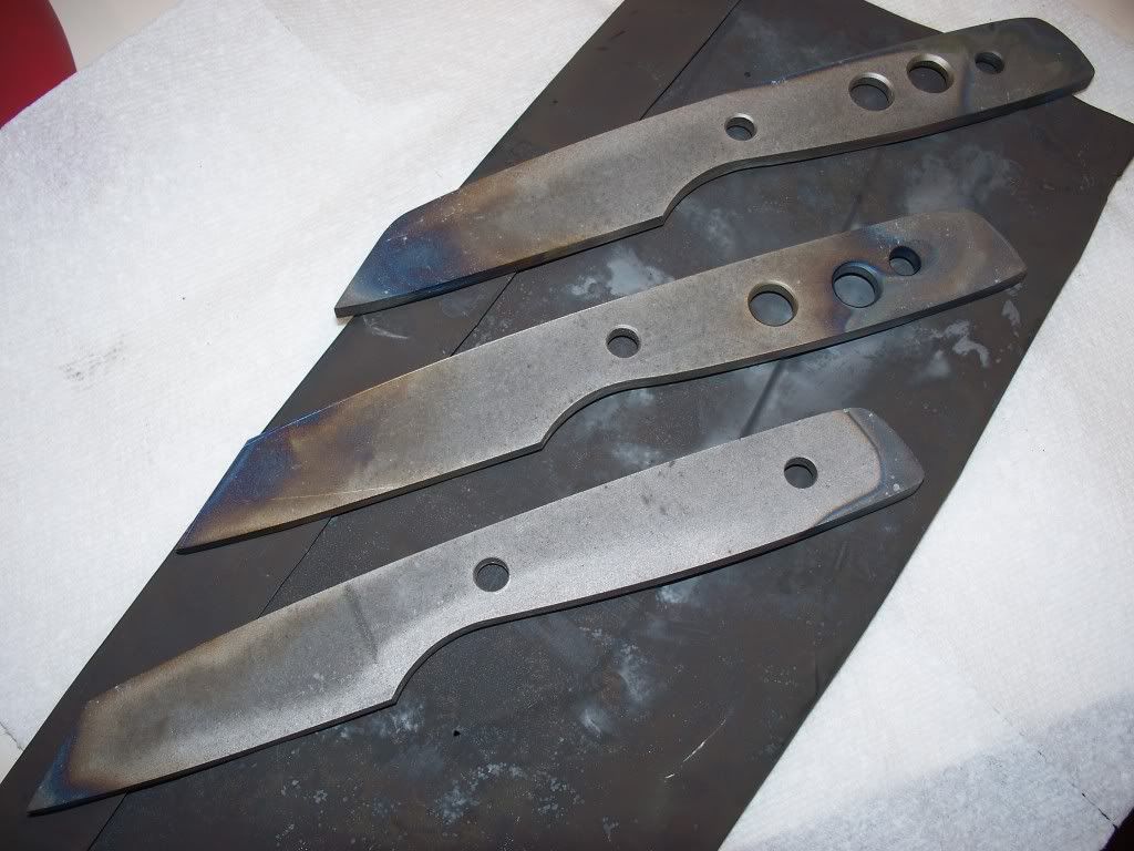

Fresh out of the plate quench, they are clean and straight as can be!
I tempered these for 150 minutes per cycle for two cycles today so tomorrow I'll get to grinding them!
They should be around 60 Rockwell, I bet they will hold an edge forever.
