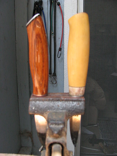

Here is my latest re-handle. It is currently drying from it's last soak in my linseed oil/pine sap finish.
I've been re-handling a few Frosts blades I had laying around to practice my handle making techniques, as well as to experiment with different handle shapes/materials/etc. The idea is to start making my own blades as well, so I figured I'd practice on what I had, before I go and ruin a perfectly good blade I spent a lot of time on with a crappy handle.
The fit around the bolster isn't that great, I wasn't paying attention, and got a little epoxy gap in there. Oh well, that's why I'm practicing on these blades to see if I like this handle design/shape.
So far I really like the shape of this one, it's real comfortable to hold, and I like the lines.
The Blade was a 4 3/8" Frosts blade that I shortened to 4" even, which allowed it to be a full tang.
The Handle is oak from a railing I saved from a demo job. Bolster is two thin pieces of aluminum sandwiching a red spacer. It also has an aluminum back bolster(I think they call it a pommel?). I used a pommel on this one because I wanted to try peening the end of the tang. Ya, that didn't work, so I just epoxied and sanded the tang flush with the pommel. The back of the wood right next to the pommel was torched. I really kinda like the effect that it gives, I should have done the same with the front. I also wanted to put an antler spacer behind the bolster, but I didn't have any suitable pieces.
Anyways, here she is:
I really like the wider blade on this one, and I'm really liking the shape of the handle as well. I think it is going to replace my old re-handle as my woods carry knife. Here is a fuzzy pic of both of them next to each other (You can kinda see the difference in blade width):

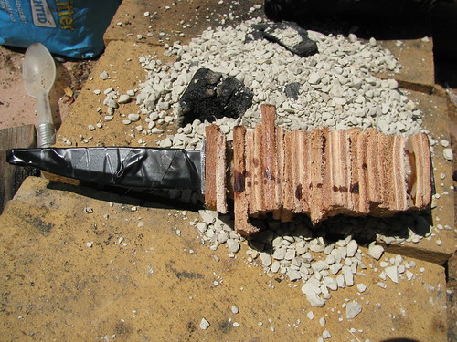

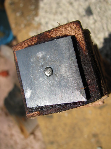

And while I'm showing off, here's a sneak peak at my current leather handle project. This one I'm planning on just making it a plain barrel shape, so the pommel was flat and the peening went a lot better on this one, as you can see. The blade was also shortened to allow for the full tang. 3.5" blade, and 4" handle.
That's cool! :thumbup:. Looks like you are on your way to being a great knife maker. Keep up the great work.
Those look great! I'm a sucker for a stacked leather handle, so PLEASE post how that one turns out as well! -Matt-
Wow, first rate job in all regards :thumbup::thumbup::thumbup:
Love the full tang thing you got goin' on :D
Very nice handle, you really brought the pattern in that Oak out. Looks comfortable too.
Mark
I love it how some of you guys can make a $10 Mora look like a $50 knife just by making a good looking handle for it... Great job man.

That oak looks great. I'm sure the leather handle will turn out fine but they are some kind of ugly during the process. Be careful with that leather dust.

Beautiful work on the handle and accents.
Love the finish...sap and BLO? Does it get sticky?
really nice.
really nice.
Thanks!
Yes, pine sap and boiled linseed oil.
It is a little tacky when it's finished, but that is by design. I personally like the confident grip it gives you when working around liquids like water and blood. And, it makes the handle water proof, which BLO can't do alone.
It doesn't leave your hands feeling tacky, and after you use it a lot, the handle doesn't even feel tacky when dry, but when you get it wet you can feel it. But, like I said, it doesn't leave your hands all sticky when your done using it.
