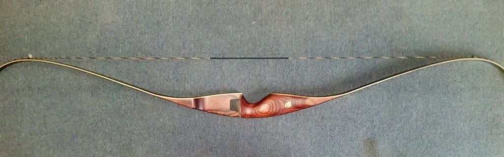

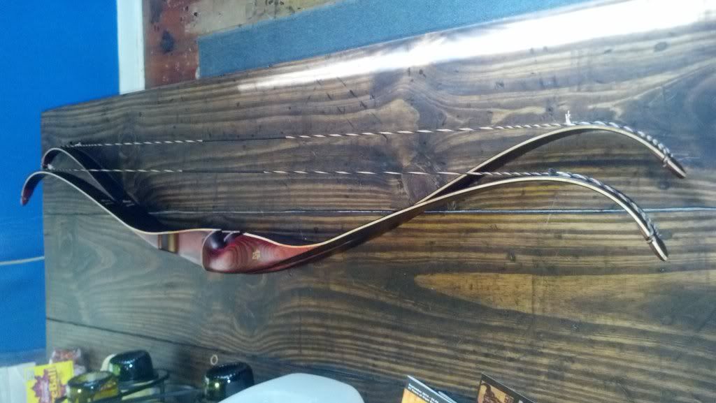

Okay, since y'all have been so helpful I have a follow-up question: My son got his Grizzly bow in today, and as you can see in the bottom photo below, his has a good bit more "BOW" to it than mine does. Is this due to normal new string stretch? The drawing and shooting of both bows feels identical so far as I can tell but there is a noticable difference in their profiles, and I noticed last night that I thought mine looked straighter than it had. Mine (the one in the top photo and the one lying on top in the bottom photo) had been shot maybe 40-50 times prior to him receiving his. Forgive me for a bunch of pesky questions, I did an internet search before posting this but couldn't get a clear answer. Thanks.
Looks like a matter of string length to me. What do the strings look like laid side by side? And the unstrung bows?

This is embarassing, but I think I just demonstrated my ignorance again: with the bows strung, I don't see how it can be anything except string length, and under tension one string does indeed measure about 1 1/2" longer than the other one. I didn't think this through very well before posting. Never mind for now, when I unstring them I'll check again and if there's a problem I'll post again. Thanks, FortyTwoBlades.

the string on your sons bow looks like its got the bear recommended brace height,(just my opinion but i always thought it was to high) yours looks a bit low, if it was me, i'd unstring it, and give it a couple twists,(the string) maybe 3, string it back up and check brace height. i usually go about 8 on my bear bows.
your sons string looks a little short, once again if it was me, i'd unstring it and untwist it a bit, maybe 3 turns, and then recheck brace height.

Well see how a little information goes a long, long way? I knew even less than I thought I did. I didn't know that a recurve bow string length is normally adjusted by twisting it, and I didn't know anything about "brace height". Since learning that, I saw that the pamphlet that came with my bow gives the proper brace height. This in all likelyhood will solve this problem. With the strings removed the bows' profiles are identical and I can adjust everything else. I now see I need to buy a basic archery instructional book. In the meantime though, I'm having a blast turning arrows loose downrange and actually hitting my target. Thanks so much, heresthedeal.
If it's noisy at all during the shot then twisting the string in either direction like heresthedeal mentioned will help you tune the bow until it's at its own preferred length. This can be more or less than the "ideal" brace height, but often is in an acceptable range. Finding that sweet spot where the noise from vibration is minimized will make the bow smoother and more comfortable to shoot, and will also reduce wear on the bow over time. :)

as far as fixing brace height by twisting the string, thats not how its suppose to be done all the time. with a Flemish twist string, like yours, you can take up a good bit by twisting it. just don't untwist or twist to tight the loops or the tighter cordage twisted part right under the loops.
just twist the body of the string, the part between the tight twists of the loops.
you can twist the continuous loop strings to shorten them up but its not recommended by most of the bow shops i've been to. most only deal with compounds anymore.
i've twisted up 3 inches to shorten a bow string.
