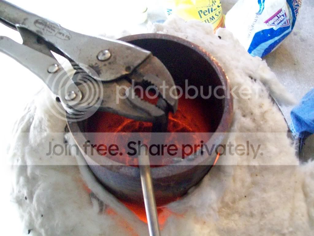

i have kind been out of the loop for the past 6-8 months, but have finally resurfaced. I moved out, and got married. the problem is, I enjoy spending time with m,y wife and vice versa, and also all my equipment is at my parents house. so i have been more than sluggish my my knife-making. That and i have been restoring a motorcycle as a means of transportation this spring, so i have been somewhat busy.

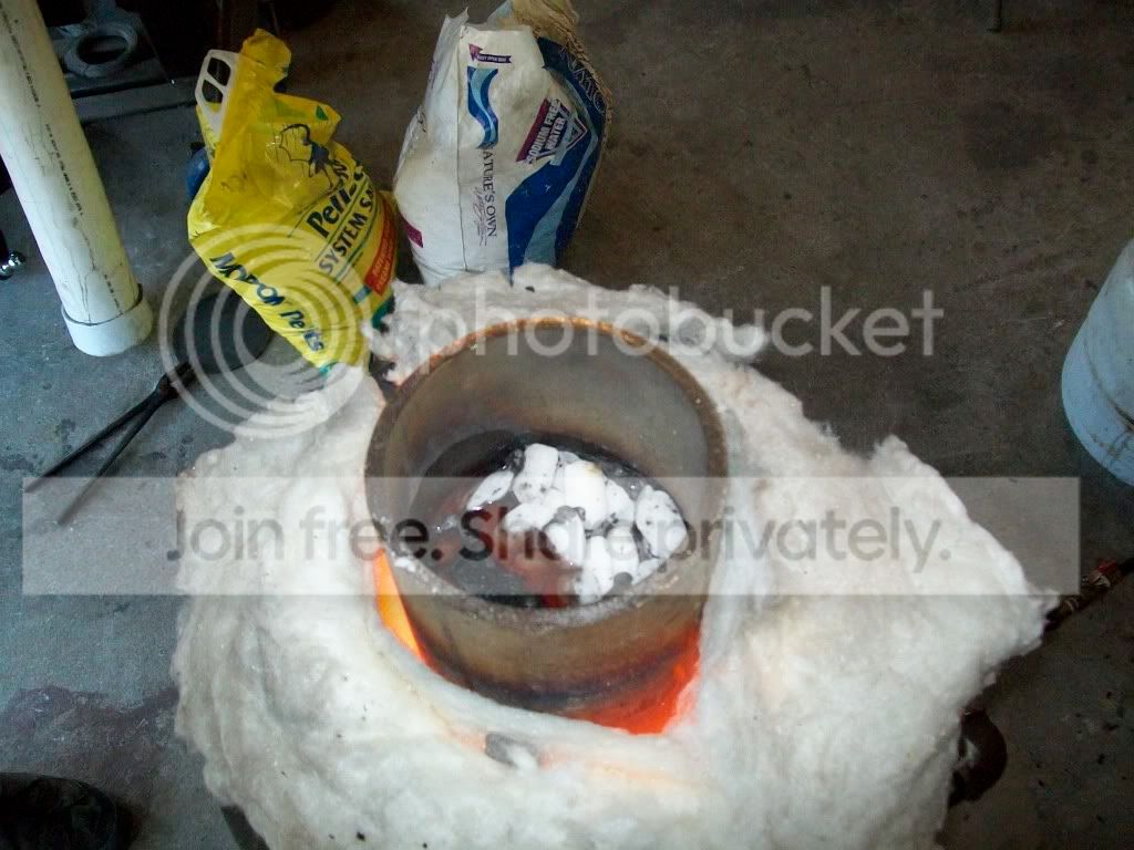

that and the last 3 or four heat treat attempts have come out horribly depressing, Mike Lambiase and i went in to build a salt pot to remedy this situation, and last saturday, I went over to Mike house to get some heat treating done for a katana i am working on. (i dont have the room to temper it), and here are some pictures from the morning.
First, we fired up the heat and melted the salt:

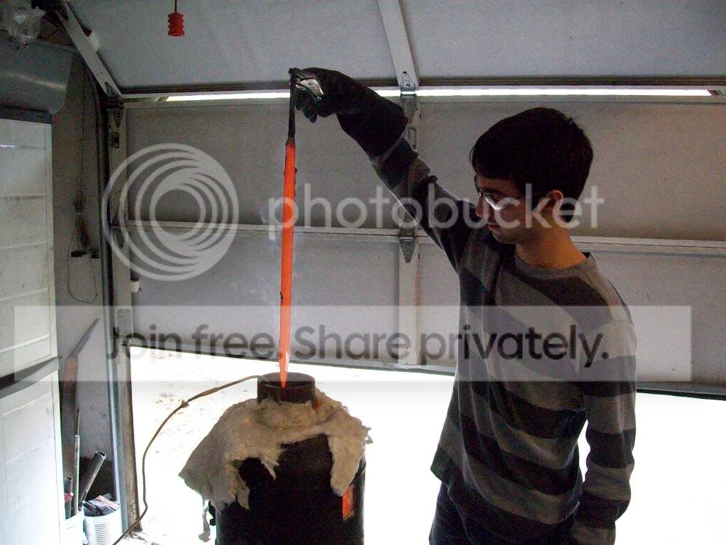

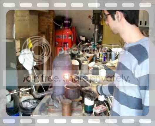

Then we tried it out normalizing my gladius blade
look at that even heating!
i admit, we were both ecstatic about the results. i have broken the last 3 long blades due to uneven heating, and so this is quite a revelation for us.

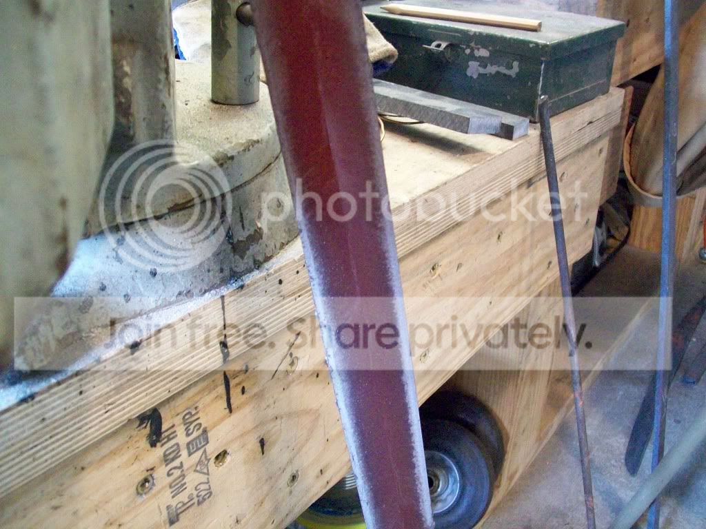

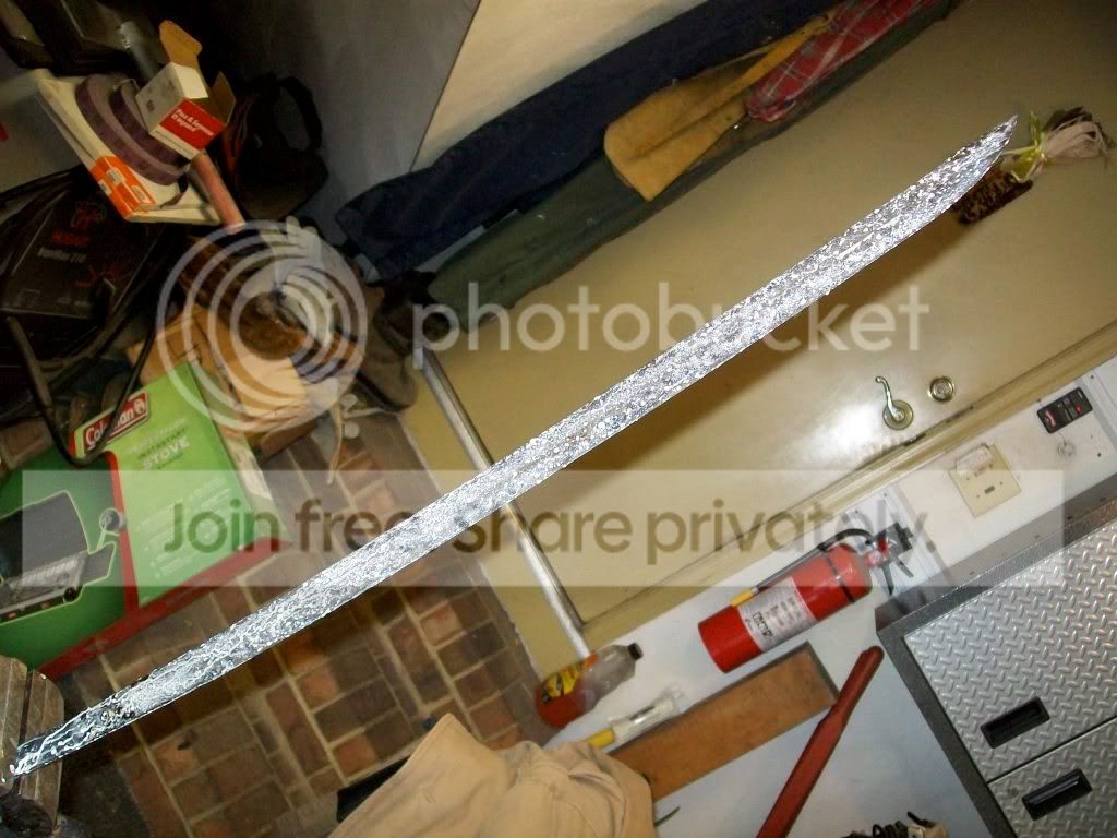

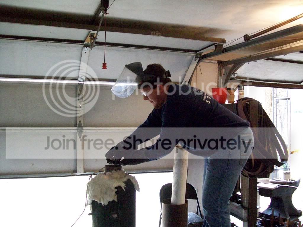

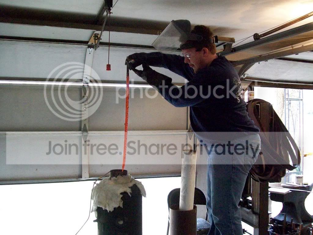

Now the test.. a 28" katana. (notice my safety face-shield... oops)
no cracks, minimal warping, soft back, hard edge= success! i dont know what the hamon looks like, but it will hopefully be pretty.

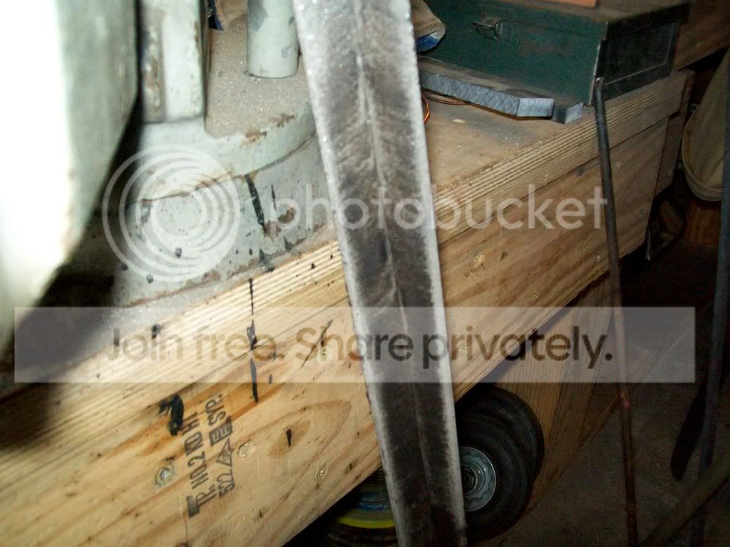

tempered the blade for an hour at 375-400 degrees twice:

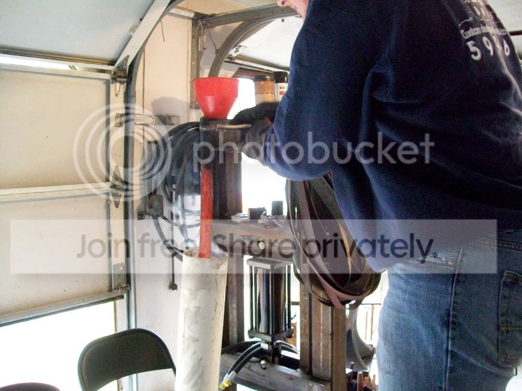

While the blades were tempering, Mike showed me is new airhammer. i must not covet.

Lol look at that spaz with the facemask.
o_o
Oh.
Heheh just kidding, glad you got to treat your blade Chris. :)

If anything is wrong with this blade it's because you have your tongue wrong, must be to the left side when quenching :-)

Hello Chris,
Great to see you finally built your salt pot! What kind of salt are you using there? Those bags are not the type of high temp salt I am used to seeing...
Eric
If you are not using high temp salts you run the risk of breathing in bad stuff. Like Chlorine gas for one. BTW- Chlorine gas will kill you dead! I recommend high temp salts if you don't already have them. Regular salt (that is what it looked like in the pic) are a bad idea:eek:. Dan
