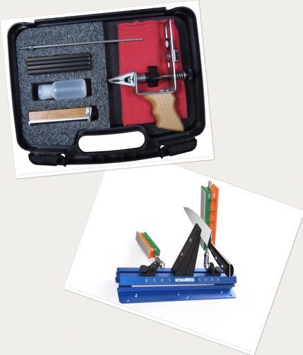

The KME system offers the same basic functionality as a Wicked Edge, but for much, much cheaper. A fantastic bargain. Their customer service is top notch as well.
That's actually not really true... especially compared to the new setup I referenced above.
First, the "functionality" is totally different... working both sides of the knife at the same time vs. working one side at a time. I won't argue that both can get a knife equally sharp... but getting there is not the same. At all. (And yes, I've used both).
Second price. Your post made me look. :) So, I compared the cheapest KME "kit" on their website... vs. the Wicked Edge "Go"... (using manufacturer's price for both)...
KME $179.95
W.E. Go $199 (Intro price of $150).
Both provide a guided clamp system.
W.E. comes with a base and clamp. KME the base is extra.
Both come with 4 stones. BUT, the KME has 4 grit levels (140, 300, 600, 1500)... W.E. only 2 (200, 600).
KME provides a hardshell case. W.E. a "Tool Roll".
Advertised angles: KME 17-30 deg. W.E. 15-30 deg.
So, at this point... the only advantage the KME has is additional grit levels. If you add another set of stones to the W.E. (800/1000) to equal that, it would be an additional $75.00. (If you then added 4 more stones to the KME to equal the # of stones you get with the W.E. at $11.95each that's an additional $47.80). Incidentally, the W.E. stones are slightly larger... 5.475"x.8" (4.38sq.in.) vs. 4"x1" (4sq.in.)... although probably not significant. If you add a base to the KME to equal the W.E. package... add $24.95.
If you total the KME setup at this point... $252.70. W.E. is $225 (after the Intro price it'll be $274). Since realistically, you probably wouldn't add the 4 additional stones to the KME just to equal the number of stones of the W.E. setup... you could price the KME at $204.90. Either way... I wouldn't say "much much cheaper"... (and keeping "what you get" the same... the W.E. may be the better value overall)?
I think customer service for both has been exemplary for both (based on general forum feedback).
(Not saying the KME isn't a good sharpener... just giving a breakdown based on your post). (I do know that some of the W.E. setups are priced much higher... but I don't think that would be an "apples to apples" comparison... although it might be interesting... :rolleyes:).
(Sharpeners compared)...
