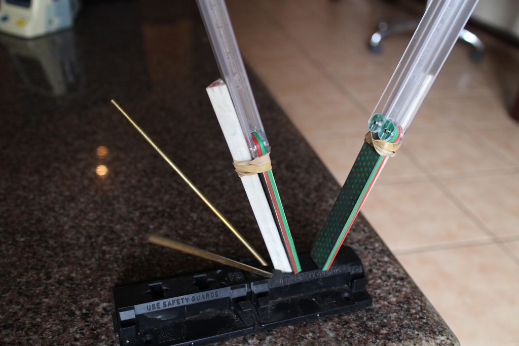

absolutely in! I would prefer diamonds...anything between 600 and 1000 would be great. I think you start to run into some stability issues when you start getting into coarser ceramics. Between that and all the new "super steels" we have at our disposal, I think a set of finer diamond rods would be the way to go. Right now I use a set of DMT 1200 grit diafolds that I rubber band to my SM rods. They leave an extremely sharp edge that still has a good bit more bite than the medium ceramic rods.
That's a really good idea. Going to give it a try.
it works, but the paddles are a bit short and the setup is a bit rickety. Works fine as long as you go slow and careful and provides some great "in between" edge finishes. I have two of the Fine/EF paddles so its like having 600 and 1200 diamond rods. I would still buy regular rods in a heartbeat if they made em though.
