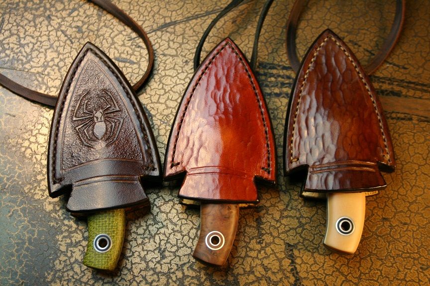

I like this a lot Bud:thumbup: I have a leather neck sheath from Rick Garcia aka Rayban with magnets for my Izzy II & have had zero issues in the last three years I've owned it:thumbup:

But, bonafide is correct, none of this effects how the knife will fit into his excellent neck knife sheath prototype.:encouragement:
