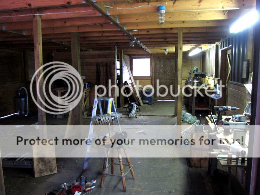

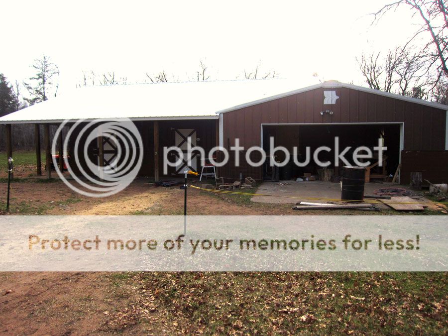

If you noticed that I haven't been posting lately.. well it's because my family and I bought a new house (not too far from the old one) and I'm currently setting up my new shop. Our new place is still in Northern Wisconsin close to the Lake Superior shore.. but we are now further into the woods and right on the edge of the vast Chequamegon National forest. We have 10 acres of what was a small horse farm and is oak/sand barren country... nicer than the swamp I was living in before. And the stables were perfect for my new shop. Although we have no interest in the short term in getting horses... we will probably get some hogs and a couple of beef cows since we have two nice hay pastures and another pole barn. It will be nice to have some extra income on top of my knife making.
Anyway.. I will post more pictures of the shop later when it's done... but here is where it is now. My finishing shop will be in the actual stable part... which has a nice sand bottom topped with horse mats. Very nice on the feet... and no more heat getting sucked by concrete! It is insulated and will be heated with a wood boiler. The forge is in the 'barn' part of the shop and only has the roof insulated. But will be a great open space for me to forge in. I've also taken advantage of the situation to put digital temperature control on my heat treat forges as well as hooking up a VFD to my KMG and to a new 9" disk grinder (from Wayne Coe). So... a vast improvement in my knife making habitat.
Here is the finishing shop coming together. The horse stalls were composed of tongue and groove cedar planks that we were able to re-stack into a second room.. which will be dust free and used for leather working and layout/design. I'm excited to have some horizontal surfaces in a separate room that won't be buried under dust and miscellaneous crap!
Anyway... still lots of work to be done.

I like the shop . Nice work space.
I just finished mine ,40 plugs, insulation, sheetrock, it was a lot of work ! I hope you keep us updated with progress photo's .
No... You drove right on by because you knew I was gonna grab you to help move my press, mill and table. :-) We actually used a front end loader for the table (it has a 2" thick steel top with I beam legs).
Thanks Aaron... We posted at about the same time. Yeah I will post more pictures soon...
Wow Scott, great looking shop! Big too! And your turning out some very interesting work!

Thanks Steve... At this point it is bigger than I need. But I'm sure that will change.....
