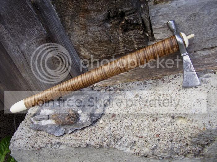

Here is a new pipehawk i just finished. Forged from 5/8" round twist damascus stock deep etched then all the oxides were buffed off.
It is 17" from tip to tip and the head is 6" with a 1 1/2" edge the fittings are ivory.
Thanks for looking and your comments.

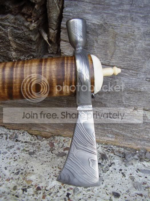

Is the pipe bowl ornimental or functional
If it is functional how did you make it so.
It is really nice BTW
Thanks for the kind words everyone!
Tom yes you can smoke with it. The head was slit and drifted and the bowl was made seperately with files and drill press then hard soldered to the head.
