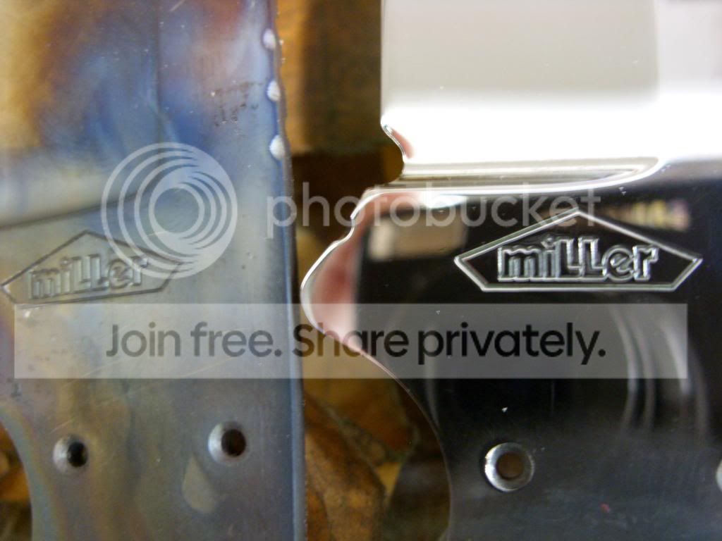

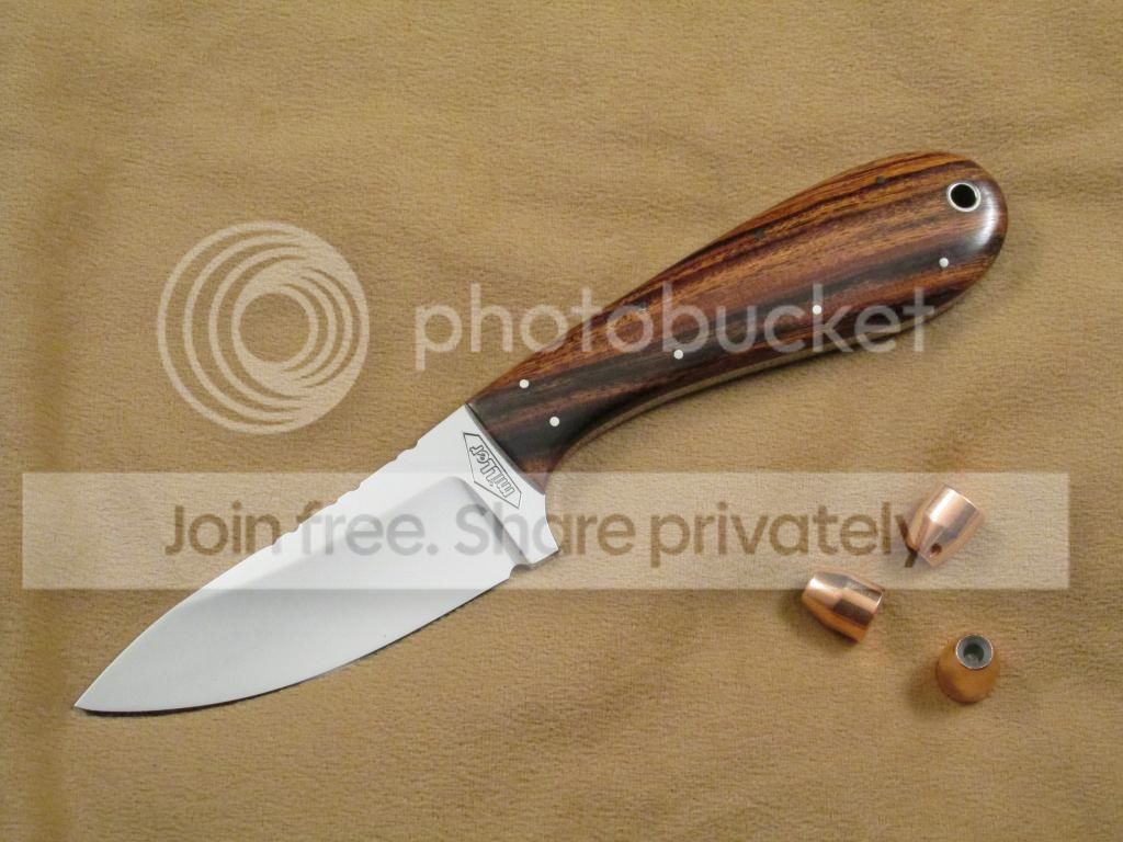

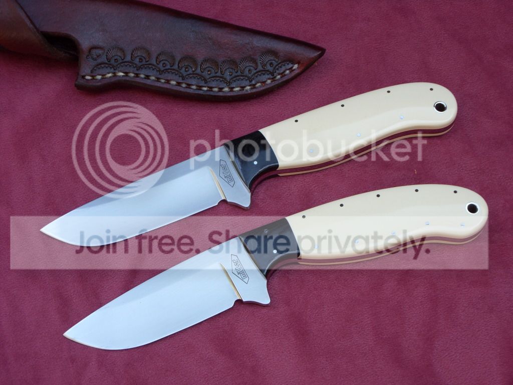

Well with everyone getting stencils, etchers, stamps, and laser etching all over the place I was starting to feel a little left out, so I finally pulled the trigger on my new stamp, I decided on my design last year so the hard part was already over :0)

Nice. I did 1/16" on mine just so I could fit it on ricassos. I also have 11 characters and at 1/8" I thought it would be too big.

I used a 16oz ball peen for the marks in the picture and I had to strike it pretty hard to get the mark, I'll probably step up to my 3lb cross peen next time, should be able to slow things down a bit with that hammer and get a deeper mark with a single hit

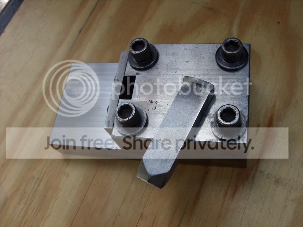

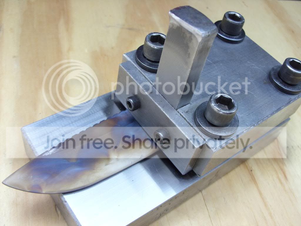

John, glad to see another "stamper". I've been using my stamp for over twenty years and it's still going strong. I tried etching but what turned me off was that most of my blades are mirror polished and if I wanted to touch up the blade on the buffer after I marked it with an etcher it seemed to mess up the mark. stamping is forever. the one thing I found out right away though is getting it right on the first strike, to solve that I had a stamping jig made up. once the blade is clamped in it you can hit it all day till next Tuesday and the mark will not jump or shadow, just go deeper. here are a few pictures of my jig to give you an idea. the second picture has a heat treated blade in the fixture just for reference, of course if you strike a hardened blade, game over Ha Ha......

I've been looking at stamp jigs since William made mention of them above, and I have to say yours looks like the best one so far, with any luck I should be able to make one just like it without to much trouble
Thanks for the pictures ;0)
A basic jig works, too - I went mega-basic welding two pieces of channel and some grinding inside to smooth it out so the stamp slides. It helps me a lot, but I will make that Jig you have featured -Wonderful!

I just wanted to say that is a pretty damn sexy jig for stamping.
