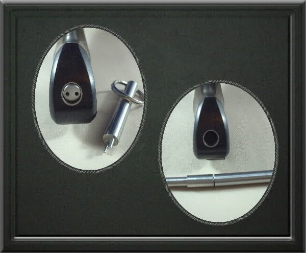

I thought I might toss this up for you guys to see. I up-graded one of my Take-down assembly screws from the simple slotted type to a pinned type. This eliminates the chance of the hollow ground screw driver I always made for each knife of slipping and possibly damaging the handle material.
The Screw and tool are 416 stainless and the pins are hardened tool steel.
It also allows the screw to go flush ar even recessed.
Just somethin' else to look at!

Cool!!!! So how do you get the pin spacing right?

If you fitted it, then ground it flush against a background with similar color, you could make it nearly disappear (except for the two small holes). Invisible takedown? That would be cool.

I truly need to give credit where it belongs:
I was taught the take-down procedure by Jerry Rados who shares this method with Jim Siska. As well, A Master Smith who does quite a bit of it is Bailey Bradshaw. I admire the heck out of all of these guys.
This pinning procedure is also used by Jerry on his screws for his autos, but on a MUCH finer detail!!
Look at the screw head here on this Rados Damascus auto, and consider that there are SIX pins on this little screw!
