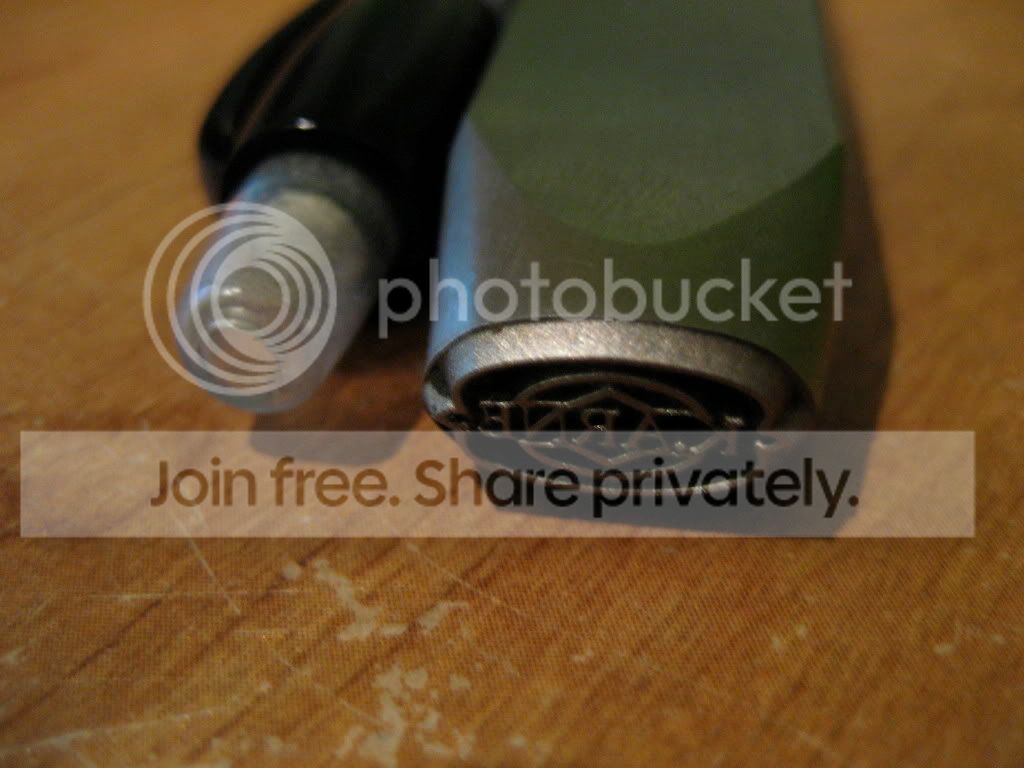

So I got a tang stamp made by Harper and received it the other day. Well, I seem to be having trouble getting a good impression on annealed steel. I can get some of the outer rim of the stamp to print, but can't seem to get the whole thing. So my question is whether it's my technique or is it possible that the lines are too thick for me to feasibly stamp it by hand.
There's a picture of my stamp, it's about .5" across. Sorry, not the best picture.
I think some of the problem might be that I am a little afraid of hitting my finger while I hold the stamp, so I don't hit it quite as hard as I can (one of the first tries I managed to hit my index finger pretty hard). Do you think that simply making a jig to hold the stamp on the blade will fix my problem or will I need to get some form of press (arbor or a bottle jack one like Kevin Cashen)?
Anyways, thanks in advance. Don't want to heat treat any more blades without my stamp on them.
Kevin
you could probably use alot more power without fear if you used a pair of tongs or pliers to hold the stamp in place. that way the worst that could happen is you mess up your stamp, instead of turning your fingers into ground beef...

I made a fixture to hold mine on the arbor of my arbor press. I then pressed the stamp against the steel and struck the arbor sticking out the top of the press. This would give me an ok stamp. I then went to heating the blade to normalizing temp then stamping. Much cleaner and more consistent results.
I am almost farley certen you have to much detail to stamp by hand. this is my stamp that i made and i have to use a 4 pound hammer and give it a very hard whack. so hard that if i miss and hit my hand i would have to go to doctor and get a cast on it. to many lines on a stamp increases the overall amount of force needed to stamp. it looks like you will need to stamp hot or use a press

My thought is that there is way too much surface area on that stamp to achieve a good stamp by hand. You have to displace a lot of steel to get an impression with a stamp like that. The less surface area the mark has to print into/onto the steel, the less force is required.
I would suggest that if you insist on stamping cold, build yourself a small press with a 12+ ton hydraulic jack, such as I did here.
I personally don't like stamping a blade cold. It puts a great deal of wear and tear on an expensive stamp, making it last only a fraction of what it should....especially if your whacking it with a hammer. The press makes the chances of mushrooming the letters less, but still wears the stamp quickly compared to hot stamping. I have actually split the ricasso on a few knives when I tired to get the pressed in mark just a tad deeper.
I don't stamp my hawks or rr spike knives cold,I put the stamp in a visegrip and use my treadle hammer,but it sees double duty because I stamp my etching paper with it for my knives.I also think that is too much detail to stamp cold,A lot easier hot,you might have to straighten a little afterward.Just my 2 cents fwiw-:)-Regards Butch
So it seems like the consensus is that I should either hot stamp it or make a press for it. I think I'll start with hot stamping, since that's certainly cheaper. Wouldn't the hot blade affect the temper of the stamp though?
