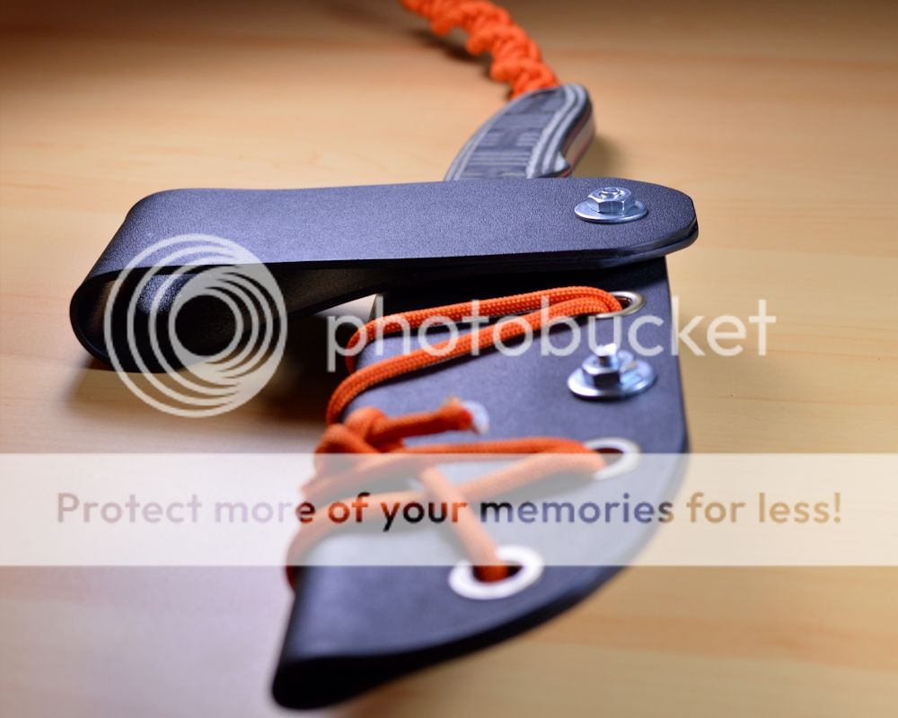

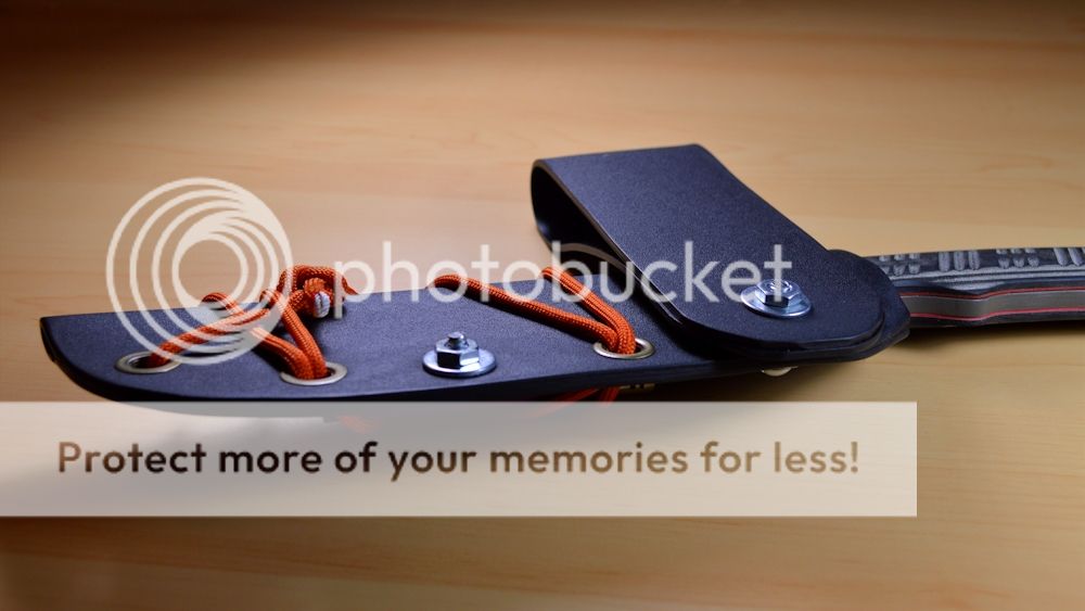

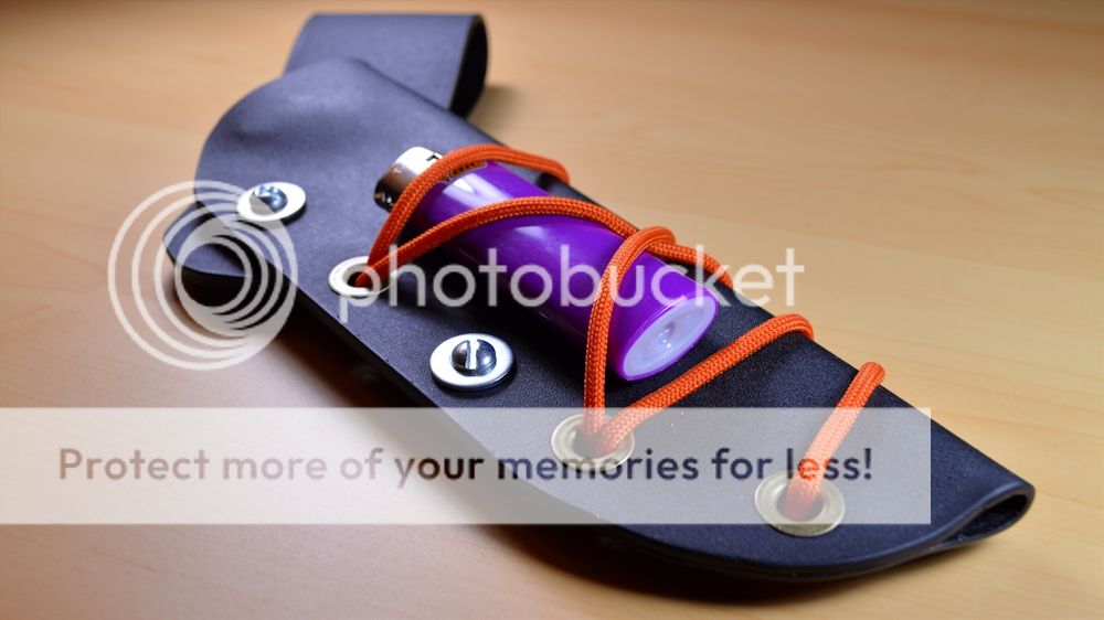

Hi everyone,

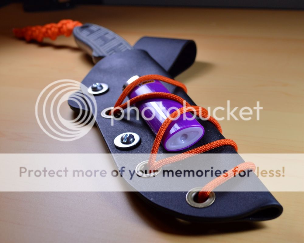

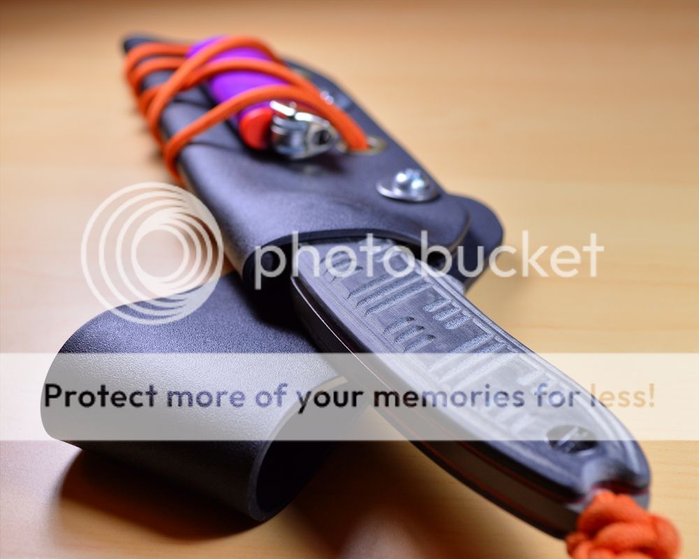

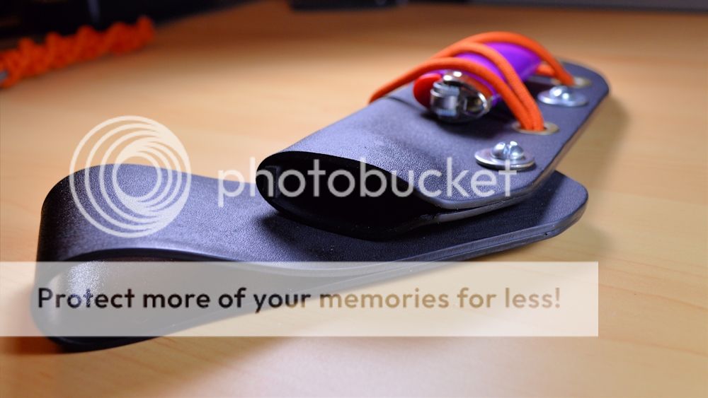

This is the third Kydex sheath I've done. I used a home made press, then hand cut & hand sanded it, and used a hand rivet press. For this sheath, my wife gave me the idea of fashioning a belt loop out of Kydex, and it worked out great! This way it is carried in a more comfortable "dropped down" way, so that the knife handle doesn't dig into my ribs.
It can also easily be adjusted and carried "scout style", because the loop can swivel 360 degrees (I attached it with a rubber/plastic spacer). Also, an extra belt loop can be added for a more secure attachment where the extra screw is. I then used orange 550 paracord for extra visibility and attached a super fancy 21st century fire starting device. ;)
In the end, this sheath weighs less than the nylon sheath the knife came with... And it has a much more secure fit and does not retain water. I feel that it could use some additional sanding and don't think it's quite "done"... But I'd appreciate any thoughts/suggestions? Thank you!
-Jeff

Cant see your pictures, but I dont know what Amazon Cloud drive is. New to me. Might not be supported by our forum software.
Anyone else see it? Might help a little.
Thanks for letting me know! I resized the picture so it is a smaller file size.. Maybe that was the issue? Trying just one picture as a test:
fm0q368K4NuwIzkSkvJWdgIw7c4sbie4r0cR6McT8RI
I'm not normally a Kydex sort of fella , but I like what you have done there .
I'm interested in your desire to attach a simple disposable lighter to the sheath .
I have recently been to a remote place and realized that " Fire " was an important part of my daily requirement .
I seriously don't understand fire sticks etc when you can have instant flame with a lighter .
I like what you have done here , everyone is different and has different requirements , I suspect yours are similar to mine .

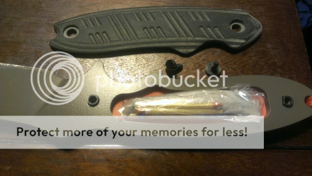

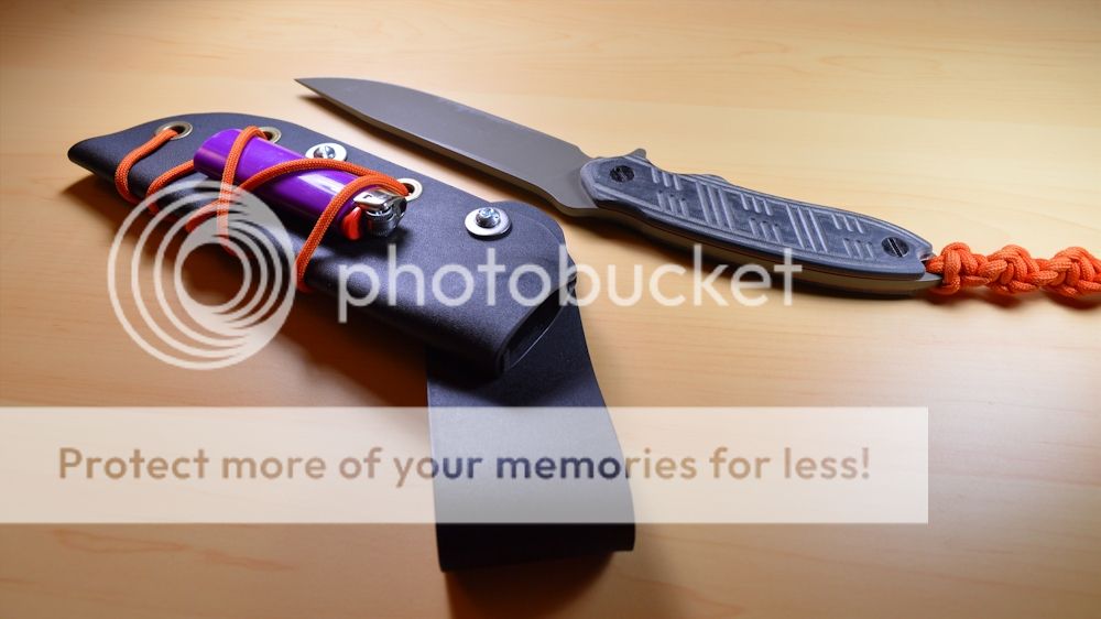

Thanks for the feedback everyone! There's actually a hidden backup that I've put into this knife that has me covered in your scenarios! I've attached a picture, there are 3 matches and some tinder that I've put inside the handle of the knife. The handle scales are easily removed using one of several washers on the sheath. (Picture below) I just prefer using a lighter as my first fire starting method. :)
Oh, and the above info doesn't count the Swedish firesteel I've always got in my backpack, and the one my wife has in hers... Plus I have 2 additional fire kits, one in our car trunk and another in my backpack. (I swear I'm not a pyro, I just don't like to be caught without fire in an emergency!) ;)

Cool stash in the handle but 3 matches might be useless on a windy night, however it's a great space to hide the combination to your gun vault.
Looks like you're off to a great start. The only thing I saw that concerned me was the bolts sticking out on the back of the sheath. Seems like they might dig into your leg or rub a hole in your pants at some point. Get some cheap Chicago screws and you're off to the races.
Nice work.
Thanks all! Hale Storm, thank you for the feedback! I am guilty of just using some nuts and bolts that I had on hand, I agree that an upgrade to Chicago screws is needed. Thanks!
