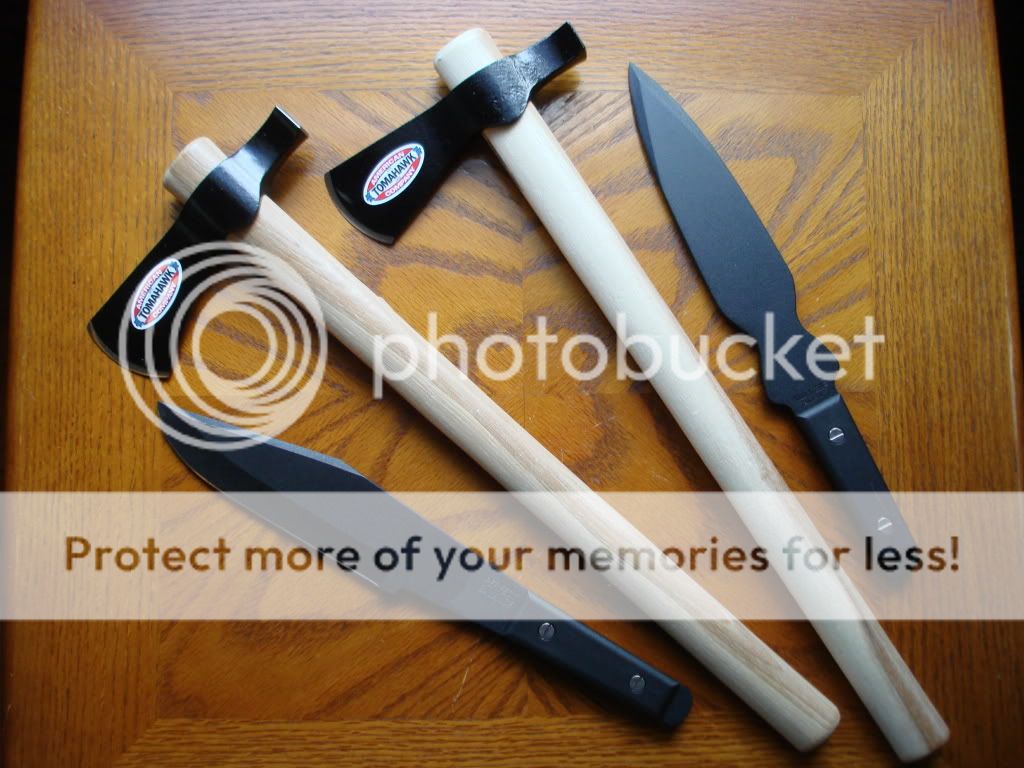

how sharp does cold steel hawks come when you get one from factory,my trail hawk is on it"s way,p/u at the end of the week,traded a new cold steel kukri i had for it.just wondering.
To answer your question, I'd say NOT very sharp.
I would highly recomend convexing the edge using the methods spoken of above, unless you are only going to use it for throwing in which case I wouldn't bother.

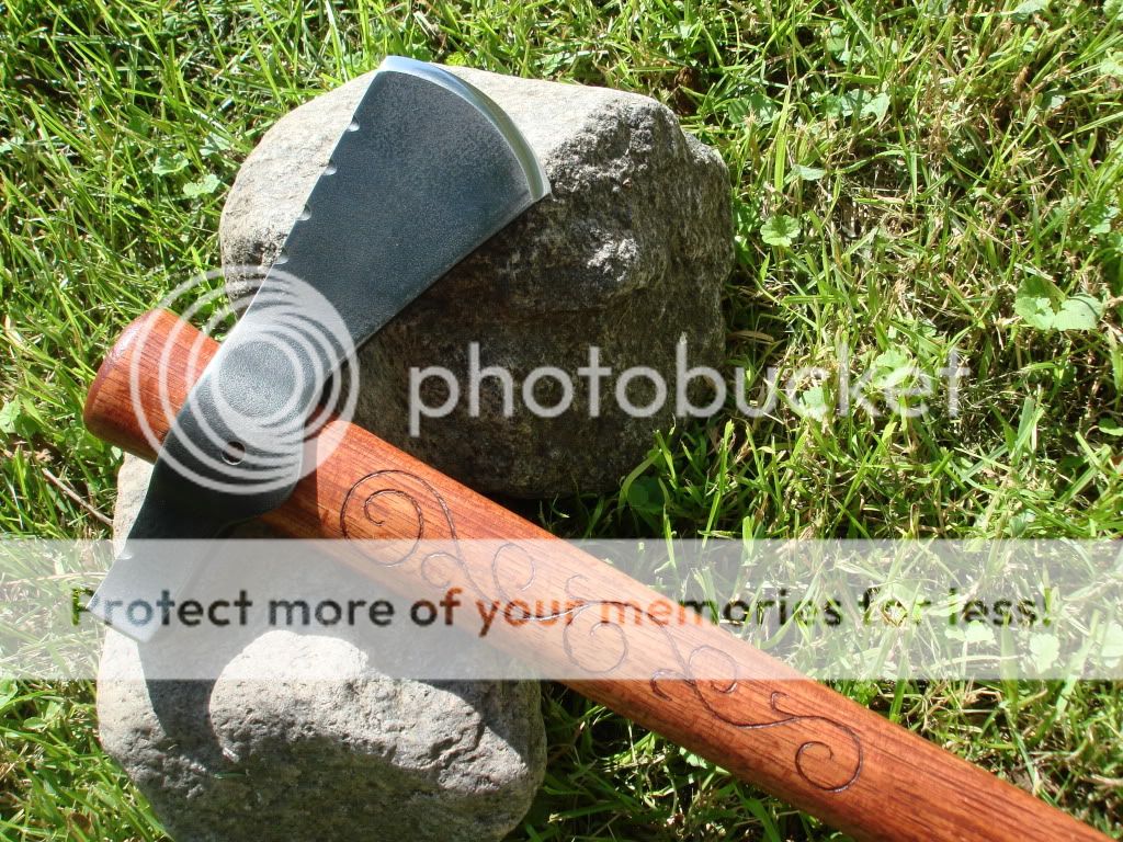

here's the most recent edge that I did, I started with a file then sandpaper on leather. Finished with loaded strop, now I could shave my face with it if I chose to. :)
thanks for the tips,but i gotta ask,bryfry" your hawk with the floural design on the handle and file work on head ,very nice,how did you get that finish ,can i strip my bit and cold blue it for that look.or is there more to it.thanks.
Thanks. Yeah for the head I just sanded it down then used a couple coats of gun blue. Very easy to do, and I'm pretty happy with the results.:)
Another pluss to the blueing is that it is easy to reapply, or touch back up if the patina starts to get too worn. :thumbup:
