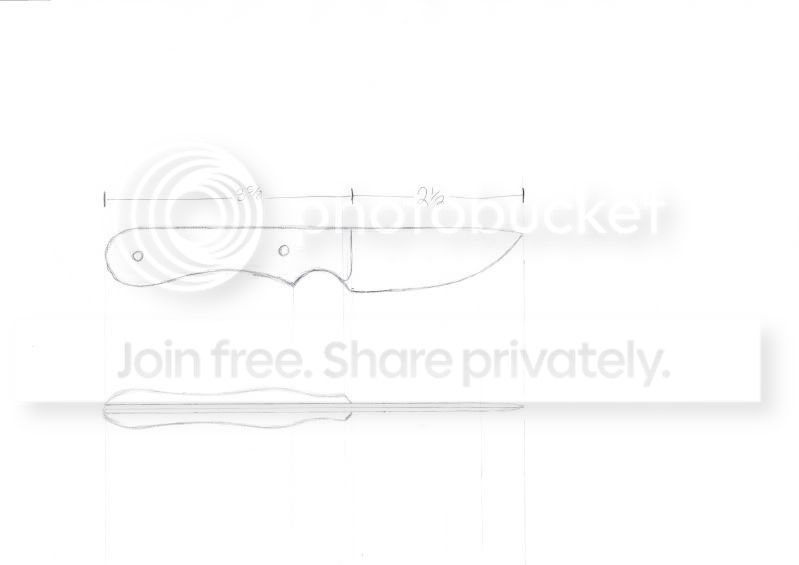

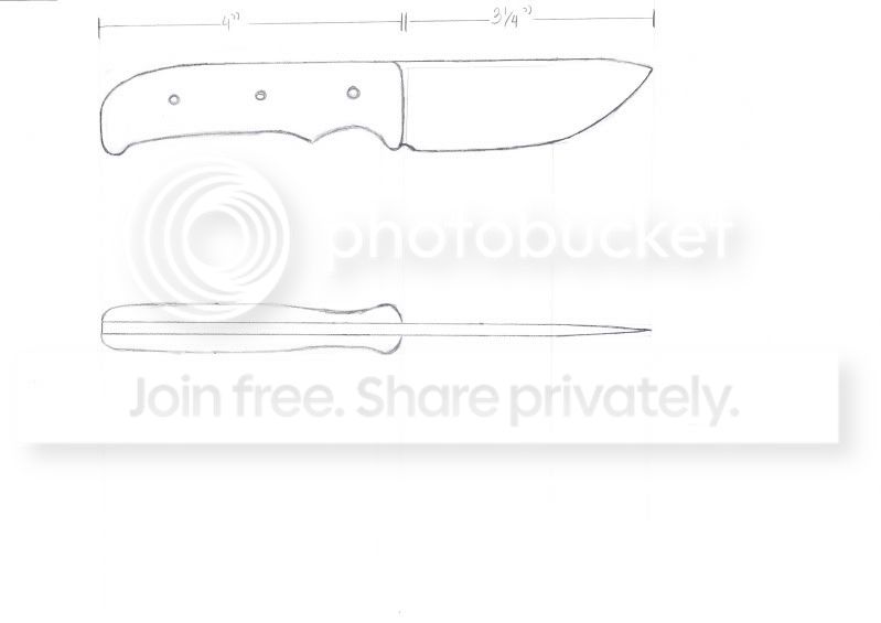

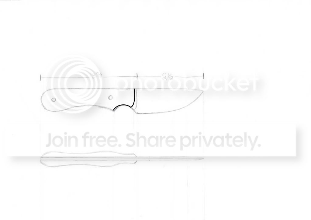

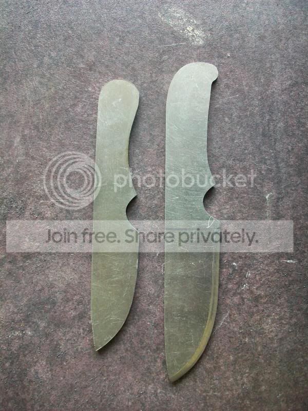

To start I decided to make 2 knives. One medium sized fixed blade for myself, and a smaller necker for my sister's birthday in May.
I started with these two designs.
I settled on 1/8th O1 for my steel, and Tiger and Black/Blue G-10 for handles.

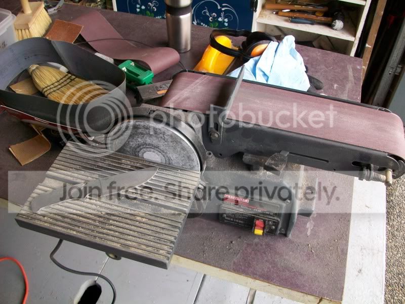

4x36 Belt sander with 6inch disc sander
Chewed up a few belts the first day I worked on them, only had enough belts to do the first and larger knife. Wasn't prepared with the correct grits, and it was VERY slow so as to not heat up the steel with all the grinding. I also had a bucket up water to dunk the blade every so often.

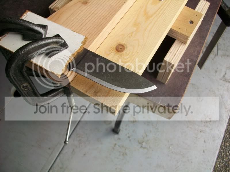

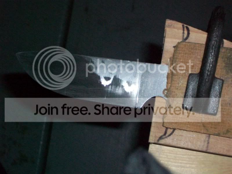

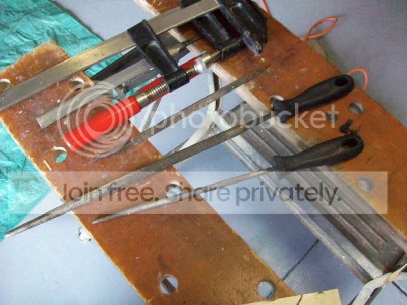

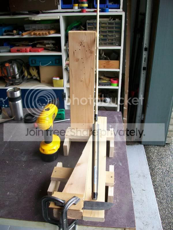

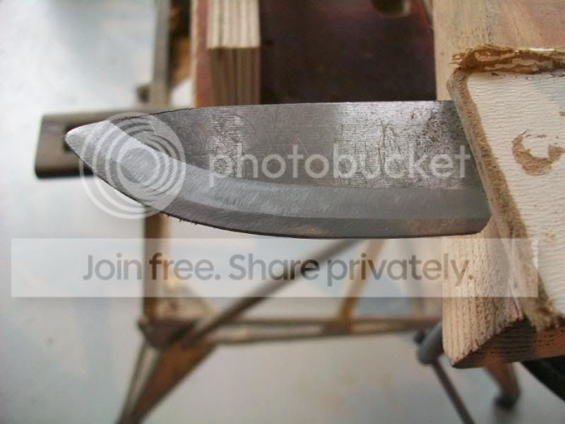

Next hurdle... how the hell to do my bevels. I don't have a 2x72 grinder, so I had to employ a bastard file. On another forum I frequent I saw how someone set up a jig to get perfectly even bevels. I rigged up my own very crude but, quite effective jig.
Here is the first ~45 degree bevel that I cut on each side. I did one side at a time, but alternating sides so at the ensure I could keep everything even.
One more notch down on the jig, and again nice and even on both sides. This jig also helped get a nice even plunge.

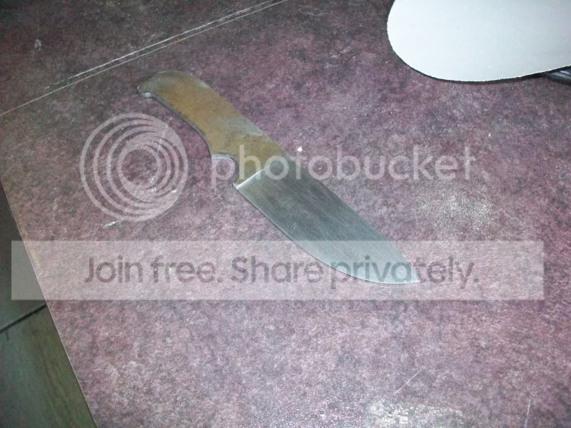

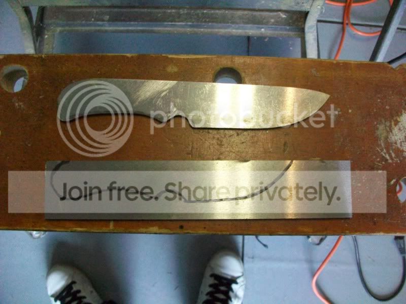

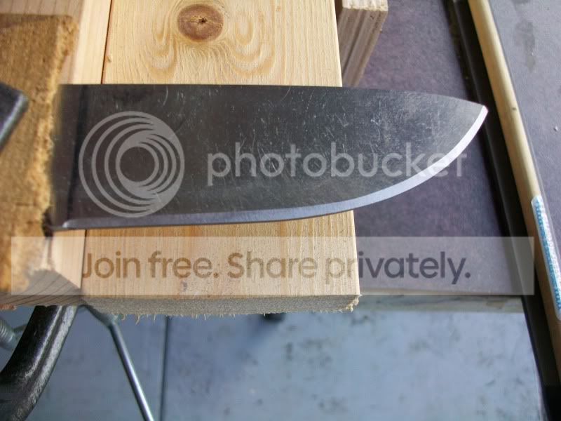

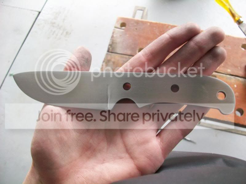

First 1.5 hours was spent grinding out the smaller knife. Have a whole stack of belts ready to go, so it was nice and fast to grind it all down. One thing I did learn though.... order steel that is a closer size to the knife I'm making. Probably could have saved an entire belts worth of grinding and save money on buying less steel.
Fully bevelled on both sides and draw filed to even it all out. Used a chalked file, worked beautifully. And the draw filing really got everything even and true.

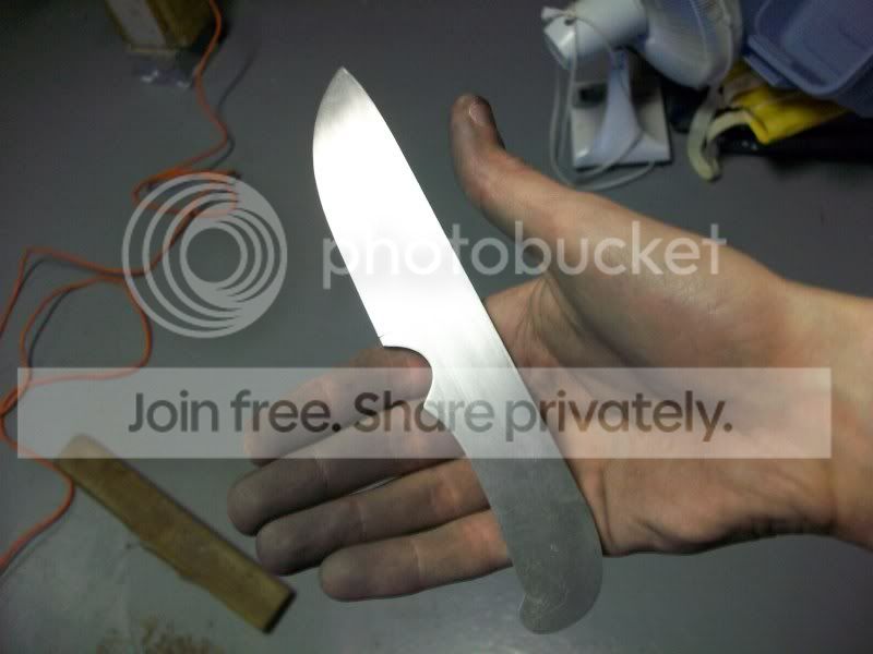

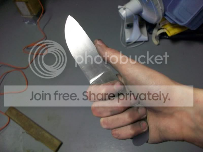

Started on 180 grit sanding here... found a series of low spots along the top.. near the spine. Refiled and resanded, got rid of them in no time.
A few in hand shots. 180 is almost complete, just a few touchups here and there. Not too many low spots found, but I refiled and ground out the ones that I did. Very happy with it thus far, and it is a great feel in my hand.
Here are my sanding tools. One flat, which is sized to get me 16 pieces from one sheet of sand paper. And just a length of dowel for getting those pesky handle curves.

Nice work so far!
It looks like your jig is working quite well.
Wolffbite,
Great work. Two thoughts for now. I hope you don't mind because I'm not sure if you are asking for advice. I ask for advice all of the time so I guess I'm assuming here. Be careful not to grind past the spine and create a ridge between the bevel and the flats - I've done it. Also, I would leave out the tear drop on the front of your handle and do something like this
One of my first knives looks like yours and I love it.
Keep at it and stick around here, these guys know what they are talking about.
Erik
No worries! I appreciate any feedback and criticism at this point. I'm eager to learn and if I don't catch my mistakes I'm very appreciative if I get guidance. That definitely looks like a better option for that scale, I think I will go with your mod on that one, thanks :)
Huh... Funny. What they say is true, no knife design is really unique, yours looks awesome! I'll be glad if mine looks anywhere near that nice when I'm through.

...it was VERY slow so as to not heat up the steel with all the grinding. I also had a bucket up water to dunk the blade every so often.
I'm assuming the steel isn't heat-treated yet, in which case the only major concern about heating it up while grinding is that you don't burn your fingers. I'm not saying you should get it screaming white hot, but you're not likely to do any serious damage to O1 that a basic stress-relief cycle shouldn't take care of once it's all ground, drilled and ready for HT. At least that's been my experience, and what my HT guy tells me.
You can get steel pretty dang hot filing it.

Yes the water was more so that I didn't burn my hands. I could even feel the steel get quite hot through my gloves and watched the water droplets sizzle on the blade.

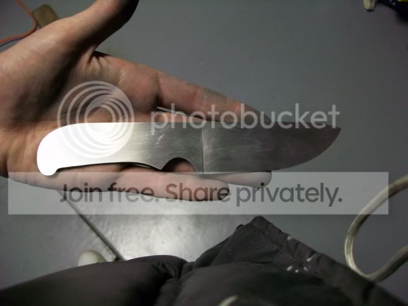

So I spent a bit of time in the garage today...

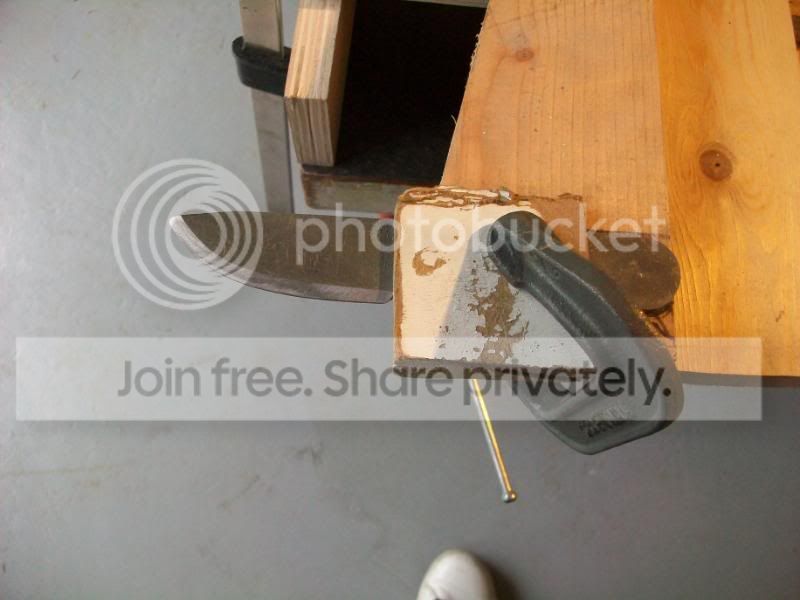

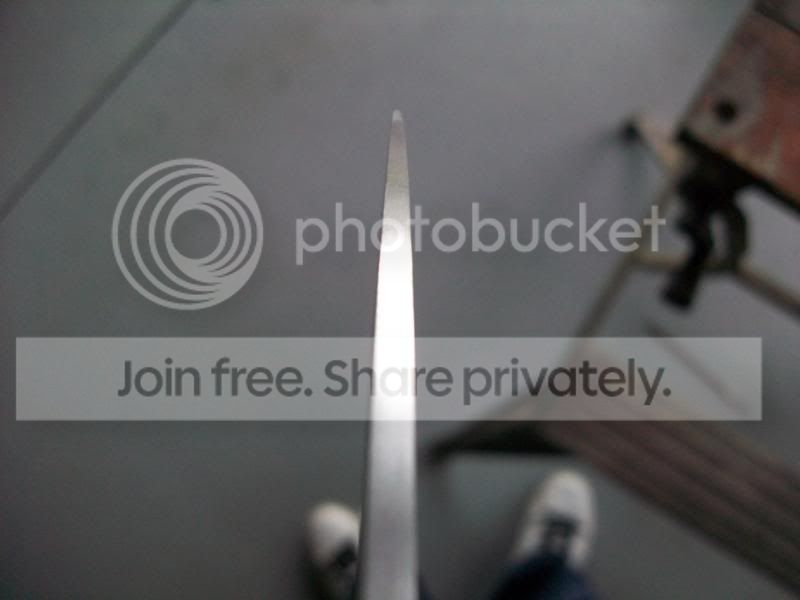

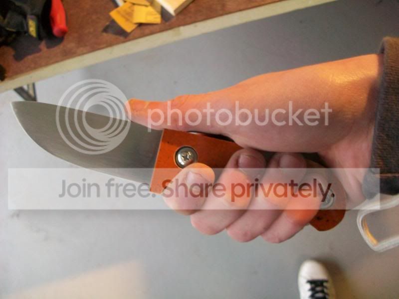

First knife is done to 400 grit and holes drilled in tang. This is almost ready to be sent off for heat-treat!
The tip came out nice and even using this filing jig =)

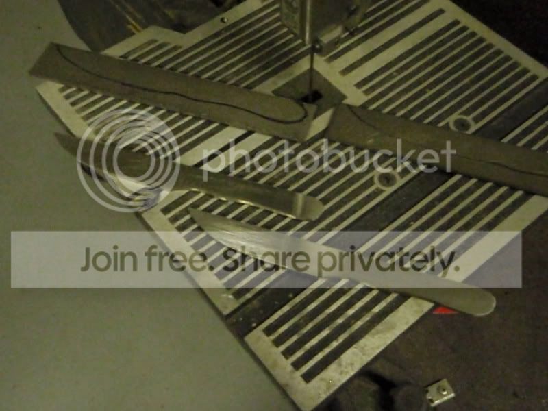

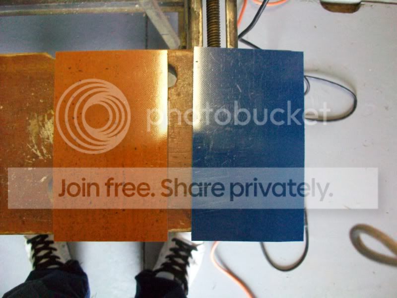

Before starting to bevel #2 I roughed out the G-10 for #1's handles. I used my scroll saw... but it ate through 3 blades just doing this much. Can anyone recommend what I might use next time? I do have a 10' band saw... maybe I'll have to try that.

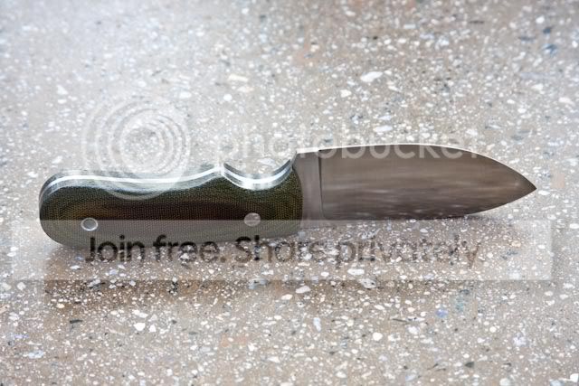

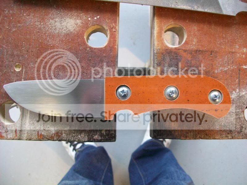

Shaped the scales some more on the belt sander. Left about 1/16th-1/8th of an inch around the whole knife. Won't finish this until its back from heat treat. This will look pretty cool I hope, already has a good feel in the hand.
Take a moment to lightly counter-sink those holes before HT.
Your scroll saw is likely running way too fast, with a too-coarse blade to cut G10 effectively. A typical wood-working bandsaw will have the same problems. A high-tension hacksaw with good bi-metal blades and a bit of elbow-grease will work fine.

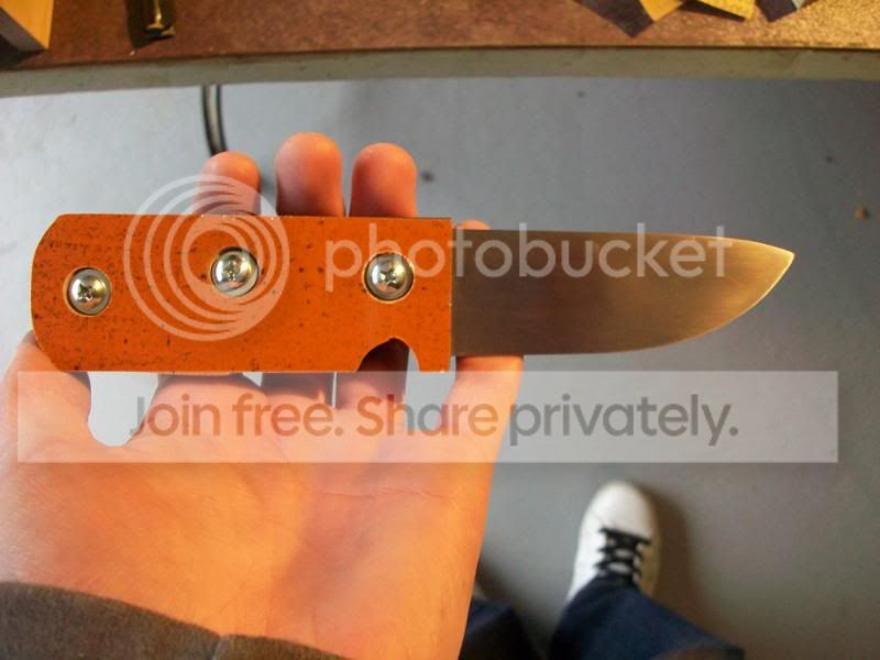

Be sure to finish the fronts of your scales before mounting them.
I recommend Corby bolts or peened pins rather than screws and washers in the final assembly on your next knife. That's fugly and cheap-looking; the other work you've done deserves better.
Hmm... well it grinds down really easily. So I'll see what I do next time...
And you are totally right on the handle hardware... it seemed like a great idea to have removable handles when I was planning out the project but it does look kind of cheap now that I keep looking at it. No harm done, this G-10 can be used for a set of firesteels instead (it's already countersunk so I don't think I can salvage it for use with corby bolts or pins). I'll end up using epoxy I think, and if I clamp it tightly I shouldn't have to worry about rust under the tang.

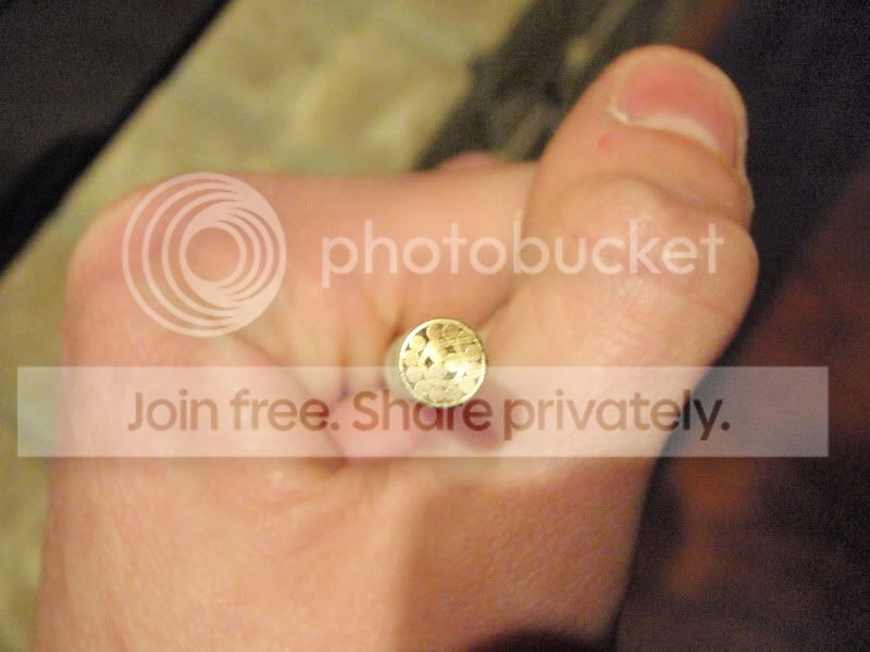

Yep.. as I'm typing this I think I'll do some mosaic pins. My knife steel supplier has some very nice 1/4" brass mosiac ones that I will get with another chunk of G-10.
If you don't mind my asking, why countersink the tang holes? Just curious...
Will it also help with handle epoxy adhesion?

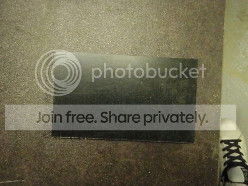

I know, it's weird; G10 is a pain to cut but grinds easily. Just don't grind it too fast, it can scorch badly in a really unpleasant way if you get it hot. Take a piece of scrap G10, really lay into it on the grinder, and watch it turn black and shred apart. Open a window first. You're wearing a respirator, right?
Countersinking the tang holes gives peace of mind re: stress risers and burrs that will irritate the HT guy. It also gives a little more surface area for the epoxy.
Roughing the tang up again will also help give the epoxy more surface to grab onto. In general, the slower-curing epoxies are stronger. Search "glue wars" for a ton of information on that.
DO NOT clamp super-tight when using any kind of adhesive, you'll just squeeze it out and it won't do snap to hold things together or seal out moisture. Moderate pressure is plenty.

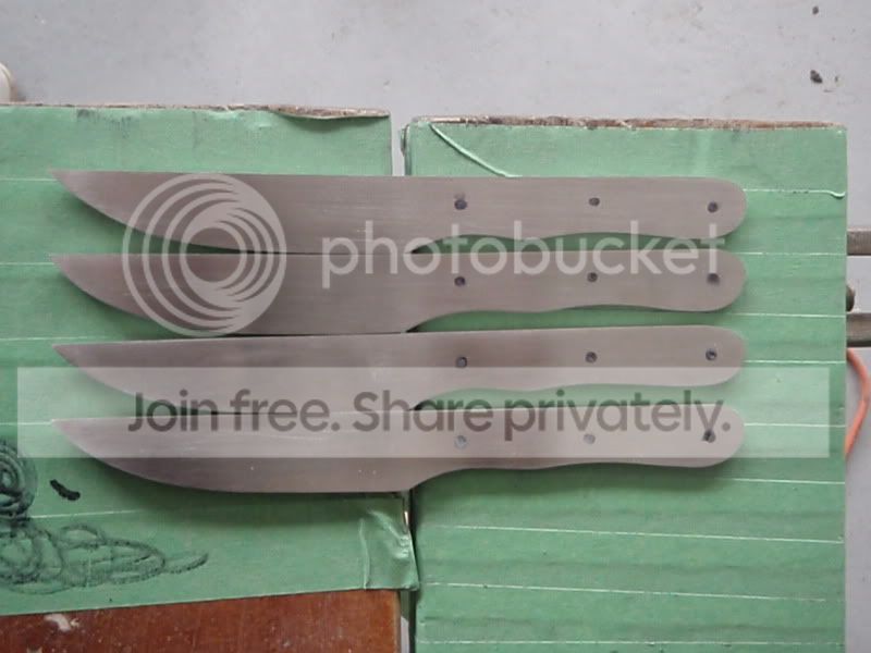

Well while I was gone I was recruited by my mom to make my dad a set of steak knives for his birthday in june... I told her I should probably finish these first two (to see if they actually turn out half decent) before I start... but I kinda had to say yes when she agreed to buy me all the materials :D
But as for the first two knives... They are pretty much ready to go off to heat-treat but I won't send them off until these steak knives are profiled and ready to go as well. Rather not pay twice the shipping...
Since I jacked up my tiger-g10 with some premature countersink drilling and poor initial choice of hardware I ordered another slab and will give it another go.
This one is called pistachio... looks like it will be quite nice.
Anyways, i got 3-4 hours in the shop today so I managed to get 2/4 of the steak knives profiled out and sanded all over to 120 grit on the first and 50 on the second.

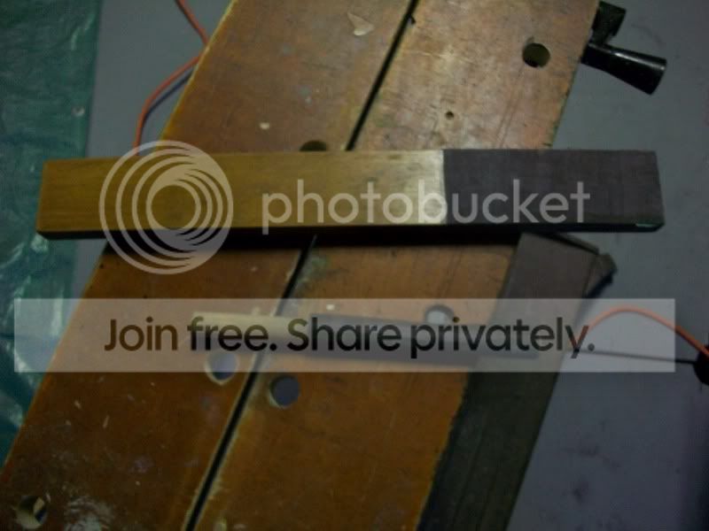

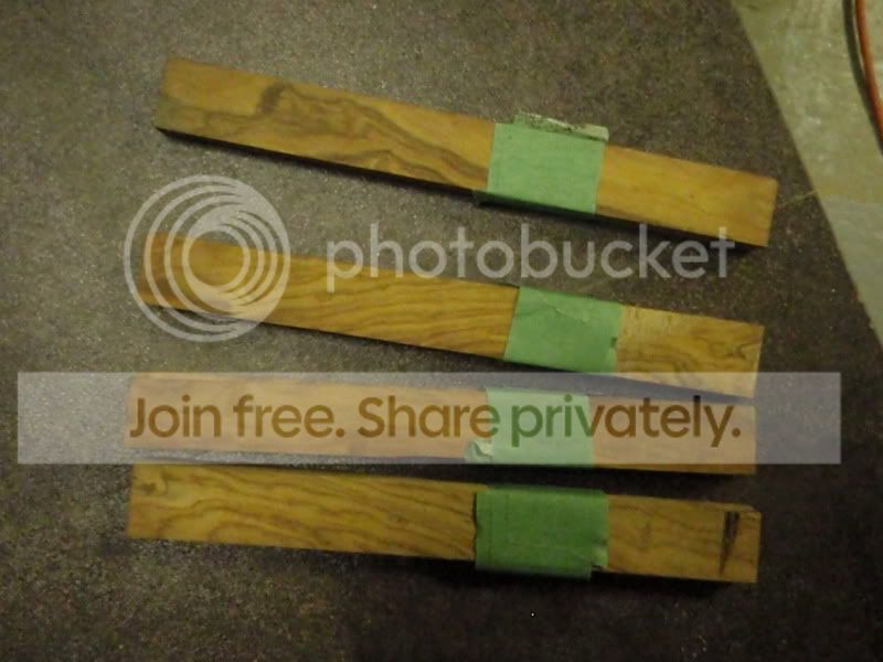

I also got a block of stabilized Wild African Olive... had a very nice grain pattern on the web shot I saw and it was even more stunning in person. Being a woodworker I kind of drool over any sort of burls... can't wait to get these slabs onto the knives.
I cut them up and got matching slabs set up for each of the knives.
Also ordered a brass mosaic tubing and brass tubing for new handle hardware. I think I will like this much better and it will look fantastic!

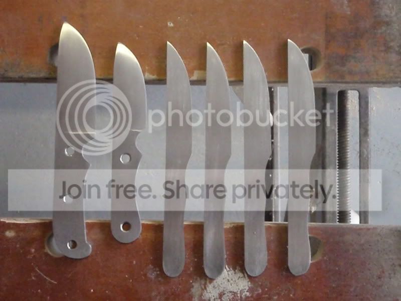

Spent the afternoon grinding out the rest of the steak knives, and hand rubbed them to 220 grit all over.
Here is all 6 of my knives in progress.
And all 4 steak knives rubbed to 220 grit and marked for drilling..
Not a lot to show for 2-3 hours work but its coming along nicely. Was really hard to get all the blanks the same, but they are pretty much all even in length, width, thickness and cutting edge.
I did try and drill the tang holes on the first knife but it chewed up 2 bits... is S30v suppose to be hard to drill (i'm using a drill press also)? Maybe I need to go pick up some carbide bits... odd though since my O1 knives were very easily drilled with the same bits.
